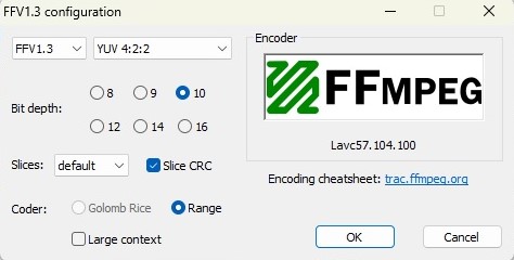

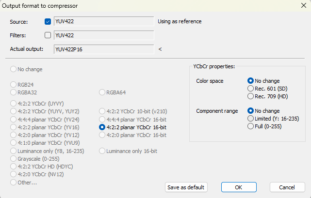

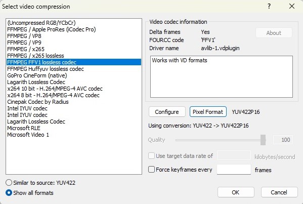

I find this thread slightly alarming as I've worked my through quite a lot of tapes now, all of them captured and archived with lagarith.
Can I just check that these setting are correct before I begin converting them to FFV?
[Attachment 72805 - Click to enlarge]
[Attachment 72806 - Click to enlarge]
[Attachment 72807 - Click to enlarge]
May I ask what GOP=1 is and how do I implement it? -
FFV1 has higher compression mainly because of larger GOP size (temporal compression) . Lagarith is I-frame only, or GOP=1 . If you disable FFV1 temporal compression you lose much of the advantage in terms of compression . Temopral compression makes it more difficult to seek and edit (slower, higher latency) . Vdub2's bundled FFV1 looks like it does not have control over the GOP size
FFV1 is generally not compatible in NLE's , except open source ones (shotcut, kdenlive, etc...)
Lagarith is more compatible in NLE's but YV12, YUY2 variants are not handled as lossless, except open source ones -
In my case Lagarith issue was some strange posterization, false color - video was there, easily recognize shapes and contours but wrong color (it looks like some default VGA palette applied - 256 colors) - had this issue few times with Lagarith proper setup (not only in Windows but also using ffmpeg Lagarith) - to be honest never investigated this and simply switched back to HuffYUV that always work OK for me, for archive i use FFV1 and even with GOP=1 (seem using GOP higher than 1 is anyway not recommended and may be in future not even possible).
FFV1
FFV1 is can be recognized if filter installed - same case as for Lagarith.Supported pixel formats: yuv420p yuva420p yuva422p yuv444p yuva444p yuv440p yuv422p yuv411p yuv410p bgr0 bgra yuv420p16le yuv422p16le yuv444p16le yuv444p9le yuv422p9le yuv420p9le yuv420p10le yuv422p10le yuv444p10le yuv420p12le yuv422p12le yuv444p12le yuva444p16le yuva422p16le yuva420p16le yuva444p10le yuva422p10le yuva420p10le yuva444p9le yuva422p9le yuva420p9le gray16le gray gbrp9le gbrp10le gbrp12le gbrp14le gbrap10le gbrap12le ya8 gray10le gray12le gbrp16le rgb48le gbrap16le rgba64le gray9le yuv420p14le yuv422p14le yuv444p14le yuv440p10le yuv440p12le
