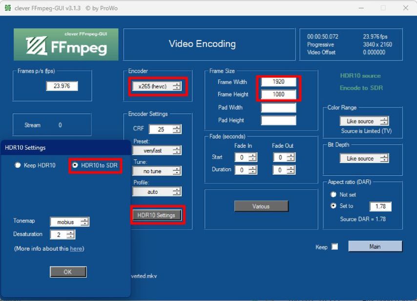

  5. Start clever FFmepg-GUI, load your ripped mkv, click main, click encode videostream, click resize, set h265 as encoder, set your desired resolution, click HDR10 settings, set HDR10 to SDR, click ok, click encode.
    [Attachment 72760 - Click to enlarge]
    Hi Thank you so much for this, it has worked! However it would take 14 hours to encode a full movie, so obviously I need to upgrade my pc to a higher spec whether it is processor or speed power. Just one other thing, I encoded 50% and it produced a file of 610 MB which is far too low, I want to give it far more juice than that. Are there any settings I can use to give it more file size? I still watched it on my 1080p TV and the colours are lush and the detail is absolutely beautiful even at that size, but it is just psychology, I want at least a 4 gig 1080p full movie.

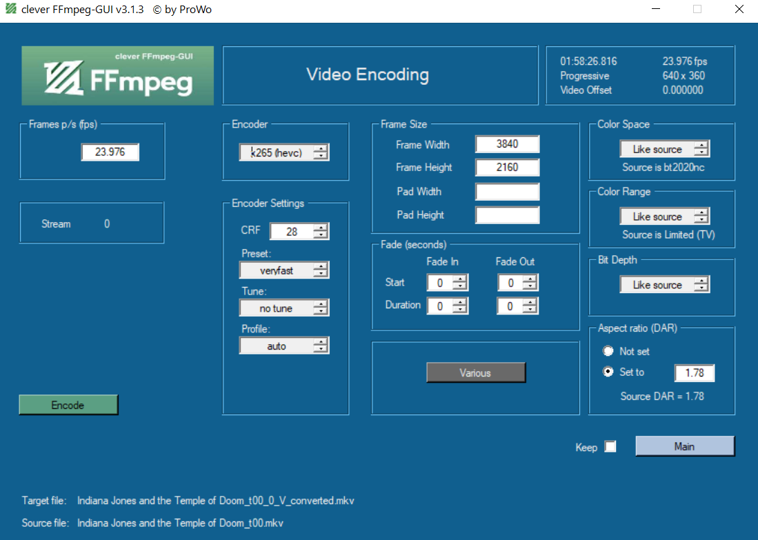

    Thanks all, I think I'm going a little buts here but I have had to reinstall ffmpeg due to buying a new faster computer and the section to conver to sdr button is missing. HDR 10 settings is missing. Anyone advise? Please see capture.

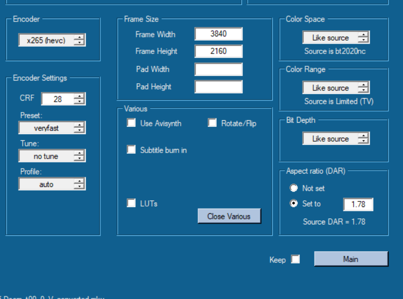

  20. Click on various, there is a HDR checkbox.
    You can now use any videocodec for HDR10 to SDR, not only hevc.

    I have just re-checked even after clicking on various it is still not there. Please help.
  22. Is your source HDR10?
    The checkbox is visible with HDR10 source only.
    Use the newest beta:
    https://files.videohelp.com/u/292773/clever_ffmpeg_gui_newest_beta.zip

    Wow you are right, but it is really strange. I just ripped the movie using makemkv again, this newer ripp doesn't have hdr10 at source, but the previously ripped file did. How can one ripped file have hdr10 but the other one doesn't? That is so weird.

    Can I just ask I haven't really changed any other settings apart from frame size to 1920 x 1080. But on the SDR setting when I set it to SDR10 by default the desaturation setting is set to 2. I haven't really played around with this as I don't have the time or the hours to leave the computer on for 10 hours to encode this video on every setting, but leaving at default settings seems to look perfectly fine with all the colours brought out. Am I doing the right thing, or should I adjust the desaturation setting?
  25. Leave it at 2.
    You could try hable instead of mobius.

    Ok thank you. I have left it at 2 with mobius. I am happy with the results.
