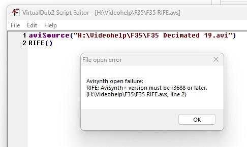

    Jagabo, I'm trying to get RIFE running but have got this failure:
    [Attachment 72788 - Click to enlarge]
    What does the 3668 refer to, because I'm already running A+ 3.7.2 (although I do see 3.7.3 is now been released).
    PDR, one of their late mates, I suspect! They are really "rifeing" along, judging by the first frame in which they appear.
  16. r3668 is the version number
    If you preview a 1 line script
    version()
    It will tell you the version you are using. 3.7.2 is too old
    Geez, you have to be quick; 3.7.3 has only been out for 2 weeks. I'll install it now. It's a bit confusing when there's parallel "versions" and "releases".

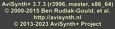

  22. Update to 3.7.3. I have:
    [Attachment 72789 - Click to enlarge]
    Oops, too late.
