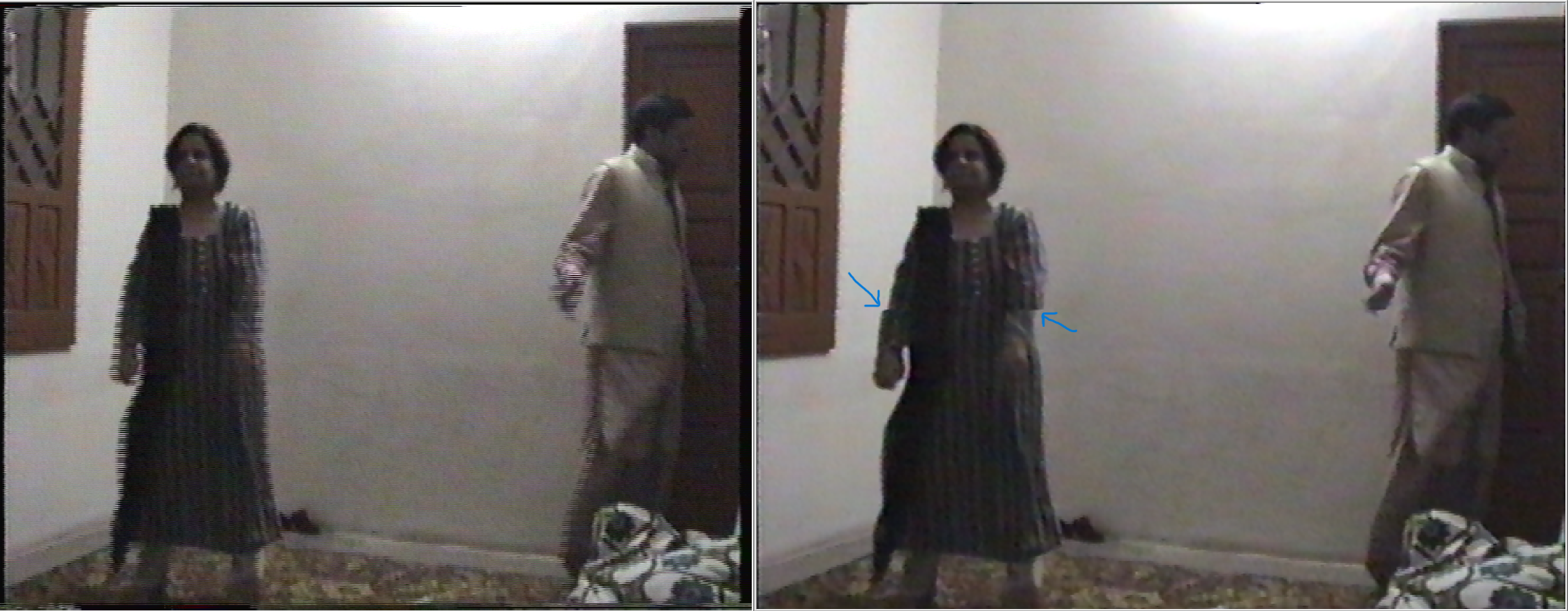

  1. I have captured about 15-16 hours of video footage so far and have converted it to mp4 using virtualDUB and this is the first time i am seeing this issue. As you can see in the picture if i turn on deinterlace on it cuts this section of the video like it is showing it only does this at some portions of the video. I have turned off all other filters MSU, crop, resize and they dont make a difference only the deinterlacer does this. Any ideas? I have also tried diffrent deinterlacing methods yadif, bob and the other one yadif is the best but when ever the camera spans fast this happens. if i load other videos i have captured using the same setting it looks beautiful in virtualdub side by side.

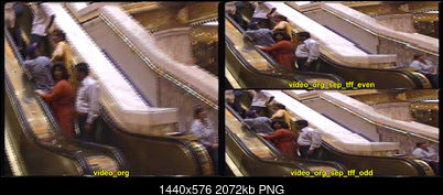

  2. Your capture has some fields that are half of one field and half of another. You can usually verify this by comparing the previous and next fields -- you'll see that one half that field matches one, the other half matches the other. Many capture devices do this on occasion.

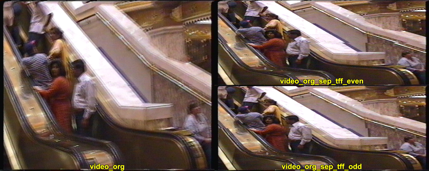

    The fields themselves are bad inside the capture, is not a deinterlacing problem:

  8. I was able to fix the existing video with AviSynth:
    LWLibavVideoSource("Pakistan Camera (20230728-1744).avi")
    top = Crop(0,0,-0,288).AssumeTFF()
    bot = Crop(0,289,-0,-0).AddBorders(0,0,0,1).AssumeTFF() # shift the lower half up by one scan line
    StackVertical(top, bot)
    QTGMC() # or some other deinterlacer
    You still have other severe problems with random frames popping up here and there.
