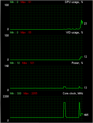

On previous versions, I often saw this parameter being used and as I understand it, it is responsible for hardware video decoding (built-in hardware decoder?). In MSI Afterburnder it's called VID, in AIDA64 it's called video engine. Now I only see it loading in browsers with hardware acceleration enabled. And how does it work in the player now? Will the load on the GPU increase now, if this part of the video card is not used? Because now I see only the loading of the GPU and that's it.
That's how it was before:
[Attachment 72719 - Click to enlarge]

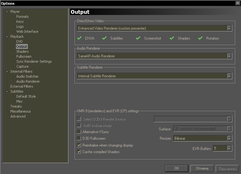

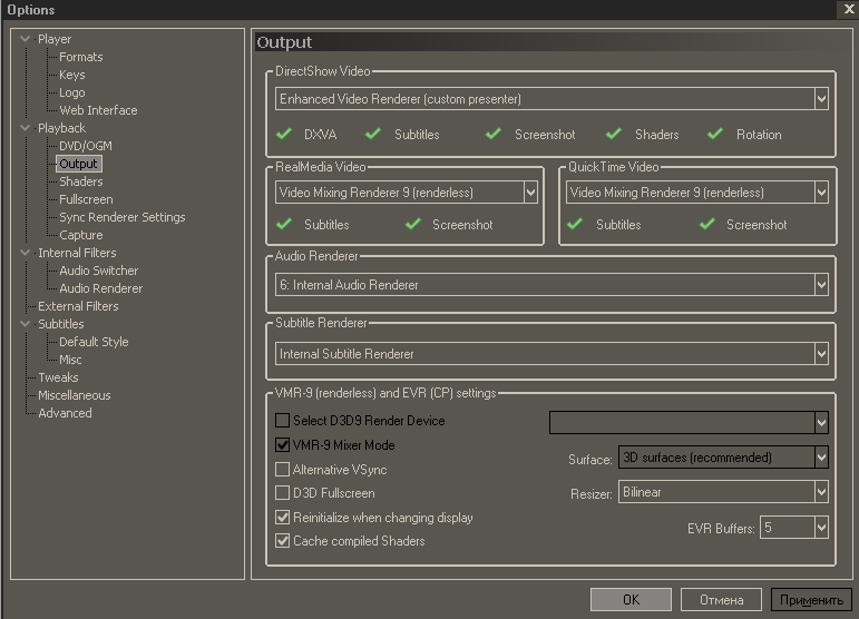

The video output settings have also changed:
From this:
[Attachment 72721 - Click to enlarge]
To this:
[Attachment 72720 - Click to enlarge]
Please explain to me how it works now and what the downsides might be. Thank you!
