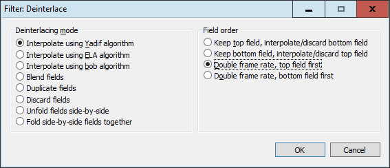

In AviSynth: SeparateFields(), Bob(), Yadif(mode=1), BWDIF(field=2), QTGMC()... Most editors have double rate deinterlacing options. For example, VirtualDub's deinterlace filter has "Double frame rate" options with" top field first" and "bottom field first" options.
