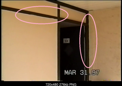

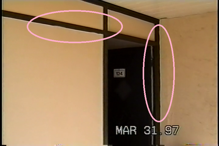

    Not really, with QTGMC you deinterlace, and denoise, and apply other processing.
    If you wish to upscale you should not compress and change colorspace, but rather feed the upscaler with the output of QTGMC, or any other additional filter.
    Sharpening before of after the upscale depends on the source, experiment both.
    Your capture may suffer of having no lineTBC correction and oversharpening halos.

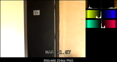

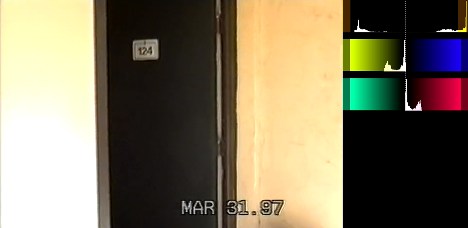

    The levels are ok, but you can reduce a little bit the whites. Also convert to limited 16-235 range if further processing concerning RGB conversion is involved.
    But again, your sample is not the raw capture, better to analyze on it for final statements.

    Deshaker.
    Applied wrong aspect ratio
