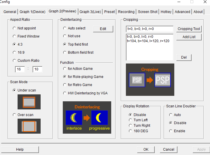

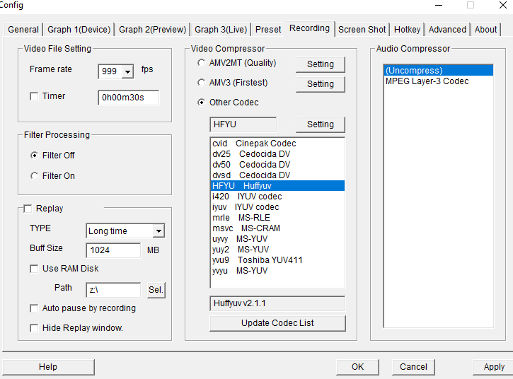

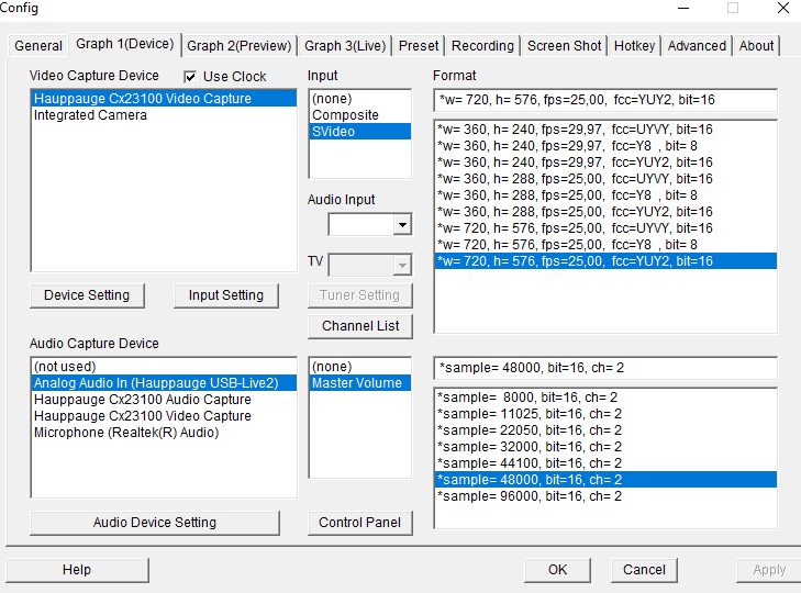

  5. When I view the video on any media player or editing software (Premiere, Vegas), it comes out as 25p.
    Here are the files.

  6. Captures & Restoration lollo's Avatar
    Jul 2018
    Italy
    The file is ok. You can deinterlace it with QTGMC, or set, for example, VLC to deinterlace in real-time while watching (Yadif (2x))
