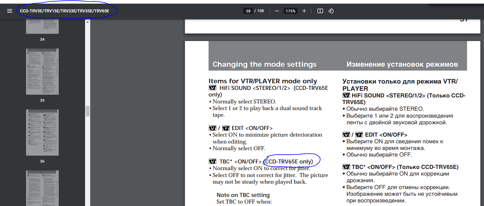

  1. Originally Posted by Alwyn View Post
    Originally Posted by Grassyslide
    but in order for the TBC to work while capturing, do i need to adjust something in the camcorder or does it work automatically?
    I'm pretty sure the TBC only works during playback but I stand to be corrected. Hop into the settings to make sure it is on.
    I can't find both in the settings, i actually went back and looked at the manual and i see that this manual is for a few models - CCD-TRV3E/TRV15E/TRV23E/TRV35E/TRV65E. Not just the TRV23E. And in the TBC section it says "TRV65E only". I can't tell if they mean it's only the option to turn it on/off, or the existence/absence of TBC.
    [Attachment 72690 - Click to enlarge]
    May 2005
    PAL User
    Ok, I stand corrected. That doesn't change anything at the moment: you still need to replace that Ezcap box.
    If the camera plays tapes OK in the viewfinder and directly onto the TV, it will be OK to capture from. The only unknown will be if it is stable enough or if you will need a stabiliser (camcorder with TBC or a ES-10/15). But that can come later.

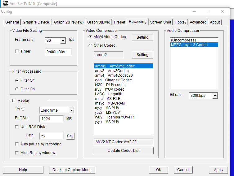

    Guys, i just got the GV-USB2 and i managed to get it to work with Amarec.
    The issue is, i can capture the video with AMV4/LAGS codecs which are apparently not common formats and the main point of the capturing i'm doing is to be able to watch it anywhere with friends and family(TV, PC, etc). What do i need to do in order to make it use a more common codec?
  13. Captures & Restoration lollo's Avatar
    Jul 2018
    Italy
    Use AmarecTV 3.10 with original HuffYUV 2.1.1 codec

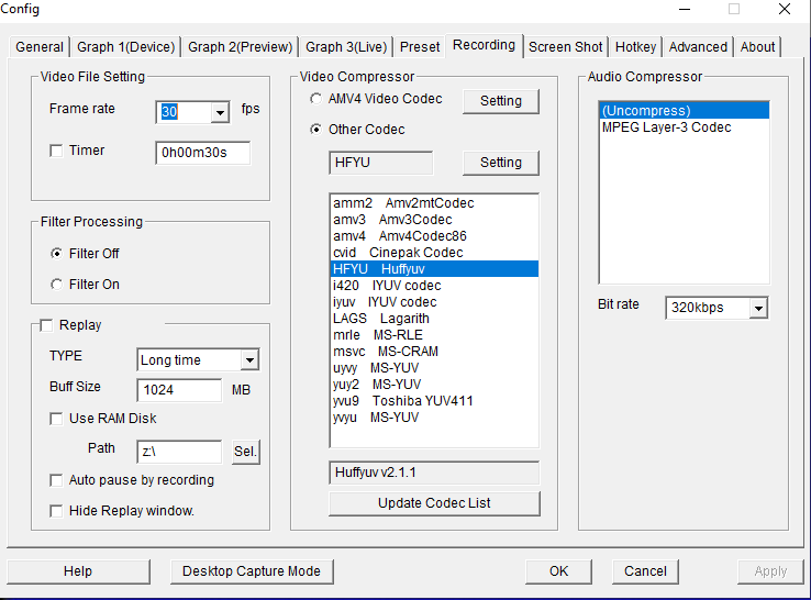

  14. Originally Posted by lollo View Post
    That's the version i'm using, but it seems like i'm missing HuffYUV? i even downloaded it and installed it seprately.
    [Attachment 72817 - Click to enlarge]
  15. Ok i managed to install it but i still can't play the captured video, please help
    [Attachment 72818 - Click to enlarge]
  16. Captures & Restoration lollo's Avatar
    Jul 2018
    Italy
    VLC player or VirtualDub do not show the capture video?
    In frame rate write 999
