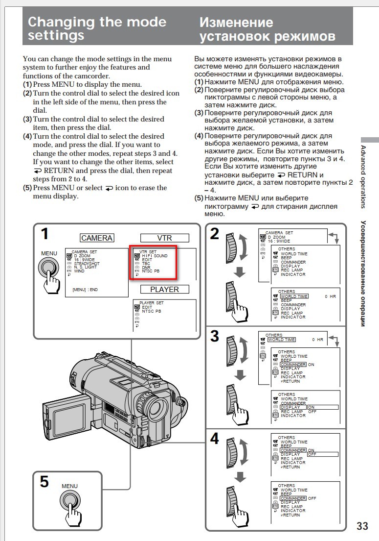

That camcorder is a higher-end machine as it looks like it's got a TBC and DNR. Unless the heads are dirty, I don't think that is your problem.i get what you're saying about the quality, the thing is - the quality played directly from my camera actually looks alright, only when i record it with the EZcap it gets super pixelated and the FPS drops by like 40%.
I also don't think that that Ezcap is necessarily your problem either. It's a higher-end gadget, not a cheap knock-off, and should perform OK. I suggest you get into the settings and look for a better capture quality setting.
My SVHS 5800 is no better than my normal VCRs. At this late stage of their lives, anything is possible with VCR quality.Originally Posted by LolloLast edited by Alwyn; 26th Jul 2023 at 03:08.
Are you sure it has TBC? i can't find it in the specifications(the manual in their website is all i have), maybe i don't know where to look.

Thanks, that's good to know! Sorry for the newbie question, but in order for the TBC to work while capturing, do i need to adjust something in the camcorder or does it work automatically?

I'm pretty sure the TBC only works during playback but I stand to be corrected. Hop into the settings to make sure it is on.Originally Posted by Grassyslide
I'm not sure about the DNR; try playing a tape with it Off, then On, see if there's any improvement.

Depending on the stability of your signal, you may need an external stabiliser such as a [cheap] Panasonic ES-10 or ES-15, but the TBC in your camera should put out a nice stable picture so hopefully, all you'll need is a new digitiser.
