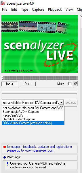

I used to transfer my Mini-DV with any of my 3 cameras and my Firewire PCI card and Scenalyzerlive software. But since I installed OBS to be able to transfer VHS tapes via my Blackmagic Intensity Pro HD card, Scenalyzer no longer recognizes my mini-dv cameras and it seems that OBS and the Blackmagic card are messing with it.
Screenshot of Scenalyzer devices tab attachment.
I tried uninstalling the OBS and Blackmagic software which caused them to no longer show up in the devices tab of the Scenalyzer, but it still doesn't recognize my cameras. I also tried to put another PCI Firewire card without success.
thank you very much for reading and helping me
[Attachment 72629 - Click to enlarge]

Interesting. I have OBS installed and use it occasionally; good for HQ MP4 captures
. My Scenalyzer still works fine, so I doubt that OBS is messing yours up. I'd put money on the Black Magic gear. The trick is how to completely wipe your machine of any traces of it.
On a related issue, if any of your MiniDVs have a Mini B USB port, have a read of my website here regarding DV over USB (scroll down a bit). If you could achieve that, it might bypass the BM Firewire hiccup that is upsetting Scenalyzer. You still "transfer" with Scenalyzer though. -
After several attempts to solve the problem I got tired and went for another insurance to get out of trouble. I created a new partition on my hard drive, installed windows 10 there and the Scenalyzer, but I kept my Blackmagic PCI-E Intensity Pro HD board disconnected in case some driver annoyed me the Firewire board or the Scenalyzer. It works perfectly as before. I get out of trouble but then I will have to see what I do with my real Windows OS partition.
