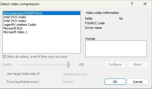

  3. Ive just tried to install HUFFYUV using the same command as you did. I didnt get any error or fail message come up so I thought that it had installed, but when I look in the compression list in vdub, its not there.
    [Attachment 72815 - Click to enlarge]
    I dont recall seeing anything but lagarith there before, I might be wrong though.
    I dont suppose you have any ideas?

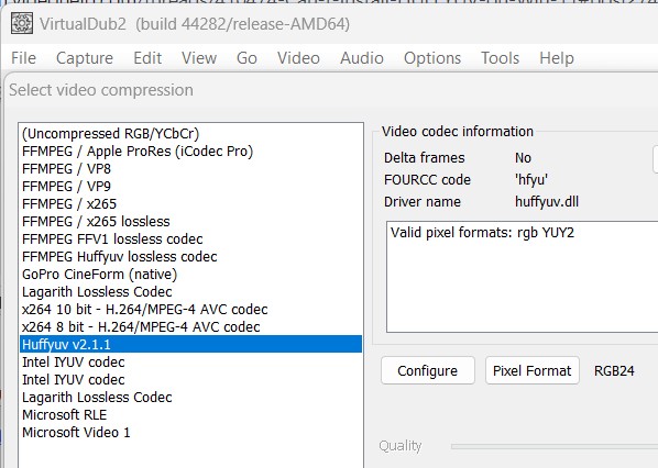

    I think you're using VDub 1? there; in my VDub 1.9.11 (32bit), I have a "HUFFyuv v2.1.1 -CCESP Patch v0.2.2", which must have come from the install I did;
    In VDub 2 64bit I have (I only use [used to] 1.9.11 for capture, all my other VDub activities are with 2/64bit [or 32 if I need a filter]):
    -"FFMPEG HUFFyuv" (that's an internal version I think)
    and
    -"HUFFyuv 2.1.1" which is the external one I installed (noting of ocurse that it didn't work for me! )

  5. Yes its vdub1. I do actually have HUFFYUV installed on vdub2, I think it came bundled with it, but I dont use 2 for capture as Ive read that its not good for it.
    I was going to try using HUFFYUV for capture but I think getting it installed is going to be beyond my very limited IT skills.
    Ive tried a couple of different procedures now with no luck, I didnt think to try a restart though, Ill give that a try now. Ill have a read up on the ut codec, I havent heard about that. Thanks

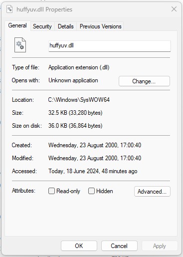

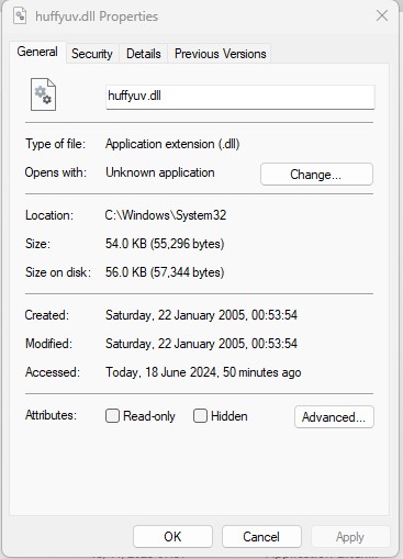

    My HUFFYUV.DLLs are:
    In System32:
    [Attachment 79967 - Click to enlarge]
    In SysWOW64:
    [Attachment 79968 - Click to enlarge]

    >> If HUFFYUV 211 is in there, it's installed correctly.
    Great! I was looking for an x64 video app that listed recognized codecs.

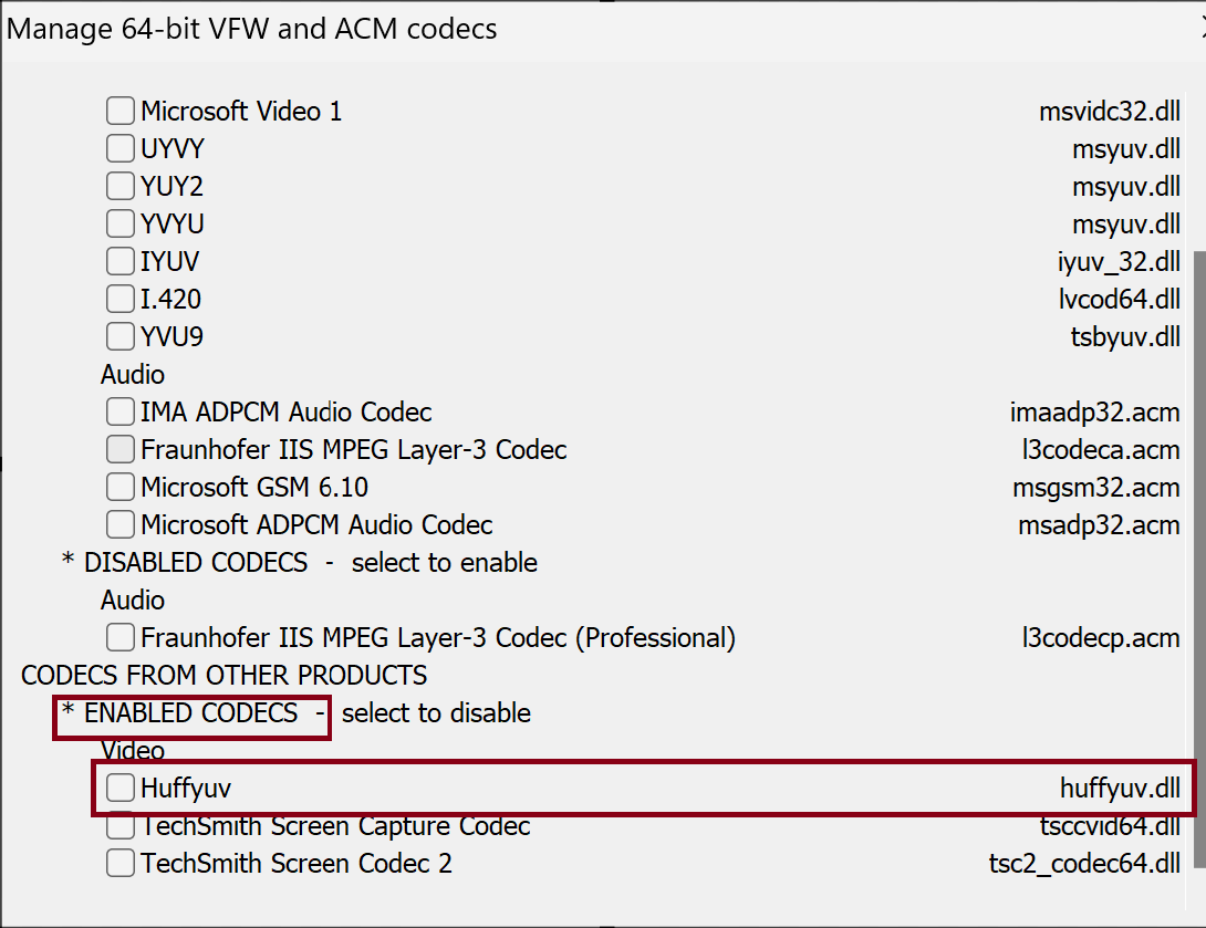

    Even though HUFFYUV.DLL was added to System32 folder by install and confirmed by e.g. Codec Tweak Tool

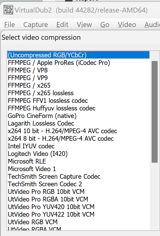

    [Attachment 80026 - Click to enlarge]
    Confirmed: "HUFFYUV 211" is not listed (Virtualdub64.exe)
    [Attachment 80025 - Click to enlarge]

    3) It's working for you, however, I note the Properties timestamps in your screenshots for the .dll files: I suspect you installed the codecs running older versions of Windows and then upgraded to W10 and then W11? I had no problems with HuffyUV x64 codec and previous versions of Windows.
    No. Brand new pristine W11. I just ran the 64bit install on another pristine W11 computer; same:
    [Attachment 80042 - Click to enlarge]

    Try this. It's basically Hofmand's process in more detail.
    In System32:
    In SysWOW64:
    I needed to do the following in order to install Huffyuv on my windows 11 installation:
    Delete HUFFYUV.INF in C:\Windows\INF if existing
    Delete HUFFYUV.DLL in C:\Windows\System32 if existing
    Delete HUFFYUV.DLL in C:\Windows\SysWOW64 if existing
    In a administrator command window (i.e. CMD), run HuffYUV_x86_v2_1_1.msi and HuffYUV_x64_v2_1_1.msi
