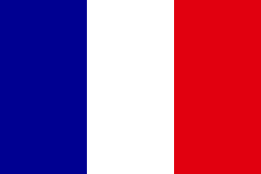

  1. Take the French flag for example. If you had a video of that, would it be possible to cut out the white middle section leaving just the blue and red with nothing in between? I've googled phrases such as 'avisynth trim from centre' with no luck so I'm quite prepared for the answer to be 'No'. In which case, could two videos - a cropped blue stripe and a cropped red stripe - be made into one by some form of overlaying (sounds even more unlikely now that I see it in print but, you know, stranger things...)?
    Thanks.

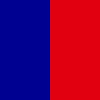

  2. Crop to the left section, crop to the right section, Stick them together by using StackHorizontal(left, right)
  3. Here is a concrete example
    From
    https://en.wikipedia.org/wiki/File:Flag_of_France_(2020%E2%80%93present).svg
    orig=ImageSource("Flag_of_France_(2020–present).svg.png")
    left=orig.crop(0,0,-342,0,true)
    right=orig.crop(342,0,0,0,true)
    stackhorizontal(left,right)
    (This is overcropped slightly, it's because of the way the wikipeida graphic was made. The "blue" side was done incorrectly, there pixels are not a 1px pixel perfect edge)
