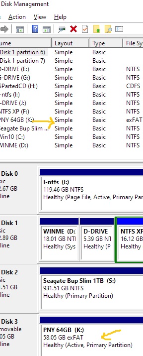

    Take a look at disk management (diskmgmt.msc from the Run box) and see what it says about the partition/drive

    Disk management shows it but I cannot format via disk management

    I thought you were trying to restore the data? If you format it you potentially make things harder for yourself.
    Does disk management show a partition type or does it say raw?
    Testdisk may help, it can restore the MBR including the partition table once it finds the data and verifies the start and end addresses
