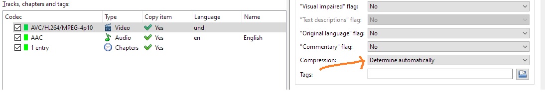

    Have you tried the options in general/compression to see if it affects your plaback??
    eg. no extra compression.
    Start with a working file, make your changes and use the above option

    was getting excited thinking this might work, but no luck, tried all option under compression. will have another look tomorrow! will update if i find a solution

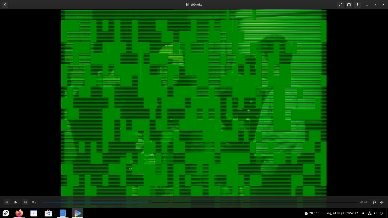

    Originally Posted by robbie1407 View Post
    gtx1060, possibly does need updating. does it play ok for you?
    Using the same card with Linux (Fedora) with hardware decoding on in VLC, no issues with playback, no problems with MPV, only player that has trouble playing it is the default gnome player, hope it helps in someway.
    [Attachment 72632 - Click to enlarge]
    I love it when a plan comes together!

    jellyfin on firestick uses libVLC or Exoplayer, both will not play it. my lg oled tv (which is away for repair at the moment plays it no bother on jellyfin webos).
    yeah the screenshot is exactly what i get with hardware acceleration on in vlc windows 11 and on jellyfin firestick. need to work out away to get the mkv into version 2 to test.
