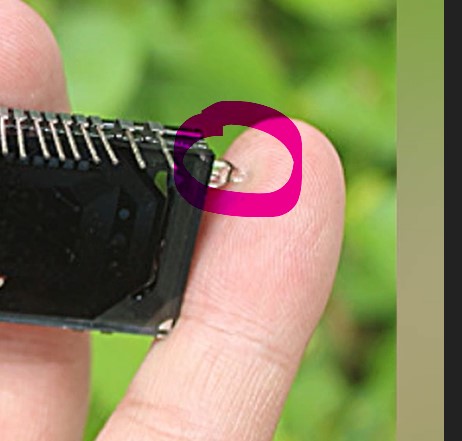

Recently, I purchased this machine. It is a Japanese machine in NTSC standard.
It had a fluorescent display marked as "NEC FIP13BMW6". Part number, according to manual, is 1-519-507-31.
The display is dead.
It has a side glass dint which is broken.
[Attachment 72569 - Click to enlarge]

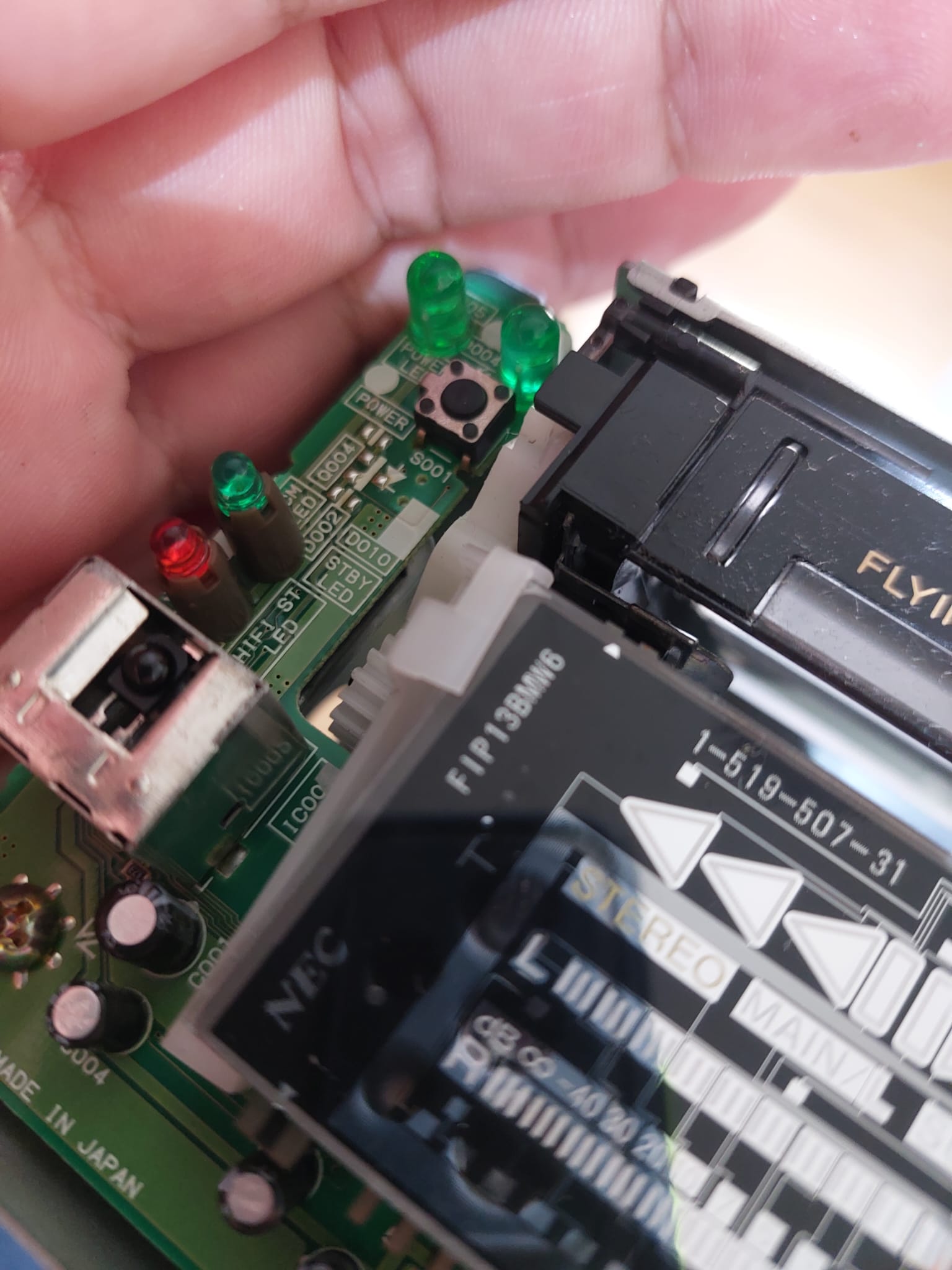

This is the display. Same display is used in Sony EV-S1000E, and likely in other machines.
[Attachment 72570 - Click to enlarge]
Do you have any idea where can i find this display?

The only solution I know of is to find an identical unit that is being sold for parts. Buy that, remove its display, and plug that in.
I am currently also looking for a VFD (Vacuum Fluorescent Display) replacement for an old clock radio. Unlike discrete 7-segment LED displays and other similar, but simpler displays, these VFDs were all custom units, with no ability to replace with a generic unit. I have looked and have not found any source for such displays.

Clips posted by themaster1 are very instructive in debugging electrical problems. In my case, the machine works well, electrically and mechanically, only problem is that the display itself is physically broken. From my understanding, there is no vacuum in the display, something that prevents it from working. I don't know if that dint was mechanically broken by someone or if something else was the cause of its breaking.

However, as I said in my last post, the real problem is that this technology was (and I guess still is) used to create customized displays, so almost no two are alike and spare parts are non-existent.
