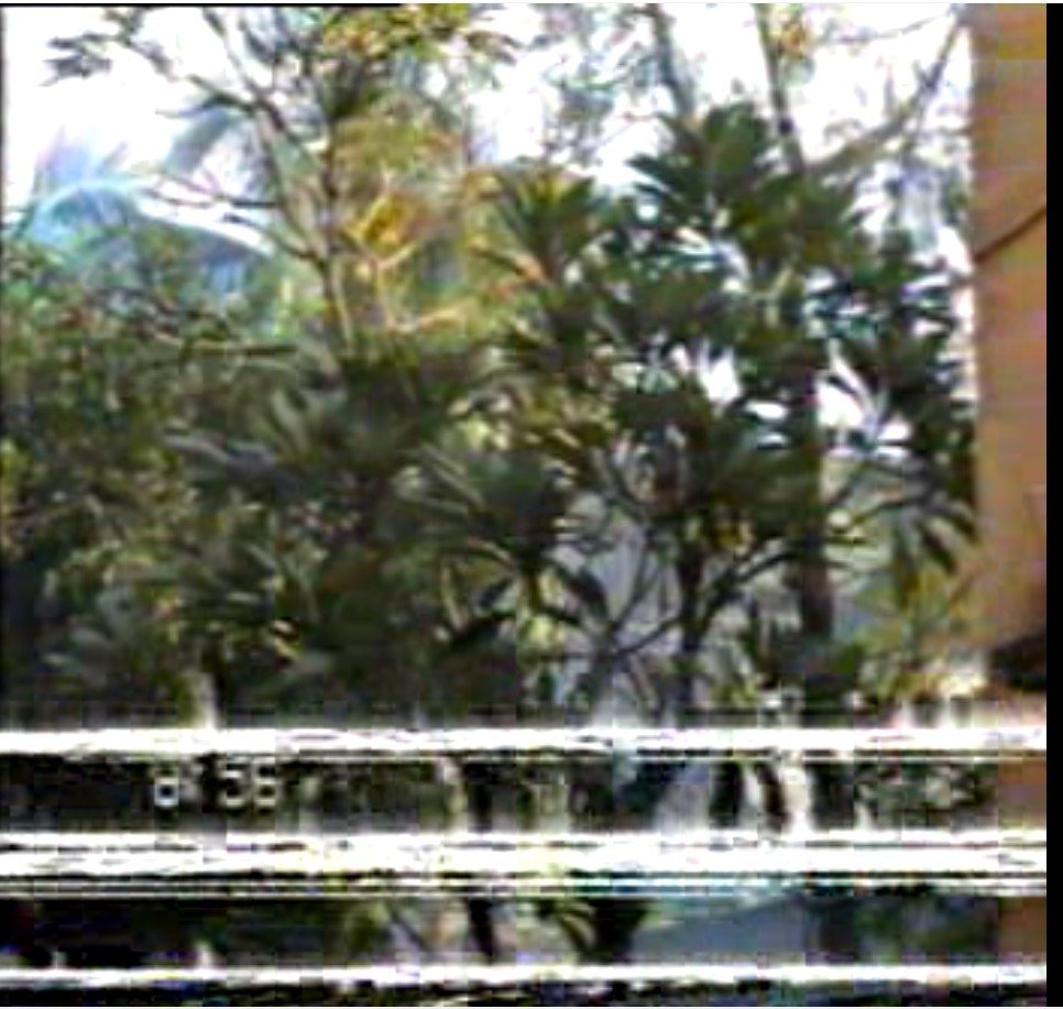

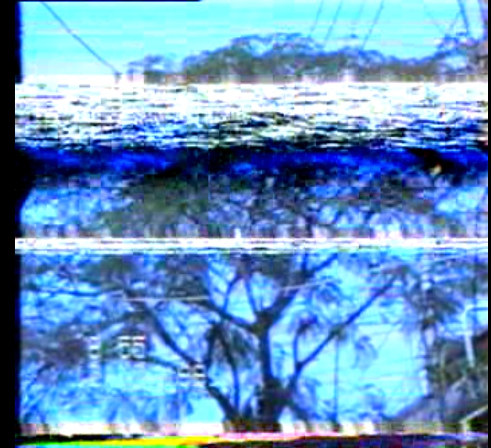

    I am also uploading some images of the random white lines I am talking about just for further clarification.
    [Attachment 72563 - Click to enlarge]
    [Attachment 72564 - Click to enlarge]
    P.S. Also in these images you will see some distortions of color and the video as a whole, if possible please do comment on them too.

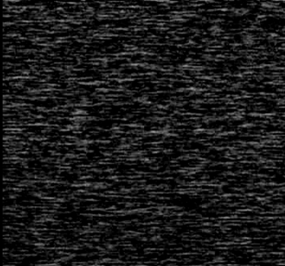

    [Attachment 72573 - Click to enlarge]
    I'd suggest you do a more in-depth "I did not deeply checked".
    BTW, I have assumed it's 4:3. The heads look too stretched to be 1.056 and 352x288 just happens to be half 704x576... More than a coincidence, methinks.
    And when you have published your comprehensive AVISynth 101, I'll proofread it for you. AKA read post #17.
