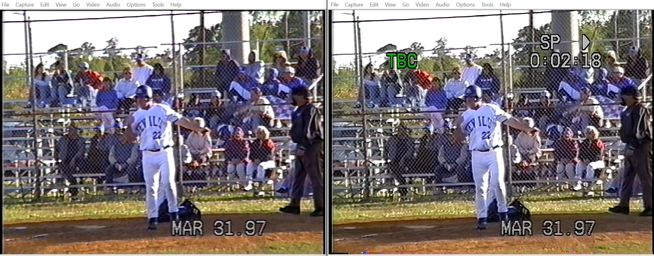

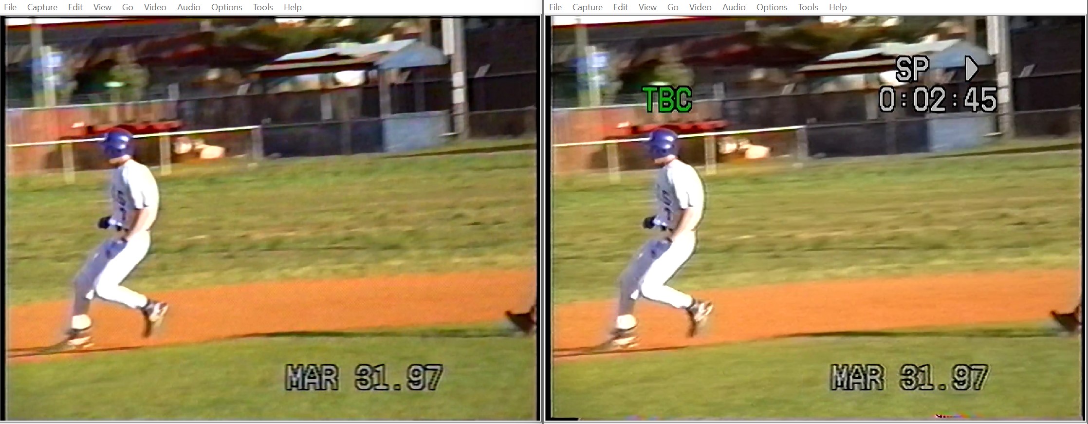

  1. I gotta say I am quite confused as to the hate that camcorders get for capturing projects. Hear me out.
    So I bought the JVC SVHS-C GR-SXM260U camcorder about a month ago to transfer my VHS-C home family video tapes. I’ve done research on these forums after I made the purchase and I realized that perhaps I didn’t make a great choice by purchasing this JVC camcorder with a built in TBC because they are not built to par like other VCR with TBCs or even a decent non TBC VCR in combination with the Panasonic DMR-ES10/15 as passthrough device. After transferring a few tapes using the camcorder (which btw I thought they were pretty decent stable transfers), I got tired of watching my transfers with the stupid time stamp and “TBC” marker that the camcorder has and I have no way of disabling it on playback (because of some manufacturer ridiculous choice) **, so I decided to purchase an affordable decent Panasonic DMR-ES15 and a Panasonic PV-S4670 SVHS VCR from 1996. I made such choice because I don’t have money growing on trees to spend $700+ on a VCR. I have about 75 tapes to capture and they’re all VHS-C’s, some recorded SP and some EP.
    Now what is really interesting is this. The latest S4670->ES15 transfers works great. I have stable tracking and decent picture quality. However, here is the kicker. Why is it that my camcorder capture picture quality looks a tad better; the image looks sharper and the colors richer? I’m starting to think that camcorder captures may be underrated. Thoughts?
    PV-S4670->DMR-ES15 on the left and GR-SXM260U on the right
    [Attachment 72502 - Click to enlarge]
    [Attachment 72503 - Click to enlarge]
    **Edit Notes: Big thanks to dellsam34 and other folks on this thread for helping me disable the indicators of the camcorder that were shown on output during playback.

    It could be that your camcorder has better processing than the ES15. It's odd that you can't turn off the TBC display, Have you tried to turn off the OSC in the menu? Check page 21 of the manual.
  3. Originally Posted by dellsam34 View Post
    I've tried all the possible menu functions. If someone can find a way I will be a happy camper.

    Even with OSD out set to OFF you still get TBC displayed? Note there is options for internal LCD display and options for OSD out.
  5. Originally Posted by lovethisnation View Post
    Such things are easily compensated for with proc amp adjustments before capture. or in software after capture.
    Tough to tell from these processed screenshots. To my eyes, you've turned them both into cartoons. But to each their own, if that's your preference.

  8. Originally Posted by jagabo View Post
    How to proc amp adjustment before capture? After capture I did the same adjustment to both and the result is what you seen in the photo capture.

  13. sample videos
    capture 1- GR-SXM260U ->GVUSB2 --LAGS YUY2
    capture 2 - PV-S4670->DMR-ES15->GVUSB2 --LAGS YUY2

    I’m interested though in what people think about the video sample. Which sample looks better in your opinion?
    The TBC of the ES-15 may be better or not compared to the Camcorder in term of video quality. Generally is better for image stabilization, worst for picture quality. YMMV.
    The 2 captures are very very close.
    https://imgsli.com/MTkyNjg0
    I prefere the GR-SXM260U, better definition on the grass and less blur on the player, but it's very marginal and more a speculation than a fact.
    The GR captures shows 1 dropped frame between frame 227 and frame 228.
    In term of stabilization I do not see major differences.
    Dfferences in term of black borders on the top and head switching noise at the bottom between the 2 captures.

  21. Originally Posted by lollo View Post
    Is there a reason why your captures are RGB 24-bits?
    Thank you. I have the same opinion as you that the GR-SXM260U has a slight edge here.
