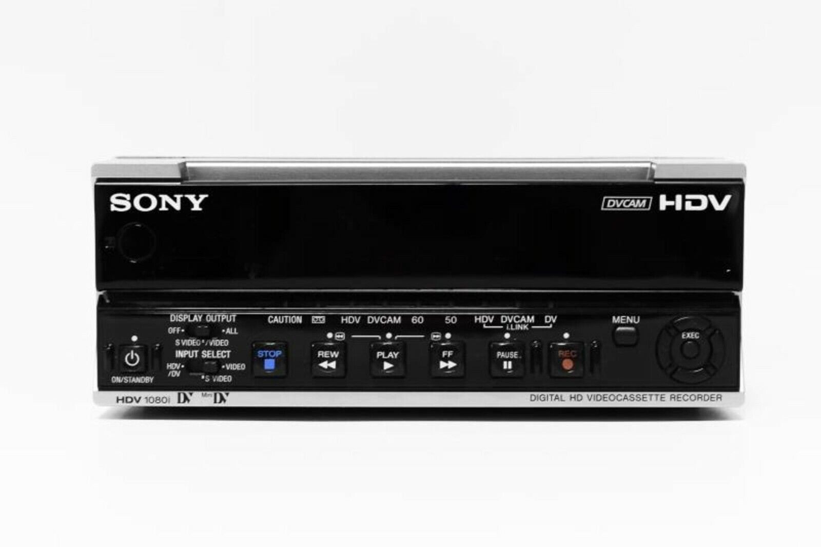

    Front:
    [Attachment 72470 - Click to enlarge]

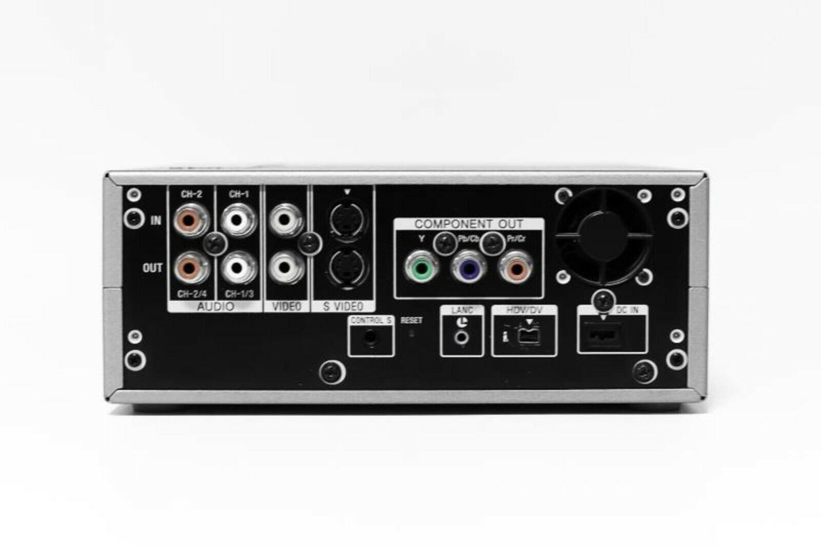

    Back:
    [Attachment 72471 - Click to enlarge]
    Judging by the ebay prices, that must be some piece of kit.
    I'll have a stab and suggest:
    -Connect it to your PC with a Firewire cable
    -Connect your VCR using the red+white (for audio) and S-Video (if your VCR has it) otherwise Yellow Composite video to the IN sockets.
    - On the front, put the Input Select on "Video" unless you have connected your VCR with S-video, in which case select "S-Video".
    - On the front, select Display Output to OFF.
    -HDV and DV require different capture programs. Try setting DV first; I can't see a switch for that on the panel, so I think it must be in the Menu (button) somewhere. Manual on the 'net somewhere? Here you go: 80 pages. Go for it!

    Whether it will actually pass-through a VCR signal remains to be seen.

    I have the multi system unit, HVR-M15AU with 6 pin firewire but I haven't used it for such task, mainly transferring DV, DVCAM and HDV mini and full size cassettes for both PAL and NTSC, You can use it for VHS as passthrough like any miniDV camcorder, The quality will be limited to lossy DV though, Just follow the manual instructions. You will be better off with using component out and use a component capture device.

    There are few FPGA capture devices but are expensive and hard to find, But Black Magic has few component capture devices internal and external ones, The famous one being the Intensity Shuttle USB3 or thunderbolt depends on your OS. Not sure how the HVR-M15E handles VHS signal from a low budget VCR in case that's all what you have.
