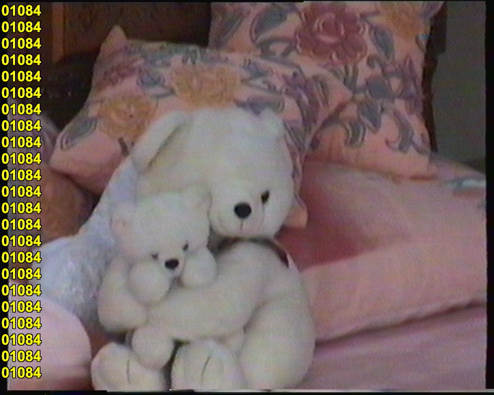

    MrKool, that looks pretty good to me. I did spot a "jump" at frame 542 to 543 (teddy bear pan) and 712 to 713 (bed head). The movement is a bit more than the movement either side.

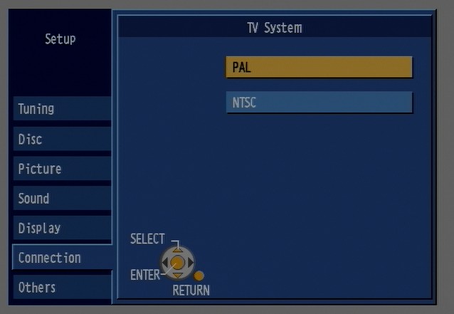

    I would spend the money and get the DVD recorder but it is NTSC only and I got PAL video

    My Aussie ES15 is selectable PAL<>NTSC. Maybe the USA ones are only NTSC.

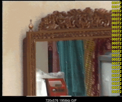

    So I see 18 dropped frames out of 1097 is that true or am I reading it wrong?
    It is true, and poisonedathray already gave you the right indications.
    In the log file you have the exact position of where the frames have been dropped.
    VT=  3084(  77f), Cap= 4564f(550D), Enc= 3.705ms, Siz= 303KB( 37%)KEY, Drp=0, (+)0, (-)0, o
    NT=  3084(Drop), Total=1
    VT=  3160(  78f), Cap= 4566f(550D), Enc= 3.732ms, Siz= 305KB( 37%)KEY, Drp=0, (+)0, (-)1, o
    The first drop appears between frame 77 and 78.

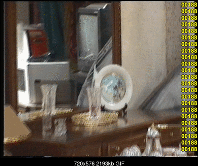

    VT=  7727( 192f), Cap= 4680f(550D), Enc= 3.779ms, Siz= 323KB( 39%)KEY, Drp=0, (+)0, (-)1, o
    NT=  7727(Drop), Total=2
    VT=  7800( 193f), Cap= 4682f(550D), Enc= 3.918ms, Siz= 321KB( 39%)KEY, Drp=0, (+)0, (-)2, o
    The second drop appears between frame 192 and 193. And so on.
