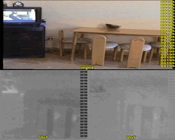

For OP, display of the problem discovered by master poisondeathray (U and V channels do not "move" as Y channel):
[Attachment 72526 - Click to enlarge]

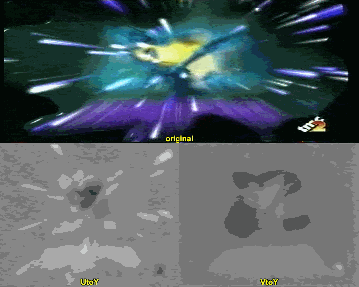

edit: for a proper interlaced material the capture should be:
[Attachment 72527 - Click to enlarge]Last edited by lollo; 18th Jul 2023 at 13:04.

You're missing samples over time from the U,V channels (the color information channels) in your 2 AVI videos - They only have 1/2 the color samples over time . Instead of 50 samples / second, there are 25 samples /sec consisting of duplicates to make up "fake" 50 samples/sec . Since the greyscale information has 50 real samples/sec, this causes a misaligment of color during motion - a sort of color flicker
It's not clear what is the underlying cause of the problem - it could be on specific tapes (recorded like that), or maybe some issue with a specific camera, or maybe some issue with the capture setup or process . You'd have to systematically do some tests to figure it out -

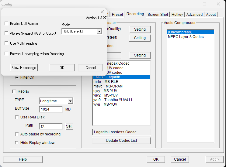

so if i go to the options of Lagarith i get the following screen and in the Mode it says RGBA, RGB, YUY2, YV12 does it matter which one i choose? -
No; lagarith is a special case in that it uses what pixel type is fed into the encoder when you use RGB(default) . e.g. If YUY2 data is sent, lagarith will use YUY2 even if you have RGB(default) selected .
This is not the cause for the U,V channel defect. Even if there was a pixel type conversion issue (e.g. maybe it converts to RGB in a progressive vs. interlaced manner), there would be other types of artifacts - not the ones you are seeing here -

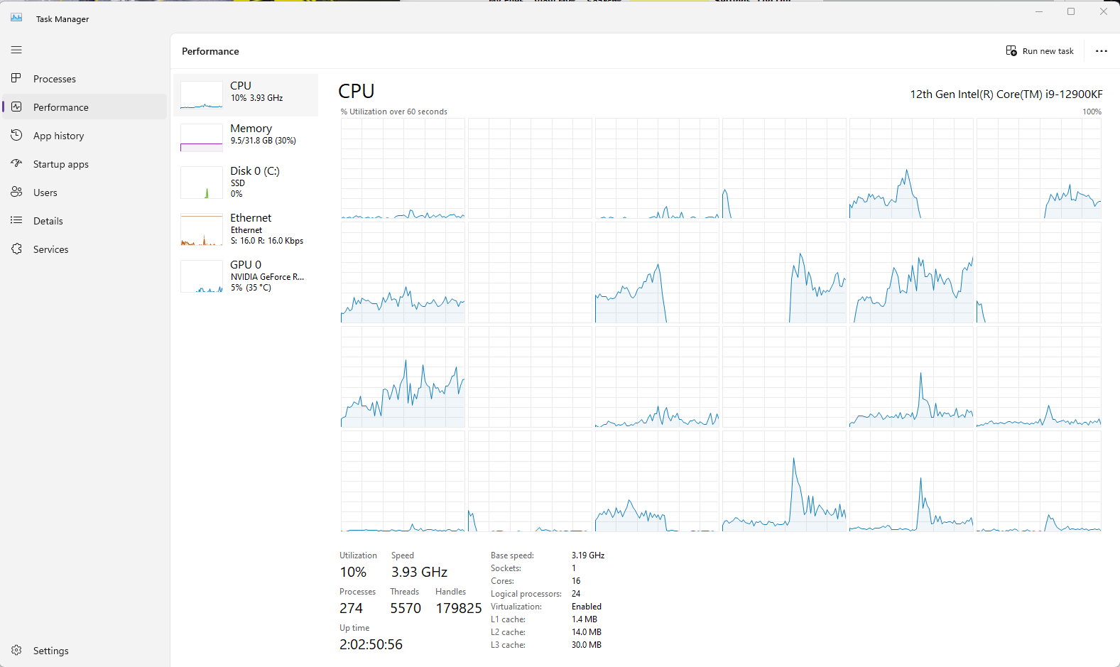

I don't think my computer is the issue i have a Aleinware R13 with 3090 GPU and 24 Core i9 Processor, NVME 1TB HD with read and write speed in access of 2500 MB/s i can run all games at Full resolution and settings at Ultra on a 4k monitor without any issues
here is the task manager with Amarectv running
[Attachment 72544 - Click to enlarge]
Also as i said Dazzle drops frames even if i am not capturing anything which is kinda odd. May be it is a windows 11 issue? i heard they butchered capturing in windows 11 -

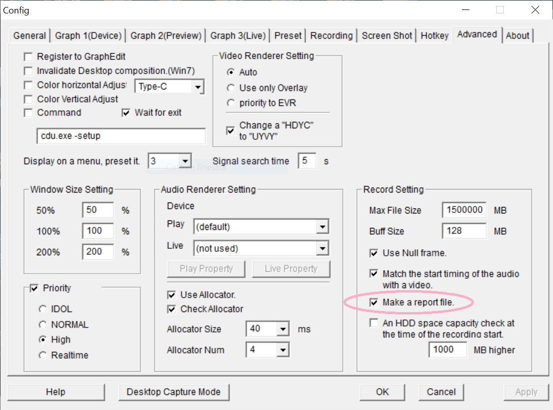

As Sharc said, the Dazzle capture apparently does not have the 25 field chroma problem (I did not check everywhere), but is affected by inserted frames and probably by dropped frames. Check the log of the capture
[Attachment 72552 - Click to enlarge]
to see where the inserted/dropped frames occur, eventually capture once more to see if they are exactely at the same time, meaning a tape problem, or not. -
