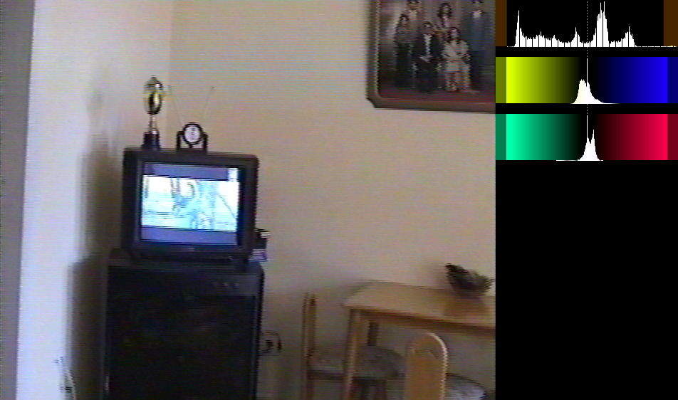

    As Sharc said, the quality flow is to start from best possible capture, meaning high end player and one of the recommended capture cards.
    Your capture shows gaps in the histograms, if not wanted (i.e. tuning the procamp), check the capture settings.
    In post processing you can improve a little bit the quality, as showed by Sharc and Alwin. Here my quick AviSynth attempt with QTGMC/TemporalDegrain2, and a comparison with the VirtualDub Yadiff/TemporalSmoother; not for competition, but just to show alternatives.

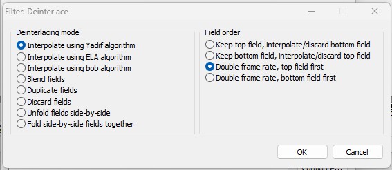

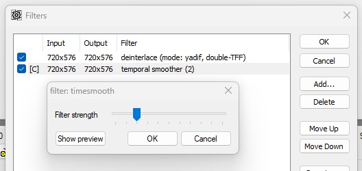

    If you are familar with Virtual Dub, these are the filters I used in Virtual Dub 2 64-bit:
    Deinterlace:
    [Attachment 72516 - Click to enlarge]
    Temporal Denoise:
    [Attachment 72517 - Click to enlarge]
    If you're not familiar with VDub, I'm writing a beginner's tute and should have it ready tomorrow.
