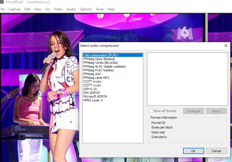

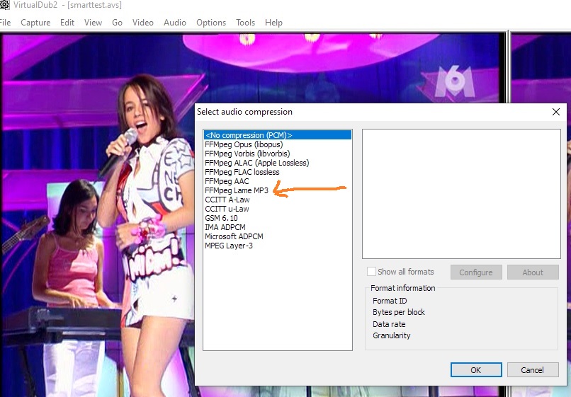

    It is? I get these FFmpeg options, including Lame mp3:
    canada
    You have lame installed,i dont.
    Mar 2008
    Lame installed? It could be, but I don't know where it's picking it up from.
    I don't see anything in the system or user PATH; I do see lame.ax in Windows\system32, which I believe is a dirtectshow codec,
    but there isn't simlar in windows\syswow64, and I see the entry in both 32 and 64 versions of Vdub2.
    I do not see it at all in the original vdub.
    I do have LAV filters installed, but if it was from there wouldn't it show up in the original vdub also?

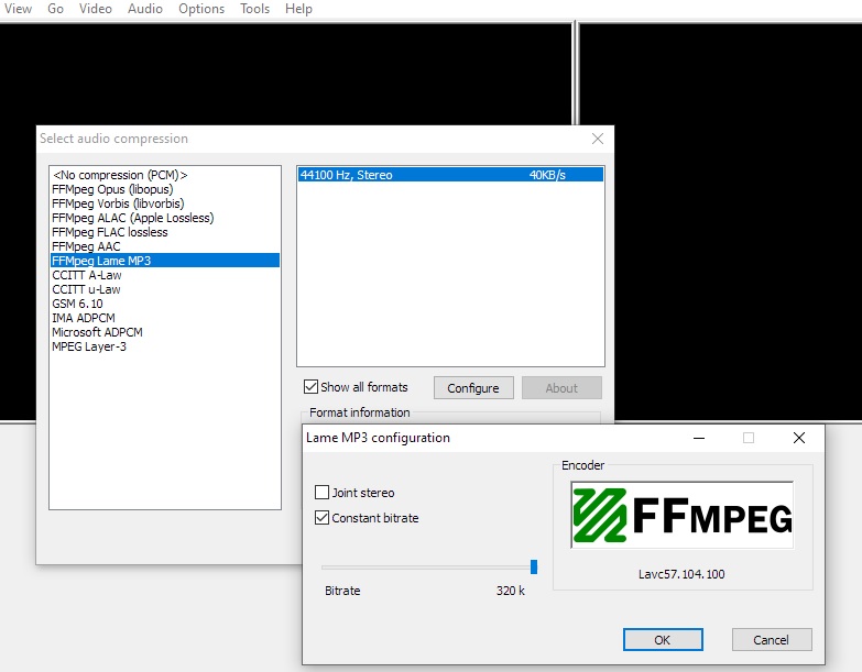

    The OP's image above shows the availability of the FFmpeg Lame, why not use that?

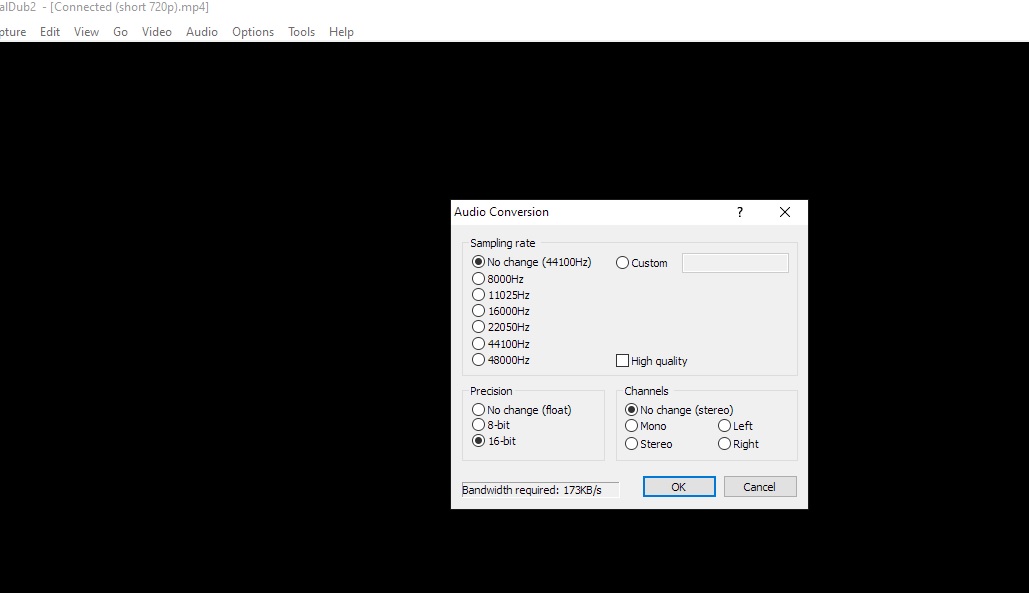

    May also need to check audio/conversion -make sure its set to 16 bit sample width precision

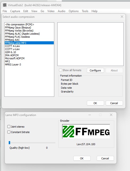

    May 2005
    PAL User
    There's something odd going on here because I too have no options for FFMPEG Lame MP3, but when i click on Configure, I am shown this window:
    [Attachment 72465 - Click to enlarge]
    I haven't installed FFMPEG, but I do have it in a data folder.
    Is FFMPEG required to get those options running?
    Mar 2008
    Isn't it built into vdub2 ? I used Microsoft's Process Explorer to see what gets loaded,
    doesn't appear to access ffmpeg.exe at all.
    Hit "configure" select your bitrate and it seems to work, I tried a couple of test encodes
    and I got what I expected
