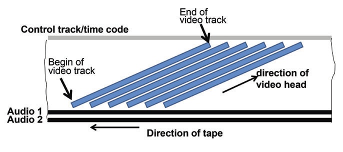

Look at a good section of the tape near where you had issues. Vhs, and similar tape formats, have track layouts similar to this:
[Attachment 72452 - Click to enlarge]
The control track is on one edge and runs linearly. The audio track(s) run along the other edge and also run linearly. The video track runs through the middle and runs using "helical" scanning via the rotating video head, which amounts to the track scanning at an angle to make the effective track speed much higher than the original tape speed.
Without a control track, the tape player loses its point of reference for stability in playback & editing. So, a mangled control track will affect video playback but not necessarily audio. If dirt, wear or other damage gets on the video track (or control track) of the tape, it will make decoding the video difficult to impossible, and some types of dirt and wear can transfer from a bad tape to the heads, making subsequent playback ruined for other tapes, until hopefully it can be alleviated via the mentioned cleaning, etc.
