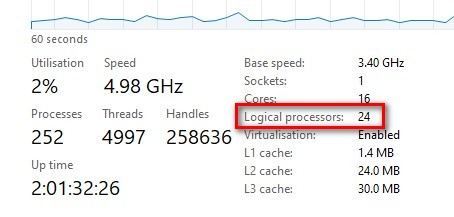

    prefetch(8) # ~number of cores/threads of your CPU.
    The AVISynth wiki is confusing, because it says, for Prefectch:
    default: (number of logical cores in the system) +1
    There are, Logical Processors and then there are Cores, two different things.
    Andrew, on his blog here, says that the Prefetch number is relates to the number of Logical Processors.
    You can get the number of logical processors from your Task Manager CPU display:
    [Attachment 72424 - Click to enlarge]
    I have my Prefetch set on 20 and achieve around a 400% processing speed increase.

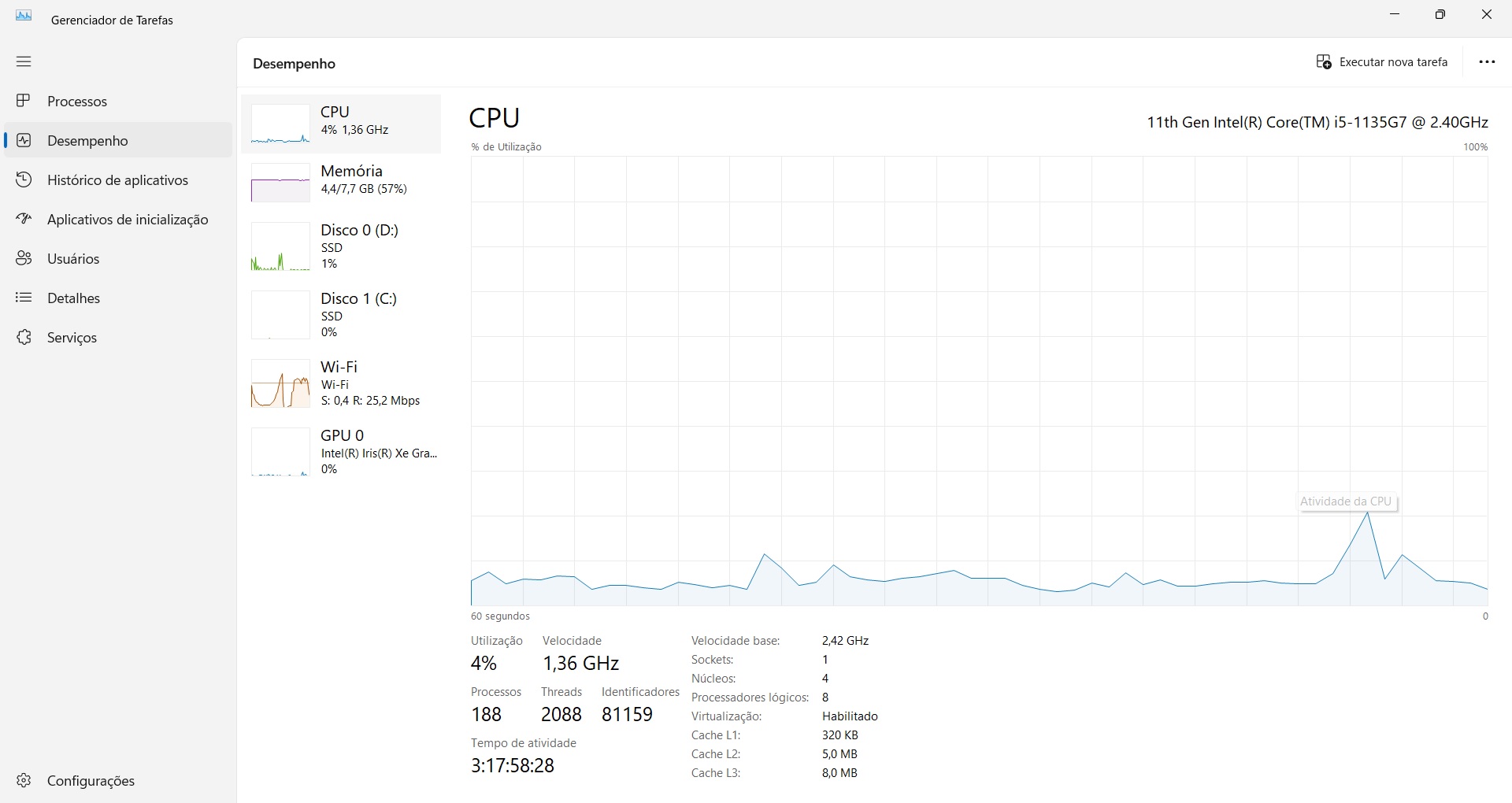

  7. Thanks @Jagabo [this chroma script I'm using is yours ], @Alwyn and others for the quick replies!!
    It seems that my laptop specs are not that good for this kind of thing. Here are my specs taken from Task Manager:
    [Attachment 72637 - Click to enlarge]
    I have just 4 Cores and 8 Logical Processors, with 8 gig of RAM. This seems to be the culprit here :/
    Jagabo, I'm acutally using Avisynth+, sorry about that. I will insert that prefetch(8) line in my script as suggested to speed up things a little bit!!
    Thanks again for your kind support on this!

  8. Originally Posted by rcoltrane View Post
    Your notebook may do throttling due insufficient cooling - this may be also important factor for declared slowness, side to CPU utilization verify also CPU temperatures and how quickly it raise from IDLE to full load. If temperature raise immediately after applying load to CPU and stabilize at relatively high value then it may be sign of the CPU overheat.
