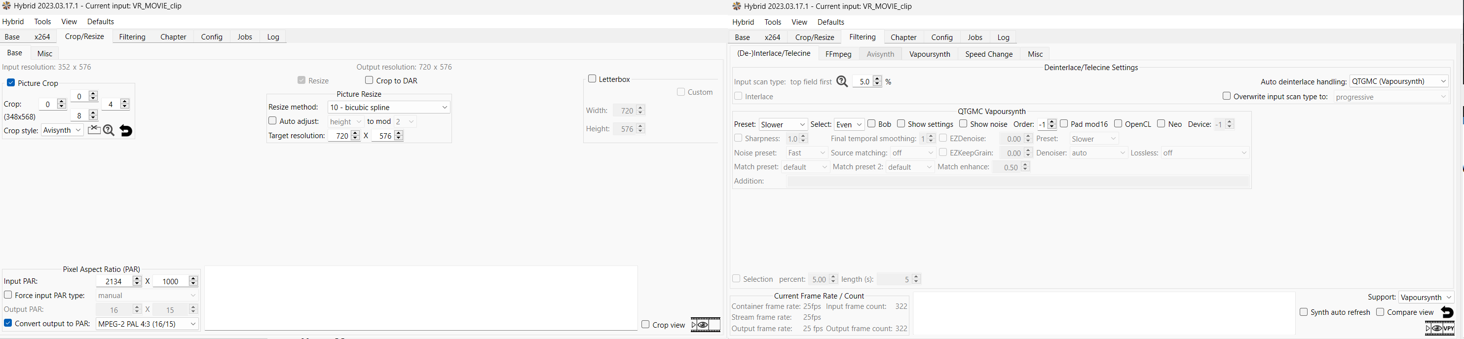

    Not sure if the original file has correct aspect ratio, or should it be converted to 4:3 (like in the vdub & handbrake output files of my previous post) ?
    With hybrid I don't know how to convert to 4:3 properly (I guess input PAR must be changed to something from the default 2134x1000), I used these settings:
    [Attachment 72411 - Click to enlarge]

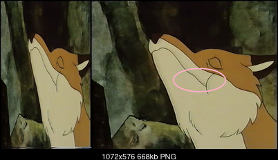

  11. Captures & Restoration lollo's Avatar
    Jul 2018
    Italy
    I do not use Hybrid, I can't help. Selur will probably give you some good indications. if he's reading.

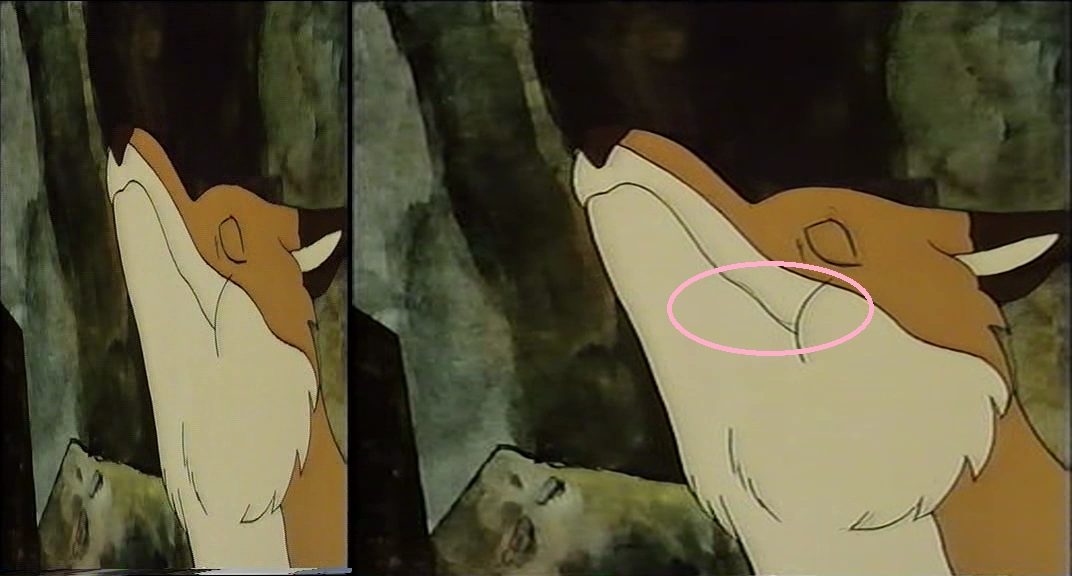

    Your processed files has artifacts, you should read http://avisynth.nl/index.php/QTGMC, in particular chapter "Progressive Input" and find the best settings for your source.
    On the other hand, the jagged lines are better corrected by QTGMC compared to your Vdub attempt. Try also to reduce its denoise effect, because the output is smoothed:
    https://imgsli.com/MTkxODE3

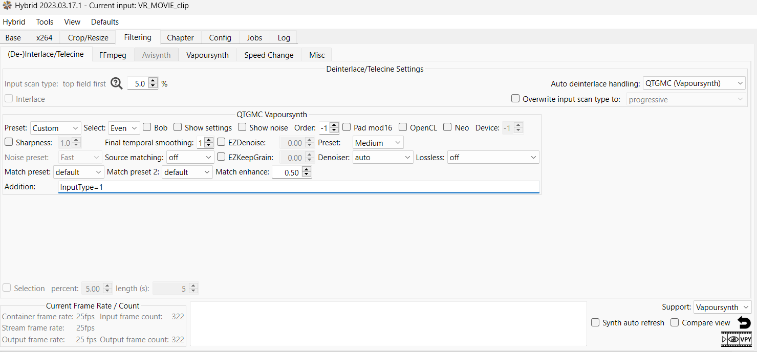

    That artifact is fixed if I check the "overwrite input scan type to: progressive" checkbox in Hybrid.
    But then interlacing(?) artifacts are seen in other frames:
    https://imgsli.com/MTkxODI1

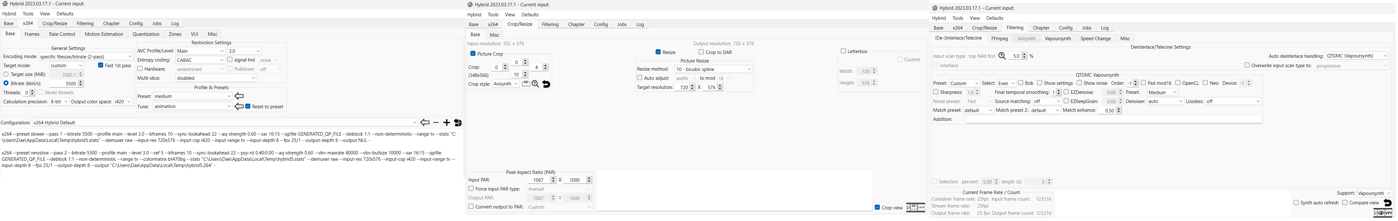

    Also Hybrid encoding crashes if I add anything to the "Addition:" line:
    [Attachment 72418 - Click to enlarge]

  25. Felt like the greatest project in human history but finally got it done.. total time spent 15 hours+ with avisynth & ffmpeg learning, plugin issues, 32-bit vs 64-bit issues, video crop & resize issues, video/audio sync issues, file type and codec problems etc...
    Thank you all for your great advice !
    FYI: RTX Video Super Resolution (VSR) AI upscaling further increases video quality during playback in MPC-BE/MPC-HC with this one:
    https://github.com/emoose/VideoRenderer/releases
    Comparison of RTX VSR on/off: https://imgsli.com/MTkyMDg5
