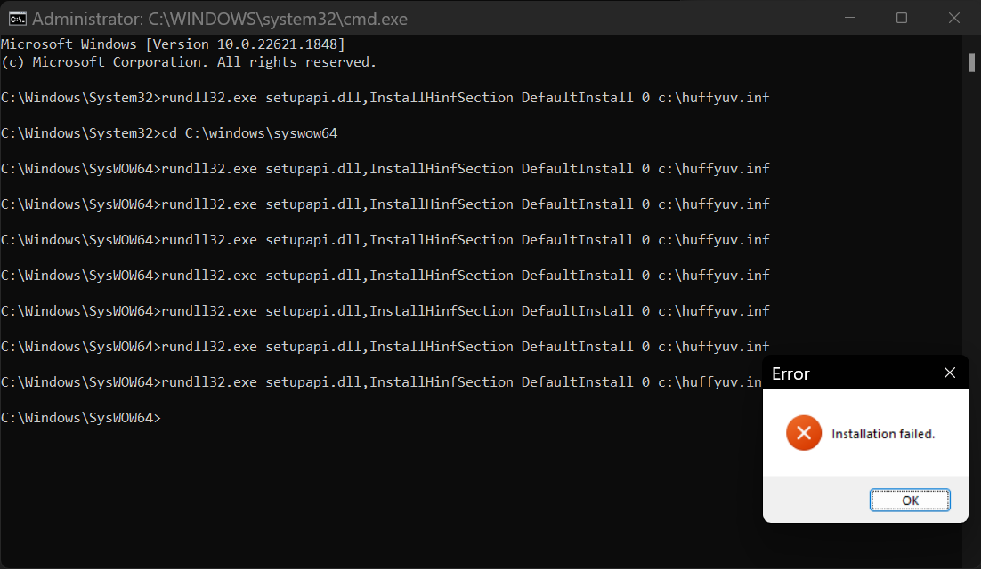

    Yeah, I'm trying to fix it but I've broke it completely. Avisynth isn't loading it at all, and huffyuv is gone in Virtualdub. I don't know how to fix it. I tried to reinstall but it keeps failing.
    [Attachment 72410 - Click to enlarge]
    EDIT: Fixed. I ended up using an installer off Github. And thankfully it fixed HCEnc.
