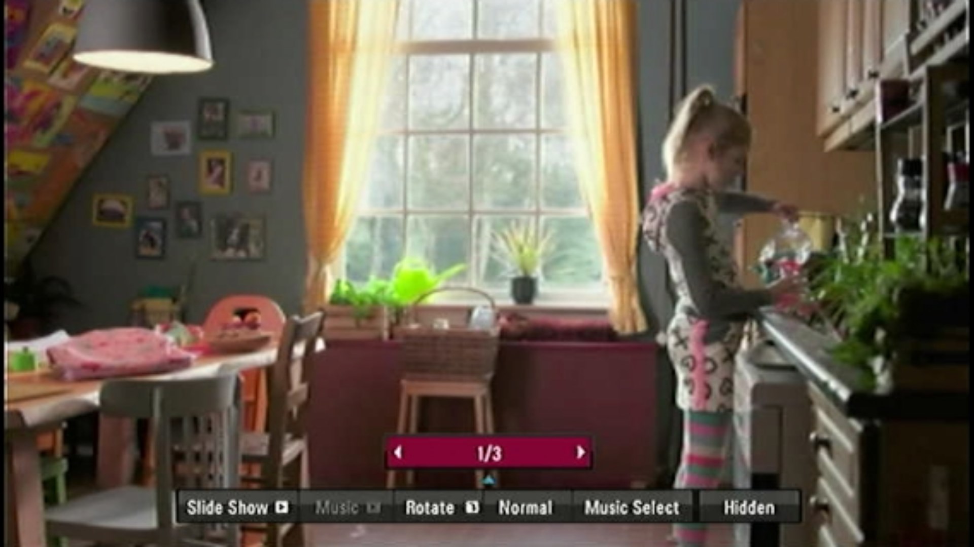

  1. Use that small cheap AVtoHDMI boxes from china.
    How it can be? and can this been solved?
    Original

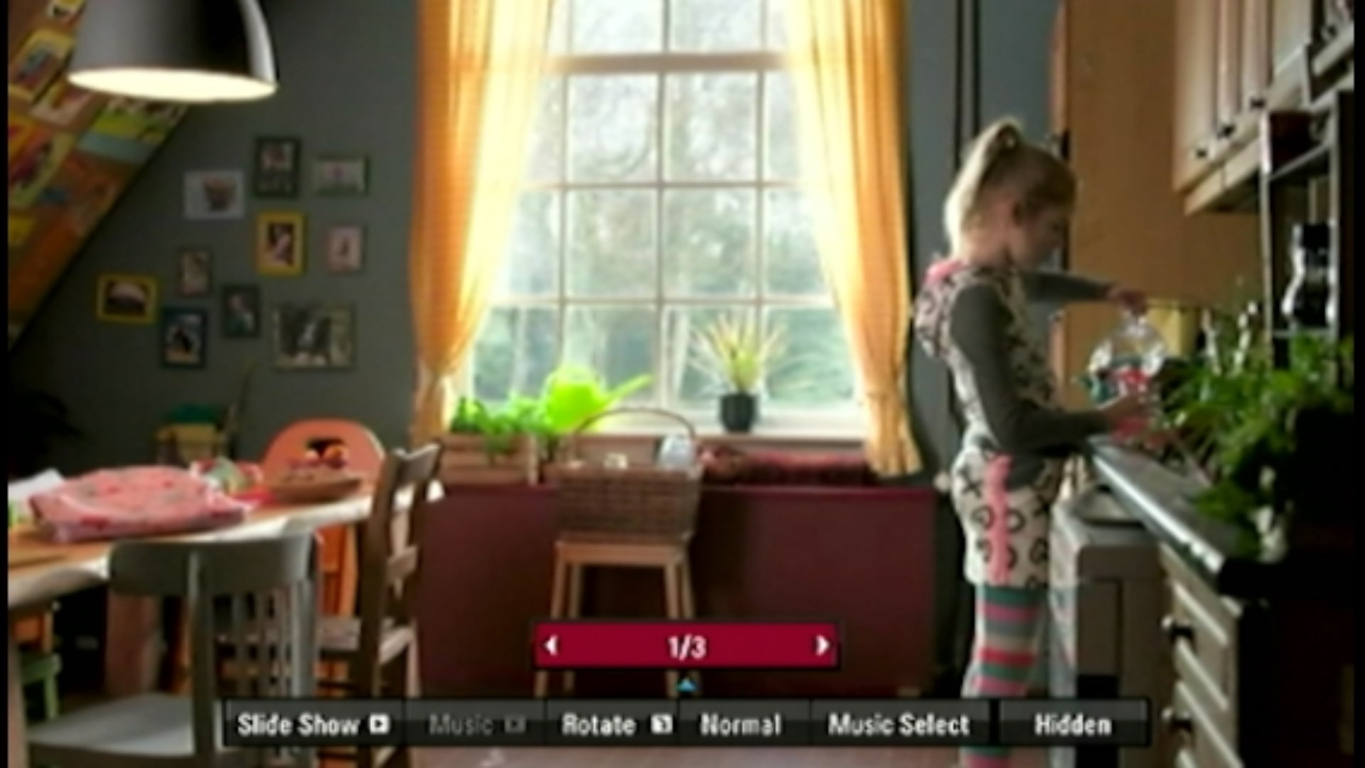

    AVtoHDMI
    [Attachment 72395 - Click to enlarge]
  2. mr. Eric-jan's Avatar
    Apr 2018
    Netherlands
    Don't use China boxes ? even correcting (adding contrast) you loose your shadow details permanently…

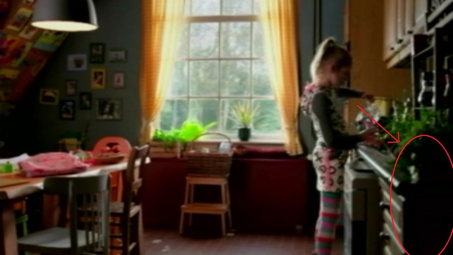

    i have found that a lower resolution capture make it darker how this can be???
    low resolution
    [Attachment 72400 - Click to enlarge]

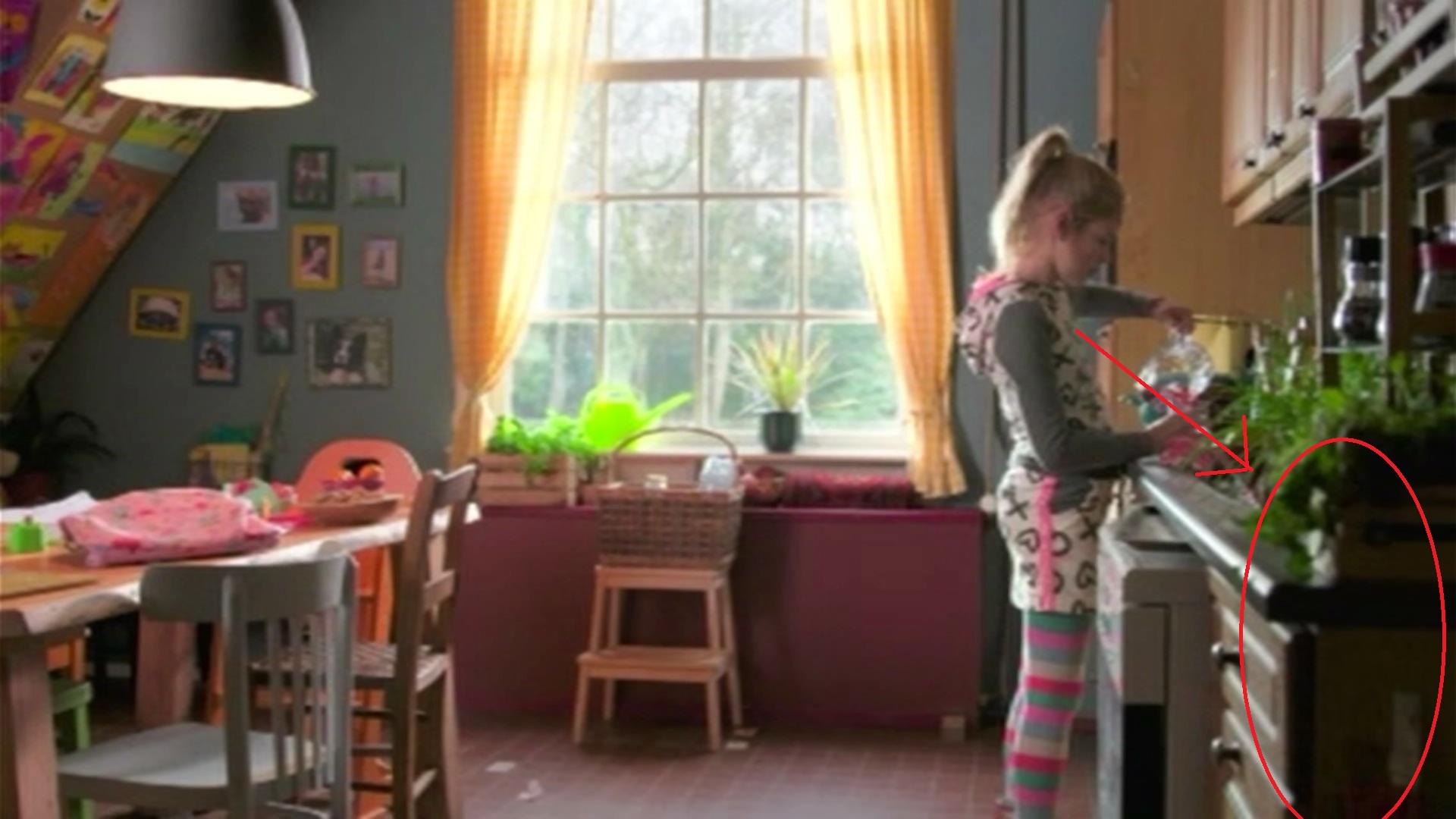

    higher resolution
    [Attachment 72401 - Click to enlarge]

  4. You might be able to recover some of the dark details with proper handling.
  5. Could be a number of reasons including cheap china box. What capture software are you using for starters? Are you upscaling the image? Why are you even doing an analog transfer? What is the source? Kind of looks like APS though not sure that would be present over HDMI.
  6. What is APS? Source is VHS, but even at a 1080 file the problem occurs, so can not a peoblem of VHS.
