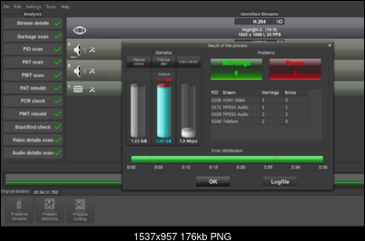

    The file has a corruption on the PRC and has errors in the audio/video streams.
    You can use TSDoctor to fix it.
