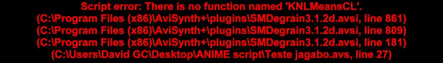

    [Attachment 72546 - Click to enlarge]
    The line 861: """") : Eval("NL_in.KNLMeansCL(D=d, A=a, h=h,stacked=lsb_in || lsb,device_type=device_type,device_id=deviceid,cha nnels=cnl" + knlm_params + ")")"
    The line 801: "Assert(false, "prefilter must be between -1~4: "+string(prefilter))"
    The line 181: " input8"
  15. It's telling you what's wrong: you need KNLMeansCL.
    http://avisynth.nl/index.php/KNLMeansCL
    Or try setting PreFilter to a lower value.

    I think is ok with SMDegrain, it tells me now that "no function named unsharpmask". I can't find this filter on avisynth.nl ?
    It's wharpsharp.dll ? i loaded it but still the error
    [Attachment 72549 - Click to enlarge]
  17. I included the custom UnSharpMask() I use in post #7 of this thread. You can copy/paste it into your script. UnSharpMask() uses BinomialBlur() which comes with the VariableBlur package:

    What error is that ?
    [Attachment 72553 - Click to enlarge]
  19. I don't know what's causing that. I don't see anything unusual about line 6, LoadPlugin("...depan.dll"). Maybe the prior Import of TemporalDegrain is causing the problem? Since the script isn't calling TemporalDegrain() try removing that line and see what happens.
    I would try this comment out (put a # at the start of the line) the two calls to SMDegrain() and UnSharpMask(). (AviSynth will then ignore those lines.) See if the script loads. If it does, re-enable the calls one by one until you find where it breaks.
    Started a clean script:
    Import("C:\Program Files\Hybrid\64bit\Avisynth\avisynthPlugins\FineDehalo.avsi")
    Import("C:\Program Files\Hybrid\64bit\Avisynth\avisynthPlugins\mt_xxpand_multi.avsi")
    Import("C:\Program Files\Hybrid\64bit\Avisynth\avisynthPlugins\SMDegrain.avsi")
    LoadPlugin("C:\Program Files\Hybrid\64bit\Avisynth\avisynthPlugins\KNLMeansCL.dll")
    #LoadPlugin("C:\Program Files\Hybrid\64bit\Avisynth\avisynthPlugins\variableblur.dll")
    LoadPlugin("C:\Users\David GC\Desktop\variableblur0.7_x86_x64\x64\variableblur.dll")
    DirectShowSource("C:\Users\David GC\Desktop\ANIME script\Asterix und Kleopatra_t00 (1).mkv")
    Crop(210,0,-210,-0)
    ConvertToYV24()
    ColorYUV(gain_y=20, off_y=-10)
    FineDehalo(rx=3.0, ry=3.0)
    SMDegrain(thsad=1000, tr=3, PreFilter=4)
    MergeChroma(aWarpSharp2(depth=10), aWarpSharp2(depth=30))
    UnSharpMask(1.5, 0.7)
    Still this error:
    [Attachment 72554 - Click to enlarge]
    I loaded the variableblur.dll from the site you sent me and i have this error. Everything works unless when i activate the "unsharpmask" filter.
    Thank you for your patience and help

    See post 7, you didn't copy jagabo's inline function into the script

  22. You didn't include my definition of the UnSharpMask function. Copy it from post #7, and paste it into your script. Just like it appears in my script in that post. Or put a copy of it in the plugins folder with all your other AVS and AVSI functions and Import() it into your script like all those others.
    # this creates a function call UnSharpMask
    # it's not executed until you call it below
    function UnSharpMask(clip v, float radius, float strength)
      blurry = v.BinomialBlur(VarY=radius, VarC=radius, Y=3, U=3, V=3) # or GaussianBlur
      edges = Subtract(v, blurry).ColorYUV(off_y=2).ColorYUV(cont_y=(int(strength*radius*256.0)-256.0))
      Overlay(v, edges.ColorYUV(off_y=-128), mode="Add")
      Overlay(last, edges.Invert().ColorYUV(off_y=-128), mode="Subtract")
      ColorYUV(off_u=-1, off_v=-1) #overlay is causing U and V to increase by 1

    Thanks jagabo for your patience !
    All OK now.
    As I said on the post #8, i didn't know that the function for unsharpmask has to be included on the script.
