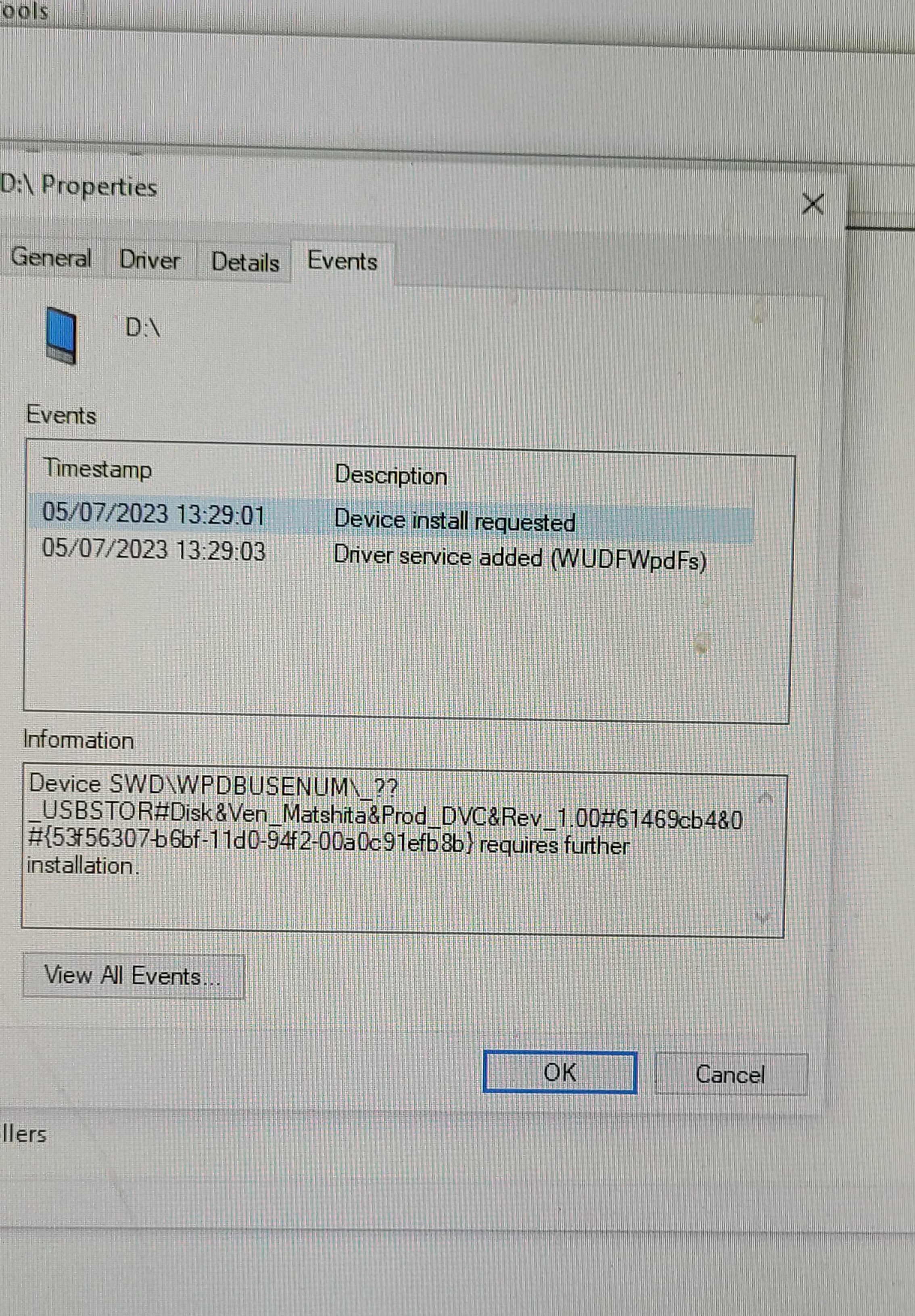

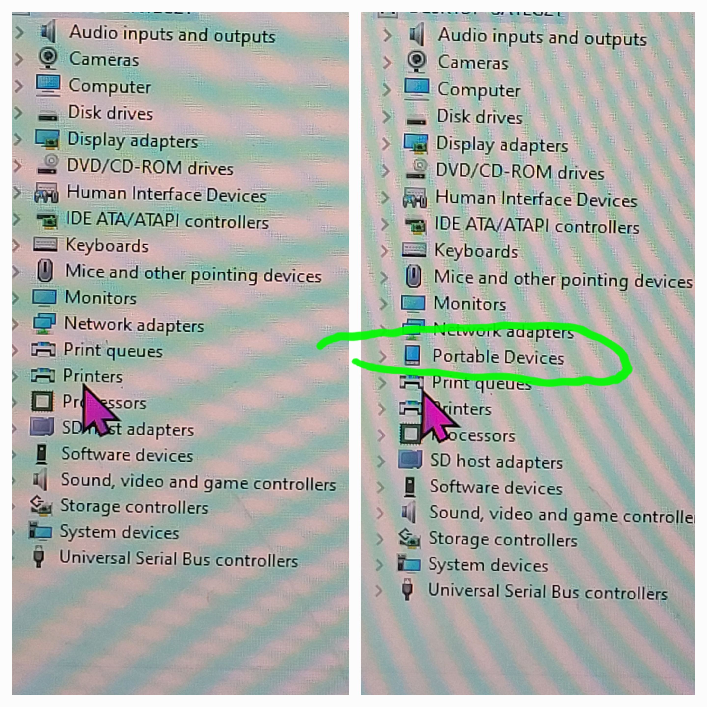

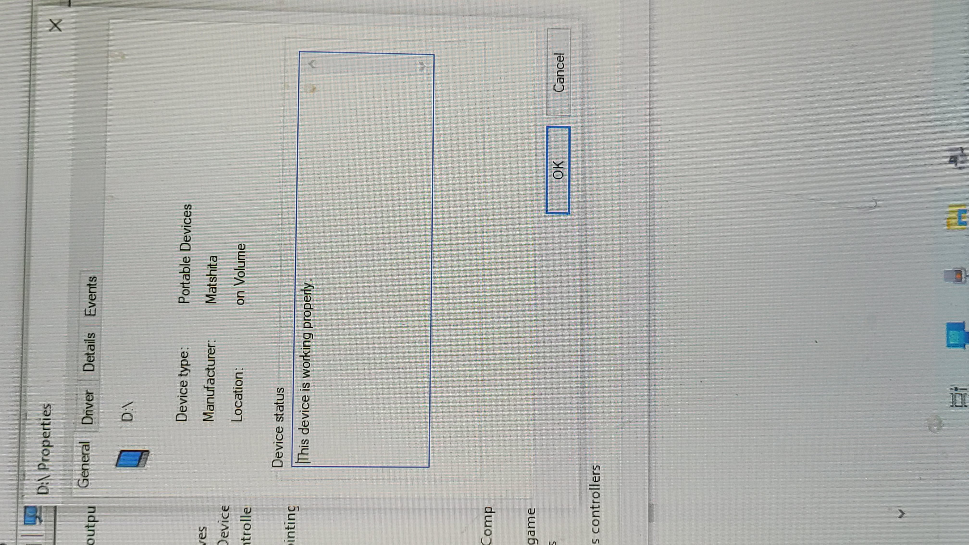

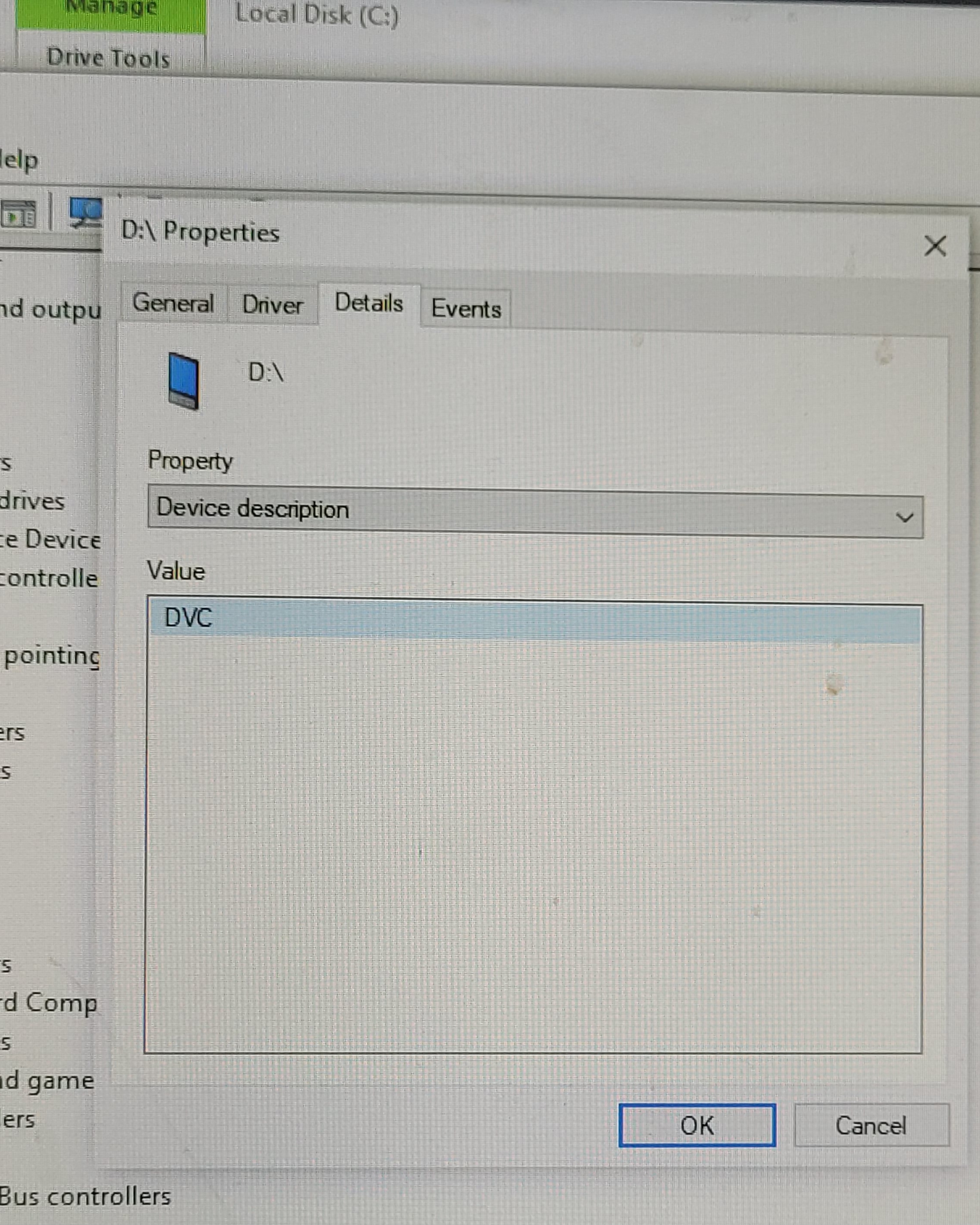

  6. Thank you Alwyn & subtitles
  7. Originally Posted by Alwyn View Post
    No need to pull your hair out, yet. And there may be no need to install those archaic old OSs either. The issue will be the Firewire drivers of Win 10.
    You will not need any specific drivers for your GS75. It is a bog-standard DV camcorder that will work provided the correct Firewire driver is installed.
    I'm away from my main machine so can't provide screenshots, but with your GS75 plugged in, check in Device Manager; do you see any reference to IEEE1394 and/or the GS75 or similar entry for a camcorder under imaging devices?
    FWIW, IMO there is no need to go back to XP. Windows 7 had a great Firewire driver so that's what you should be aiming for if desperation sets in. But we're not at that stage yet.
    You'll be interested to know I recently updated to Win 11 and the Firewire works, "out of the box", with a cheap VIA chipset-based Firewire card.
    This is what shows up in device manager...
    [Attachment 72329 - Click to enlarge]
    [Attachment 72330 - Click to enlarge]
    [Attachment 72331 - Click to enlarge]
    [Attachment 72332 - Click to enlarge]
