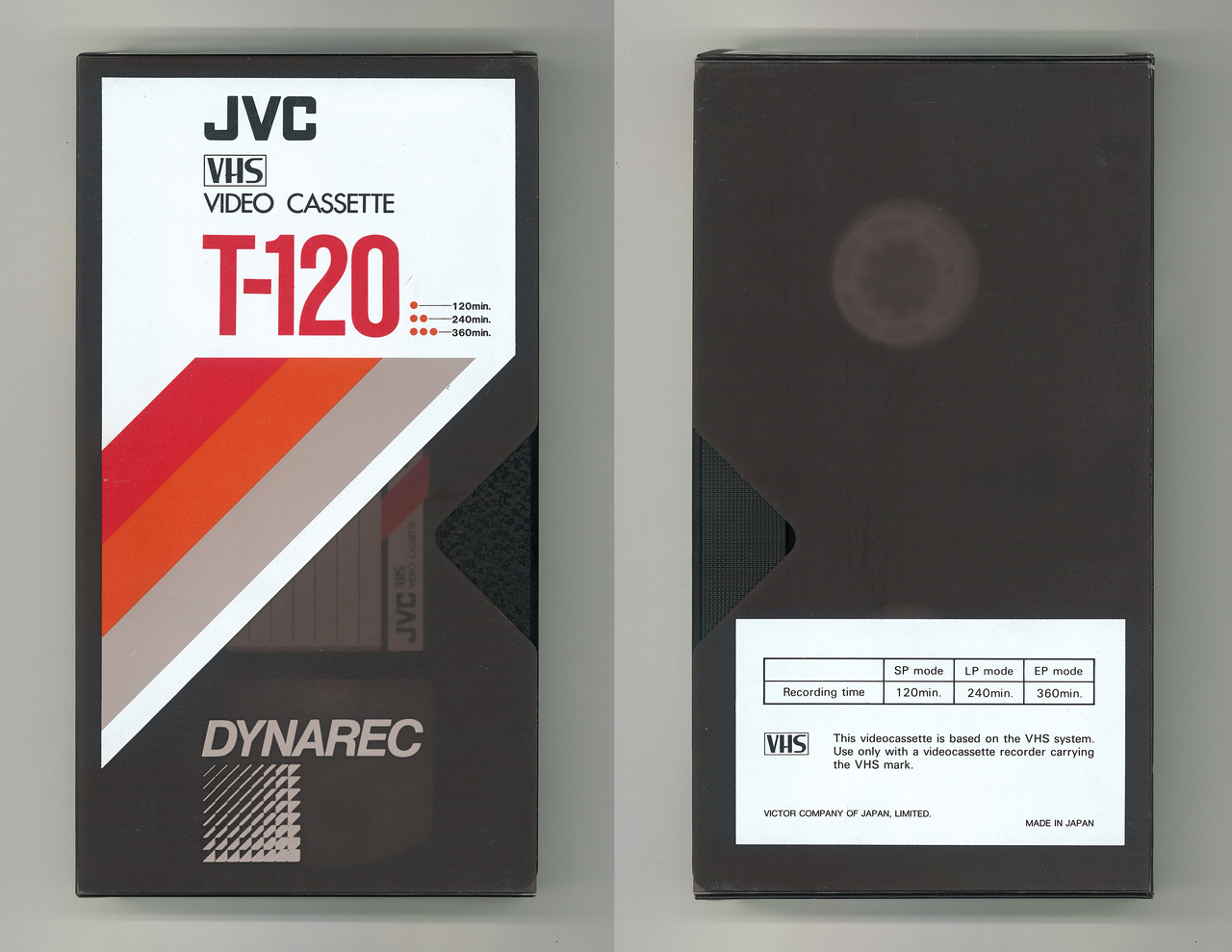

The tape is an 80s JVC blank that looks like this
[Attachment 72862 - Click to enlarge]
A decent blank of the time period.
The recording was made 40 years ago in 1983.
Clearly the tape has degraded over the years, given that is plays with as much flicker as it does on the RCA VCR. Plus, it's an SLP recording.
