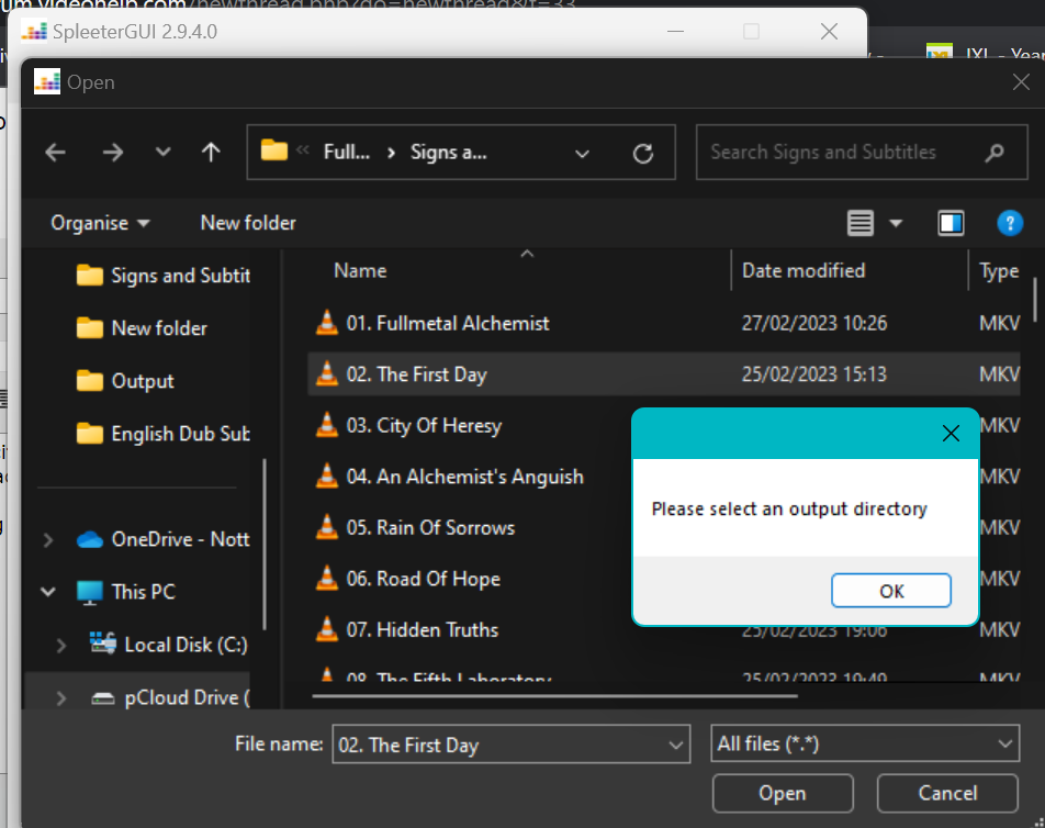

I tried to use audacity for noise reduction & removal and Isolate Vocals (Remove Music and Keep Vocals), but it only makes everything lower. I am watching anime and I want to make OST music background remove, but keep character dialogue.
And I am also using spleeter but it shows this error message.
[Attachment 72197 - Click to enlarge]

Then set an output directory. https://youtu.be/Yk2_vTLE_pM?t=93 -
Then set an output directory. https://youtu.be/Yk2_vTLE_pM?t=93[/QUOTE]
I'm windows users not Mac. And I am using MKV file. -
add "-o outputfolder" to your command line.
