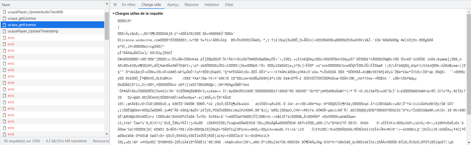

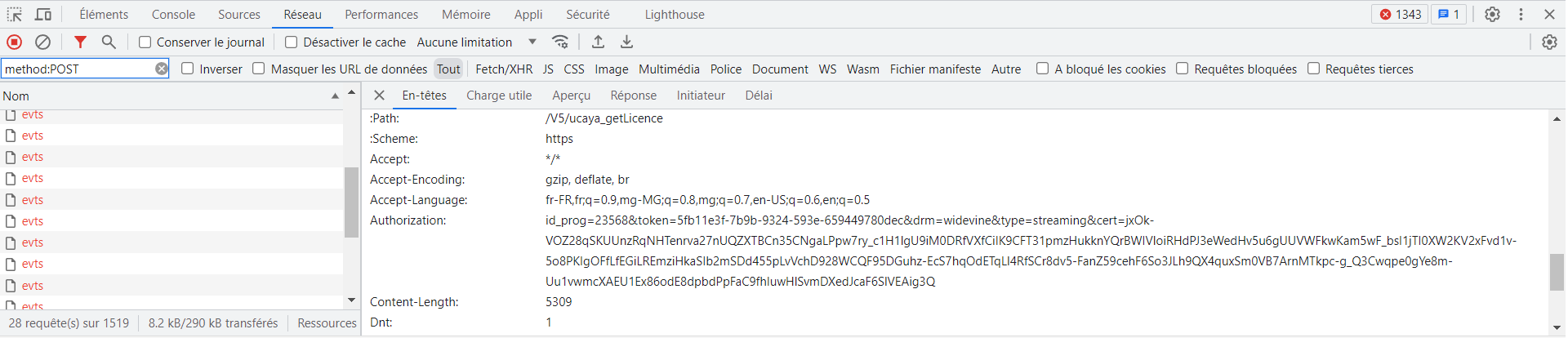

  1. So I usually manage to work with payload and json responses, but this one is unusual and I'm stuck. Any idea ? I suppose my headers are fine but not my l3 script... Anyobdy to put me on the right track to customization ? Or do I just forget the data and focus on the headers ?
    data = '\b\x01\x12\x9f(\x12*\n(\n\x12\x12\x10>Òyí&ùB;¬¡\x0e6¹\x8e¶C\x10\x01\x1a\x104ßj\x98·ÿ^=Á\x1fÉã3\x99(D\x18\x01 \x81À÷¤\x060\x158¢Û¨\x9e\x0fBà\'\n\x14license.widevine.com\x12\x10\x17\x05¹\x17Ì\x12\x04\x86\x8b\x063:/w*\x8c\x1a\xa0%+ªls!Á\x8c\b=À1þ\t0\x14«Ëbñ\x839\x04îÖÀm\x13¿·°,î´f)£)\x82op[\x85u\x0e\x1fÕ_\x92÷ÃÑZn|«ô\x1dS\x01\x9fê\x82\x91kqÐ\x87\a\x96£\x12S\x87uêñ\x8fVz2&Í-`î\x8aã´¾\x11W\x96ä\x03\x03g\x00#\xadé}î\x93j9±·\rð\x89\x9ag¾\x1bÃ\n§¹\x05|,í¤>\x9c\x1fB\x94\x98ml×ìg\x1cÁ\x8d{*\npÎ^ÐÃAõµÃ0ÍóaJ¿`¢\x93c\x902µ]\x7fõõÎ\nÛ#üð\x1dõ\x8a©\x97\x9f!×\x9b\x1c^\xad\x01\x02¢^]\x8f\x11\x1bX\\o:ËEuÄЫÒ\x14\x8dnÞàà\xa0þÎ]\x9b\x9bþ\x9a\x10ÿ\b\'ÔL²ÃG¹r\x13íý\v£Ý%#\x1d\x1fV\x8bæ\x8e\x14myÖË÷¨>¡IÜ\x10l.+çÈ1¼¢Q\x14Aµz\x04\x13û>\x02\x18¢\x89Ö\x18kÞ1\x80äyp\x1e7`\x84É\x95\x15\b£\f¹tÅ\x19\x96\x8e£\x02¾@\x14v?\x15\x82\x00\x92½×ë\x90\'úï\x9fÜ\x1e¢¸zbÄê¡8qæmø];\x1d\x9c8_óå\x9a×\x19\v×¢ô\vyä¶O\x83ý\x0ff¿äÕ[Ræh\r\x86Äe\x1e¥ÈÝN§ÞI<¿\\ûº-dè\x98Ô\x19\x9eö\x96\rçÖ\x90l÷Ç\x9a\x8a\x02\x86|{Xke\x99\x02\x11þ\x12:*\x8f÷\x00\x98\x8d\x9ay1\x12ä\x06ü\x8bja;ý*\x9cc]~ËÒ\x01®\x00xú"e±k\b\x01\x86\x1d\x03¾CGne\x8fÖQYÏ\x10\x97LÔÛ¬ÈÎ\x84ãæR\xa0|¡\x8c/LÅTâ¥QßQ,åüpFí(¤1ä±Q%\x9fk¬GÀ\x96dØçmø«|}\x9f§""\xa0\x94^UkG$èjÕ~oÕBbwJ\x9fLnÊnöë#È<WF5µÖèÔ\'Fqºr\x96Ò\x8c\\\v½ø¢\x99·"Q¹¾fÈßÄÀñz\x92o.\x13\x12\xadÏ-\x97ÖJ^+~~!KT¤À\fMcä\x8eÚëcp9ßXc\x1f´oDa-®xÏb\x88ö\x04Á\x00\x1b\x88\x93 *\x86Ö\x8a9\x7fìèîØØc9\x8878ð[é\x93¿G`ÔBm*¢åe*Ó7î\x89z|Ò\x89¹àþ¸\x88%Q\x9d>\t´\'«\x13\x14M\x13cý\x94\x1d\xa0©S£\x1c\x83Ó_˪Ø\x17VñÁ,\x83LÐ2ؤík\x00\t/\vX\x13´ºXæ³J\x10æ·FE>Y\'è\bK?\x89\tl\x83^\x06\x90uimrbb\x85ѵĢ\x8cH{å®i)\x9f¾\x00\x8eà¥n\x83®Ñ¬\fÇ\t\x91ÜD5\x8cÏÝ\x1fðÍ\x12\x99RG\x8axø~Ò\x99ÀhJ\x87Ð_;hbªJSôe-=Ñ\x8d$Sh\x00\'¸ç\x87Ð<t\x9côf&䵿\n\x90k\x15\x1cÃ\x85(\f\x18¹1í,O(=\x88\x03\rº,f\x1f\x8e\x04X\x95Õ\x9cnû\xa0û\x92ª)[iê\x86I7\x93\x05ó\x95%\x01@+¦-DH^M¢NgòÕ&Ñ*ükA\n¯ÒP#ÀÃTÆGoÌ\x98\x8e\x02\x8c\x9cÊ\x9c(\xadÜe¤ülî?\x85r¯9i\x8d\rÕ\x1f#Q\x87¢ØH\x1br5¿xy¥áá÷× Ír:¥p\x1e\x86k\bÒ1E¥\x9d\x1b\'\x17\x17\x1f\x13\x11\x1d¾\x86\b1f!0\x81ö\x0e"B\x13 N\x7fõ9\x0f^\'\x8eó*\x81°jêM\r\x12dNBûÅèØ?*{~®¯Ñ`=\x01.ö\rS{%ãÝ\x17=uü\x84"\x12c̯6>£\x1e\x83\x83\x1d\v&\x96Ob&M=§rðÕ¸ZE7o°Ry.ßEÌ\x16ç7Z\x9f\t \x8aý«@ã\a.ß\x11{ÑÉëkN[\x9aÔ\x90\x86fA\x84Ò¦édÔdoNpe²\xad.e(|ä\x02Ä¿ó/Í\x99^XÃò\x0f\nl\x9b5·¡øhÅ¢$ìz\a=ͽ\a\\\x840\x98\x10x\x89.q\x00ê\x030Î\x14\'Ú¥\x8f\x03B\x00\x9f\x93©Ô.¹ó2 ¿\x11xÛ¡\x01ÎÉQ¶uÓba¼óû\tá±IÙ\x1aÚ«qðú2\x19C·\x80\xa0ó¼r.ò=<\x97\x98¬ö\x85b®òq<·©²\x14\x17Q\x17ZÛ1¶F\x80á;\x7f\x0f\a\x9d\x8fUqó¸À³«Ç\x9b\x9f\xad½%ã\x7fc»u\x1cU¦Ô"ºà!IsïìÃèRe\x1c0J\x8cý/ÜÆ\'üÖ7¿i)\x83\x9aË\x99@\x1eêérë\x17\x81µÎæ\x05\x0e©Ü.jw#\x11"Ã\x88·ò\x90AQ/&\fqËh¨pEÏÿ\x1b,P\x91§Ö¼\x10\x8d\x10kÇzWqIÞ24\x140Á.\x110"$\rz[¿`W\x87\x0fç]\x19\x85äpO,CHV~<R©}Fá¸AÓ#\x91Ã~µWsíc©Ú`Ñ!¸â\x92(\x04\bQ\x8f£ý\aO\v°\x0f\x85\x7fë\x1e7\x9b\x85¼Ç\x0fï"\x80³Kç²Ïû\x8a\x881\x91Æø¥Ð¡oX|\x9b»¸1B`ÐU>ë\x91O§Ê\\&\x1cU8@\fì\x99XnN\x99È2rx\xa0CD\x81\x04sÆé!\x94òOò\x98®óÏá\xad\x05ê·ÏxY\x95v ¾i\rNðà<å\'³»m\x8c\x17Ï¥øº\x9eW\x9e\a(ËÏ(\x06\x15лSL:»ô$£1˳à)\x80\x9d\x04\a&,Å«\x0e\x87¤Ñß®\f\xa0×\vù9Ö\x9a\x856çøò&Ã\x1bpæ~\niS;lñâ²´Îàm³ú`ð;\x0e|9??j¯\f\x0fì$_Ï\x05¾yYÀÎ?¦j+\aw\x98\x9e\t(\aX\x95ñÙÌ\x8f\x83;Ýîo@±m\x98ÃW\x7fE\x855\rƯÚ\x98s¿\x82\x9búÂ@Ãa\x85\x03Á\x0eÕ\x9dó8·ßBÝr£Ô\x92\x92,q\x9a\x0e~}Tu°$f¥UZTÔ \x7f\x1c?Û-\x00Dh\x8dó\t\x11-×\x04ÌÉóFù<\r\x05D\x13yUü\x1c=¿1£nÙ¿>\x0e=~¿dj\x89RÞU\x01áËu\x88s´âÂ\x8fôm¨Sä)Y\x8a\x9f\x9b\x9e¢]\x95{´ê\x8f¥\f\x813\x00\x8e»\x1aÜ9<7\x16¢>)Ù\x1b»\x9c\x83Þ\x9eþI\x8d]ÙNq\x91+³\x9dÂ\x13Ýïq[\x9bPÿx6s×8ë\x17¿»\x8f\x06µCA××Ww\x8ak¸Ft!sG\'zi\x01\tÓ)FRi\x96\x1b|!ð×£\x10\x91\x8dÄ\x96ó\x9aé/\x9eÒ\x01ÜóõI)UïË4<ÕHv¤NJ¤¨\\>~é1N\x92\x89nLQ\'¦\btÃliJ\x85:õö\x91Ãõw¿ª4ÇÇªÓæ\x8e\x9be£¥\x16ê·\x94ª6\x7fìØ\tÙæ\x197c\x87r-§\x9biÒ¡\x11KB4\x82¿¢\x06OÏ1kÖÚÏjR\x1eÈ[áiñývt\x11\x86\x8aÏåcD¯V÷~\x0e±\x8dHVelÇ9\nÍ\x15Ç¿u\x02L!&Y ×HY\x9da9\x8d[¨\x14Y\x88BÞ\x81\x98÷]\x91ÊúlÂ¥l\x9f*ÔÄ\x05Èïî¯0\x06:\x0fN\x1d\x00-ò¾ø\x01÷döúrZ\x16Fv,d©ö:Ö°zÚ\x1du[õé¹Ù\x1e·Ð\x93\x115\x14V¸8Ӷܥĵ3Ng-\x1b3ö°H!²d\x19kÙã\x99_Q+\x1cB\x90zö£Í¼îc2\x8fÅÂn9\x99\x02Û\x1b:BÏù\x92¡ÓC\b±\x1f\xad¡\x91ÝÚ\rÝj\x1fÛjäp\x04\xad7¦!µDI\x1c\x90D\x9b\x04àñ\x80\x89\x9d\x1c\x9dÖF\a³dTp\rÐÉ\x8dë²ÀÐ\x96Ø2«½k\x83Á;\x01m2û\x95\x15C¸4¼¶Ê©4ë\x1fn\x87\x8eWï\x1a\x1du\x1e÷«ê¾Ç(\x00£Þ<\x13)[°¼Jq\x8dú\x19ôÀÓg+EÔmÝÁ\x88Â09£ÉB\x7f¾Cìe\xa0bCÄ\x84>2Yú\x15uMXì\x95G\x1d\x02º+QÓä\x11W\x8dÞ\v\x86\ao\x1d¦|\x81G\x1f±\x99Î\x8cò½\x92@\x1c\x7flb\x8d-¶\'¼Gâ§\x1d0ÎbÿÏð&\x8cZ*~¢ÓVb\x02×\x04Äþ\x06\x98\x16\x05d±b¯\tçM;À\x1c¾wÂ?\bÉî]"äöNUo8ï&îeksÈajãݳv\x06\x9b[O·a\x9aÒ¬ØBÚ\'¨\x92ß]9\x93Éü\x03FÜÂAçdus\x81´\x97\f\aïÿé»åx¢\x9dy.\x92vÆ\x19¿\x9d§\x94y\x00¨÷3Æ\b®r¿Ü\x1dÎõ\\091\x0eAx¥¶·£\x8bXÝX¿5Ìr\x05\aÿX²å\x1fITgJa>\x1c~\x85Hme\x1dþG}1¡Eû\n²Óê\x16j-\x8a+Àsv\x89ïã\x8a±á\x92À³\x1fñ\x8d0òq\x8cï;xO\x1ecãÅ\x87$\x97.\x8e\f\x1c.ã¦êD.\x80Ù\x143\x9d×9Â÷ü\x81¿\x86\x90\x80°§m=\a\x9bµÅþ\x883\x98Ë\xadÀÒÖ\x1c_\x8f\x030eîYÊnª|Q\x1e\x8e«hÕø\x81D\x9e,^ÅGÁ¦\vð\x03à\x0f\r\ap\x8d?ã"\x9bq¶p\x85Ðø\x1eï \x11¼ \x1d\x00a^G\x13©&z6¾ÿùíѹ\x89C86ÊGvI\x80+\x15jÿÀ\x80«r¯4^\x19Ð?VT\x17*tÎ\tÞ\x84òñ,\x1dªÕ|2\x13\x8d\x8b¶§ýG½ÚcP\x03V\x0e)\x9e\x1eË©®t}à"I1Lª»Å$ÔH\brÄ\t÷ôÈd\x84ÑþÛ&~ME¤\x1bý\x00\x99HDþÇÿ\x14Aú\x14¹\x9a¤`¥\r0à$¥\x17ÿ\x82\fÛ\x17\'\x10Ä/Ã\x19?\x904ï\x1b\x88\'ä;\x1cIèBÌ\'ØúݽõZf\x18\x14»\x1bÞCíVc8\x14^Ï\x84k/¥ÝDÉà\x15\x8d\x7fb£ú¸\x90\x054\x11\x9f\x05\x06è\tÚÏ\x85\x93p*vÞ\x14\x9bgVj\x1f!ÜEU[Üÿ¶ñGWlÞXâÔ«\x8e\x7f\x06s\x81\x83ªl[²Ú×"\x05äÊX´\tk^OÕn;\x85-í\x03\x88ÔÕ±\x9d*\n¶£úó\xa06X<<vØøt²~¥ÄÇø\ncZ)\x9b77JÜ\'[É\x18\xad\xa0\x0f\x065åZ \x06\x12;ÙÂ\x1a\x9dÓ>\x96÷Æ*o\x0e\x8cÒµbC7H°4]?\x06ï\x12\x19¢ú@ÈË\x1a\x87{\x01qZºçH§¶\f,$\x8f\x84Õ\x1bl\x87ÊN8\x17\x83{\x9a\x85b\x17(ã&.XÙ\x90\x93Ò&Ô±\x1aÃ\x8b}òP\x92Û\x1f\x14\x96Ê\x84)fQU²\x17\x10£\x8c\x993¬\x80\x82G9aá3\x89°Bó\rGÄ\x87úù²ÃÂô\x83\x9dNCÇ\\èÐ\x17\x96¾Á\x867b\x110Ý\x93îí\x85¿;û®\x8b=\x87±\x91\x86\x15x\x86Ó\x85(\x01SìÒÇôá´\x89 \x16¢c¦Ç\x9f.\x1dÅÛs\x13\x17æbij¢m\x14K7l\x12í\x88\xa0N[ÊÝ^Pk2À\x15\x8cÝÄF\xadR)Y\x84æEÆ=Í\x91Ü(e$Ùðuµúf*ôR`â¯ÔM8\b±\x04Ø\x81Iùò\x851v\x1a\x94¬æBvè÷ú@£&û\x10«ÀÈ¢A\x00¢´ºUHp\x05\x85\x1f\x06ùÖwVUkHâEHòLѺ\x12Ü{\x87?\x97\x13K{\\»\x9e\x117E8¿\a\x84æ\x7fÑ\x02)\t\x88\a5ЧÌô[t\x04Ë6\'+\x86%Ý\x97JêIÓ\x89c\x889\x15\x81E8§I}àïHÃ/|õKÿg;\xadMÏÊBOêNÊ]\x86\x198²%¶¹M:á|Õ\výÿ®\x862\x18¯ô[2\x98 *t\x1añö¬\x89÷Säß¼T¾\x9a4\x1f¿B¡õ\x8bÒ\x9bÞ\x0f\x1e\x11frv\x06\x99é\x95¹ØÀ\rLÄ\x01\x0e>\x1d\x16\x90{8®BÊ$8©Ü\x86³\x97Ã/\v¼\'Ç\x95\x81ÔZ)Ð\x0e\x8a\x9c\x1eÑVô\nîkù%\x10\r3ßX·{\x1eB\x8c\x81Ë/kܬ\x13\x89ooð?\x04\x98[\x93Er~\x13:E~düÌ3M\x9cô0ãèmòU\x11\x03\x90ÜTÁ\x8bk<@ÙtÇ\t3m\x19|Ñl³¶ßAó\x05D\x98d¾ñ\x86\'LÔ\n+®\v¤F\x1e\x14\x96&X¦\x87Ô\x97þ\x88\x0eaWW\x9e7\x13ÛE\n\x14N±j\x7f=YÏa%>É-\x1ez&µ\x9c\x0e*\x8c +.\x03·y¶\x12a\x02\x8c\x8eÄ\x8d¥\x1c\x151Ü\x8a\x1cr\x96Æu\x86ɲ\x88Ö®i\x90\tAÜ\x16È%\vSÁ]\x9a0\x8f&WÜî"\x93;íeC}Á$\x03\x14s\r\rxj=Í\x82Dãkj}¹Ä\x92Ö©\x04ÿjz1o«ù\x7fñ\x14;O3Âq\x88eÞÊ:\x9e¦\x01\f߯\x8et\x9aï\x81<£xàÎ\x02\x04d¦d1gìá(\t/å\x12(\x9e¬\x10ÿXWL\fCeác5-\x81[\ta\x83³ÔgPÃÀú¬d\x99\xad=¯ \x95\x1a*KJof£ÌMT-æÅa=\x89\x19Gø\x1aújbV\x16QÔ\x1bÚGLö\x02¾.\'\x1de\x82\x94¾»\x12\b|\x00úÝ̲Iµçg\x1fûSgrxHª\x85\x8c\x06\x90\x8c\x84K\x14\x06mëÔ"M_5d|4\xa0óåL\x89\x16f×¶Ìþp\x8f\x9b\b\x84wÕss\x85Sôû a\x83\x10DT\x1bØDeãÈÖ¨fuÁ\rU@\x98{w\x05¤ö«\x90@ÁkâýÃãcïu¢«nü\x1e½o\x16jµZ\x16\x926Íï88\x9d_3ÉG.\x8c;´Dñ<T\x97\x9f\rJX=Í\x98nG\x9b¶\a(\x9dìîh^º\rÓ\x00Ô÷\x83Ð\x9fÂq/,Ð&\x14\x03\x81C\x14\x94\x85\x81\x1a\x0e\x03&s\x13*ûÀjîÇ\x8cHCùc\x88$cÈ\x94\x99}#yA\tt\x95ØN@\x12?·öÓ>\x9a|aÐ){-\x1e[Ð$qõ»\x8bSÜ`¬_\x1d²1\x00Y\x17hÍðf.~\x162\r¨e` ù\x88\x0eïK)h\x1d\x91\x88gÉìË\x1f¤\x7fh\x96Ëm]0\a}öaǸ@w±\rèËÒ³ý\x98\x9fç¿ÆB~ÝcÎÕ¨Ü\x9c"\aç@\x91<\x17~æ©I\x97¥\x15Í¢ÃQý¡?i©\x18\x8eIë\x92\x84äV^Le¡J\x9eò\x00`é\x7f2[\x9aiN\x06Ó¨p8ú\x1bå#\x7fí\x8a\x92\x06¦á)<æÛ\x01`æRüÜQU¨íÏq·èÔd\x05`»æ\x91\x05í\b\x12ÀU#\x96\x8c#x2¤u=\x1aÎé{á.Ç\x8f9a\n¦\xad¾\x01\bÙϲRaG`¸°p_Y)ã¥þ\x9d±\x06\x05àÎ\x9eÇ\x0epûÍ\x13CúܰòW\x8e\x9aã~|º]~ð\x00)ËÁEø\x88¸\x94Ý+4êñ\f\x93o\x8aFmoPʵ\x99wìÝÊh\x89YyÉàZ5\x80J\x83sZ\x06ÐÅÅÈe|ØúÀ2ç\x8e¨<pVy½\x93×ïÿ8«\x90\x00@vHó\x13¡*CJáí\x1fþ¹ÞÙ\fN\x93èÖXÚT«\x91ÚO\x04\x15ö\x00T´\xad\x1cPðUƬ7\v¤Ì\x90ï½á\v\x80-\r!§i«wÍà\bú\n\b¡-»bû:úMî\x93\x13\x18rf,YnËLén\x13U\xa0âØÏn\x83\x1e¨{ÎHþAQa(\x7fªzâq\'0\x81 ø\x87\x84\x85\x10ÁyBºù²Ìi\x1eÕ¾G"\x9dt\x19\x944ñ%ÎÜYd\\`¸\x18vAæt\x05_¤\x02CT¿\x00\x03\x0e¿s\x9a\x01v\x91ù ¥4\x064ëÔ/ÒõBË\t\v\b\x14 (Ëõg\x8dYá=\vò\x9e\x8d"ÏvÆ\x02\x84\xa0Ñ\x82<\x80ø\x10_¦!o\x80.b`\x84å \x88eĤV\'}qqÁ«¥\x04\x1d³a\x9aëÕ\x06¦Aì0`¼\x8d<ö\x064\x01\x10Ì|ÞÓ®Û\x1dpDÔ\x1eÚ<ÅìÑ\x84XcD!\x0f\x8e\x1a\x11\xa0áh\x97\f¡Ñ¼D$\x8eö²¤-\x10k\x894ýã\x96\x81°?\x0f¸6\x1c+s^Tt\x9d%\x1bÓne\x82£kjjè\x9aPy\x920Hì!\x9b¶|Ï>\x88r^~\x80\x9cèáÓñ4CDZ¤Úèðî8\x80¤à\x99\x17}×Yá\x1c;\x19xÕ\x1d\x00ue\x99K¨åN\x9ek\x05\xad6"\x1avs0\'·Ã´n-a\x7fnz`\x97@\x0eëxô?\x10#öÉ\x92Z\x02Ö\x1eÒ\x8c\x97¾\x9aãr\x12\x9b&loº`øA0çsý\x05·\x83\x9aSE¨\x9aÝ»\nr²"\x10ÿ\x85âr\x19\x9a\x17¯å·\x8b\x88Íù0]*\x80\x02 2èÀ¹\aU×{\x1d\x13¢x\nZb±M"_\x84\x9c\x15[\r\th{®fh\x1b9Âø2ïLnfR/w\x11Ö5\x81PÓòØ\x95qþ\xa0\x84|Ô·@8oBMÂ#ãÄ;À\x11\x05\x14)Z/&\x8c/0\x1d7"Æ\x82v\x96\x1e\x8ca\rË!=þ\x04\x0e©Bj\x87N\tLG$JÖ\x9d÷£¡\x94\x13ñ@x¶\x88£\x96®\x8f¿Í|õ\x87\nbËW\x8d\r6ï\x1dç«·Üõ\x8e9\x93k~ÔÒýµ\x02§6u:>È\x1c\x9an\fì¿Ã(ioú\x1dò«èc\x87\aMú¨,\v^\x0e§º\x93¨\x92\x88¯¼O¯áÔõw\x02R3\x88ìÇ.BÎ}w\x9d\x18%IE\x91\x9cÎÜ\x8c\x97\x99\x15H\x8b\vr\x912ä\x14OÈ\x8fv\v¯ªi\xad\x91\x90\r¶úPÒLÃp\x89\x8c·¥\x107kl\x1a\x80\x01P\x12\x97ùï*\bãß\t\x94\x8e^B\x92\x02ª\x9fZ-µ:\x19\x86:\x13C\\ÞØUèÕÉû\x051èÚe0ÌpLùÓ\r,r+qJÝ\x1d~l³\xa0þ\x88Ñ\x7fÌ^&\x8c\x19ÕáoAÕÏ^(Ý\x9f¬hõgÇd\v\x85:>Àb24§\x7fGïZ~\x1cìR\x03©\x0eÎh ³\nÇ\x1f^É\x8d\x81\x9dËñç\x8aéV]®¤\x95v¥9J\x14\x00\x00\x00\x01\x00\x00\x00\x14\x00\x05\x00\x10óÊ-¢)¨6ß'.encode()
    license response status: <Response [400]>
    server reports: {"bl_ok":0,"str_licence":"","const_status":"KO_YACAST","str_title":"Erreur","str_message":null,"type_licence":"DP WIDEVINE","device_id":null,"db_id_device_client":null,"id_client":120319127,"retour_false":"pouet","str_erreur":"Nous avons rencontr\u00e9 une erreur. Merci de renouveler l'op\u00e9ration, puis contactez le SAV si le probl\u00e8me persiste. [30]","id_article":"2352489","type_drm":"widevine"}
    server did not issue license, make sure you have correctly pasted all the required headers in the headers.py. Also check json/raw params of POST request.
    [Attachment 72135 - Click to enlarge]
    [Attachment 72138 - Click to enlarge]
