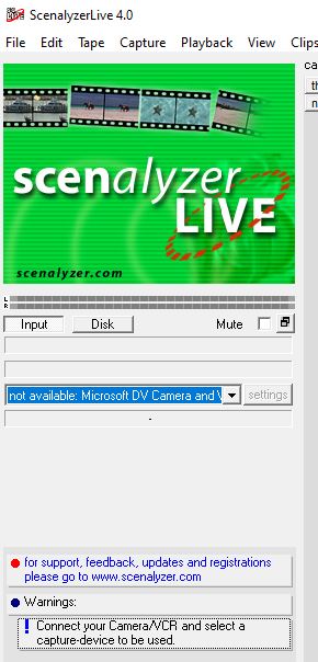

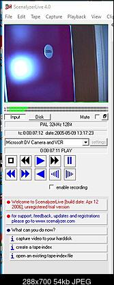

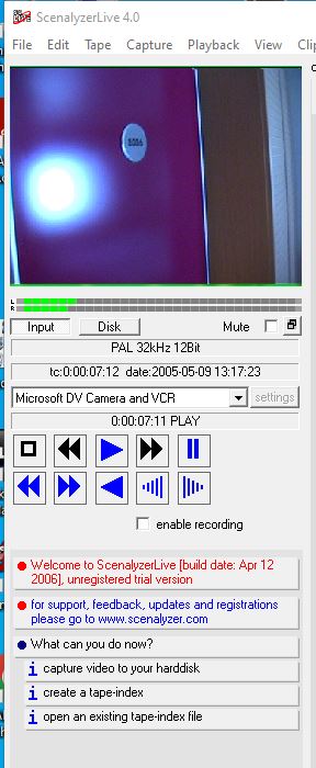

    The problem is all these programs can "see" firewire with sony camera but they cannot communicate with jvc minidv deck.
    I upload screenshots of sclive, with sony camera and jvc deck try.
    [ATTACH]Click image for larger version

    The firewire port is OK (alive but not kicking). I connect both camera and deck to the same pc via two firewire ports and when i play a videotape on the deck, the video is showing on the camera screen (clever ehhh?).

    Are there no other options in the ScLive dropdown? I have used a JVC Everio that came up as "JVCXXXX" instead of the normal "Microsoft DV Camera..."

    Unfortunately there is no other option in the drop down menu.
