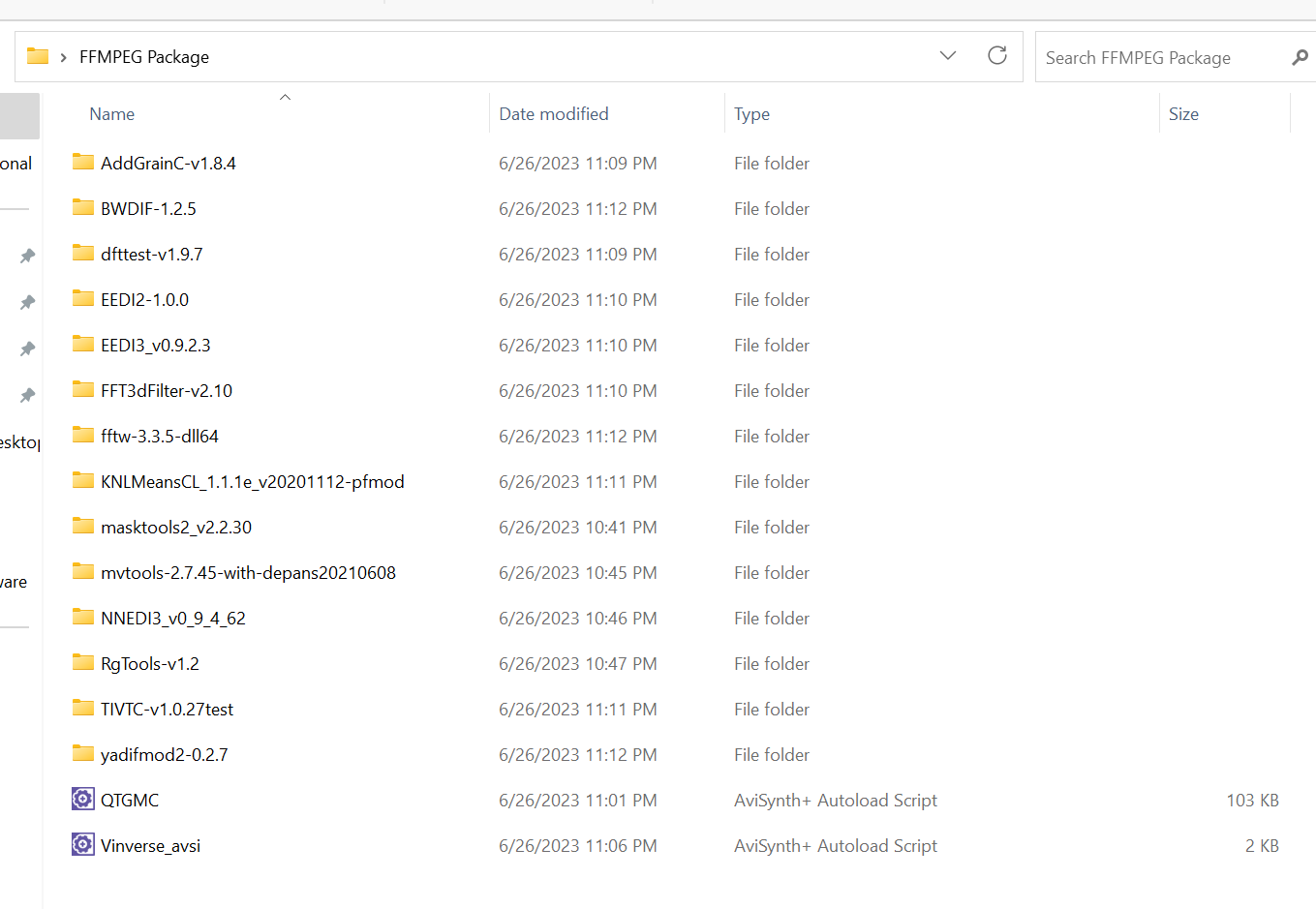

    Hello folks, So my son gave me his gaming desktop and I wiped out everything and did a fresh install and while at it I upgraded to Win 11 (probably a bad idea). Anyway, I want to make it strictly for capturing and encoding videos since it has some horse power. While I have two other computers running fine with QTGMC and AVISynth (Win 7 and 10) but since I have a fish memory I can't remember anything I've done before.
    So far I have downloaded AVISynth+ 64bit and QTGMC and all required files as seen in the screenshots, the text file ones I just dumped in notepad and changed the extension to .avsi, So what's next? In the wiki page of QTGMC says "Install AviSynth and copy the plugins from the plugin package to the correct locations" but it doesn't say what location is, Is it the plugins folder such as plugins64+ folder? I just want to get this right from the get go and avoid unnecessary error messages.
    This will most likely be a long thread with a lot of error messages so bear with me please.

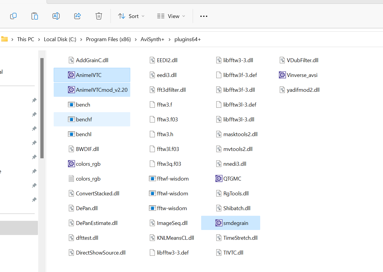

    The thing is I believe I was using 32bit files and non + versions, This system is going to be all 64bit+. But since you mentioned the folder I assume that's the folder I need to transfer to, I will get all the .dll files out of their folders and dump them into plugin64+ folder and see what happens.
    Jan 2016
    Ok, I've copied all the .dll files to the plugings64+ folder and added the missing ones from the old computer (the highlighted ones), I will install AVSPmod and see how it goes.

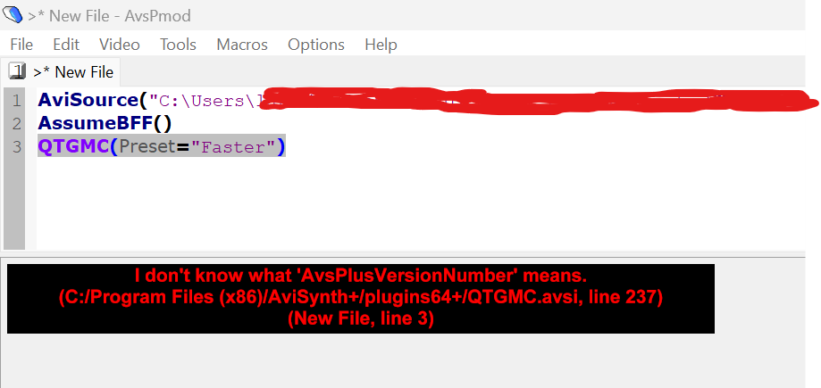

    Okay, in AVSPmod I'm getting this error with a simple QTGMC command, The file name is hidden for privacy purposes, Where the QTGMC app should be placed by the way?

    A quick Google indicates that function is part of SMDegrain. You copied it from your old computer, which you mentioned probably isn't the AVS+ version.
    https://htmlpreview.github.io/?https://github.com/Dogway/Avisynth-Scripts/blob/master/...SMDegrain.html
    My YouTube channel with little clips: vhs-decode, comparing TBC, etc.
    Jan 2016
    Okay I downloaded the SMDegrain from that link, saved it with the extension .avsi and put it in the same folder replacing the old one and the error message is still the same, Any idea? By the way SMDegrain is neither part of the required plugins for QTGMC nor the optional ones, I don't see why it should be a problem.
    Looking at line 237 in QTGMC text file it says:
            sisphbd = AvsPlusVersionNumber > 2294
    There is a step I haven't done from the QTGMC wiki because I have no clue what they are talking about, could it be the cause?
    Dfttest, FFT3DFilter and MVTools2 need the FFTW3 library (windows builds). On a 64-bit Windows OS, extract the 32-bit libfftw3f-3.dll. Make a copy of it and rename it as "FFTW3.dll". Place the files "libfftw3f-3.dll" and "FFTW3.dll" in the SysWow64 folder.
    If you want to use the 64-bit libfftw3f-3.dll versions then extract the 64-bit libfftw3f-3.dll. Make a copy of it and rename it as "FFTW3.dll". Place the files "libfftw3f-3.dll" and "FFTW3.dll" in the System32 folder.

    Get the FTTW library from here, as per the links on the QTGMC wiki).
    Just do exactly as the first paragraph says. For me, doing the second paragraph (even though I have a 64bit system) stopped error reports from the AVSInfotool (I'm not sure whether the second para is necessary for QTGMC to run).
    In the Syswow64 folder, the two files (from the 32bit FFTW; actually the same file renamed) are 2336kb.
    In the System32 folder, both files (from the 64bit FFTW zip) are 2708kb.

    I actually did the second paragraph but as of right now the error message I'm getting is in the QTGMC code in line 237, I'm looking for an old version of QTGMC and see how it goes.

    I don't know what 'AvsPlusVersionNumber' means.
    (C:\Program Files (x86)\AviSynth+\plugins64+\QTGMC.avsi, line 237)
    (C:\Users\ingvarrme\Desktop\Tape10_RAW_07_NEW.avs, line 7)

    No. AVISynth+ (v3.7.2) and QTGMC works without issue on Windows 11 as long as you use the latest files. Give me a couple of hours and I'll post images of the contents of my folders.

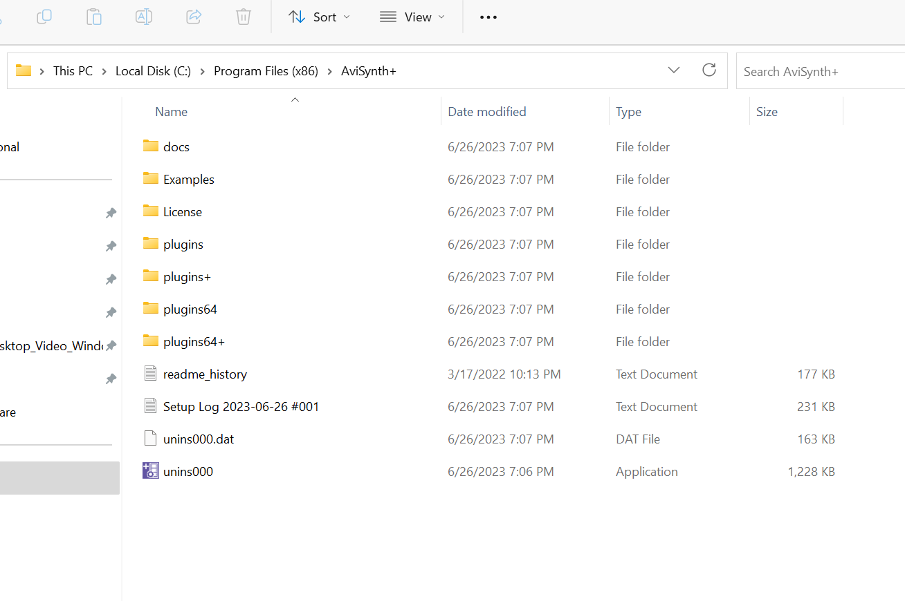

    Here you go! Hopefullly there are none of my secrets buried in there! There are a few extras that I have added after my initial install. AVISynth Plus also installed a non-plus folder in Program Files (x86) so I don't know if that has a bearing on anything.
    AVISynth Plus folder:
    https://drive.google.com/file/d/165z6h3-YNrNntlwK-gmrK5kXbQpfIN61/view?usp=sharing
    System32 FFTW files:
    https://drive.google.com/file/d/1r7mmFcEitCvJYV7y9Zjrvg0WImORlUN8/view?usp=sharing
    SysWow64 FFTW files:
    https://drive.google.com/file/d/1XhmSoZ6gGexsfaxcVb5rDq0xvY90l2KI/view?usp=sharing
    I found the AVISynthInfoTool handy for checking the installation.

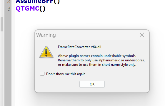

    I used only the QTGMC file from your package and it seems to have eliminated all QTGMC error codes, However I'm getting an error about frame rate conversion plugin, Since I don't use it so I'll just mute the error from appearing in the future. Thanks for the file.
