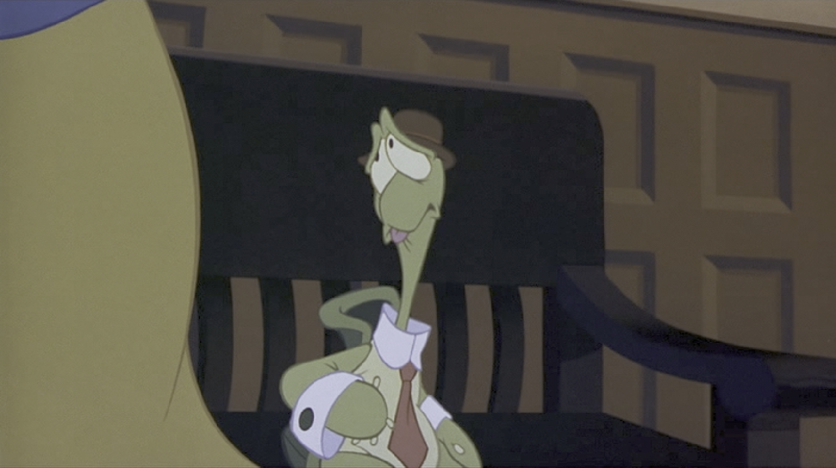

  1. I have an animation im cleaning up, and I have it looking good, but there are a few scenes with dark areas where there are some colored compression artifacts.
    I can remove the blocking easy enough, but I havent been able to remove the color.
    I adjusted the colors so its easier to see where I am talking about since its pretty subtle.
    Along the bench there is some green/yellow mixed in, its wrecking havoc once I clean everything up, gives the backboard a green hue.
    [Attachment 71989 - Click to enlarge]
    I have attached an example clip as well, im not sure if its possible to remove that, or lessen it?
    Edit: I should note, im using vapoursynth

  3. vsTTempSmooth does not really do the job for me.
    (checked by applying Retinex after the filtering)
    A masked CCD or DPIR, SCUNet, BasicVSR++, RealESRGAN and a bunch of other approaches work fine here: https://imgsli.com/MTg4MTIy
    Cu Selur

  5. Original = What I see when I load the file you posted.
    Retinex = What I see when I load the file you posted and apply Retinex. (to see the artifacts)
    XXXX = What I see when I load the file you posted and apply XXXX and then Retinex. (to see what XXXXX did)
    https://imgsli.com/MTg4MTIz/1/7
    -> no clue what you want to say with "That's too dark", since you didn't ask for color grading suggestions, but on how to remove these artifacts.
    Cu Selur
