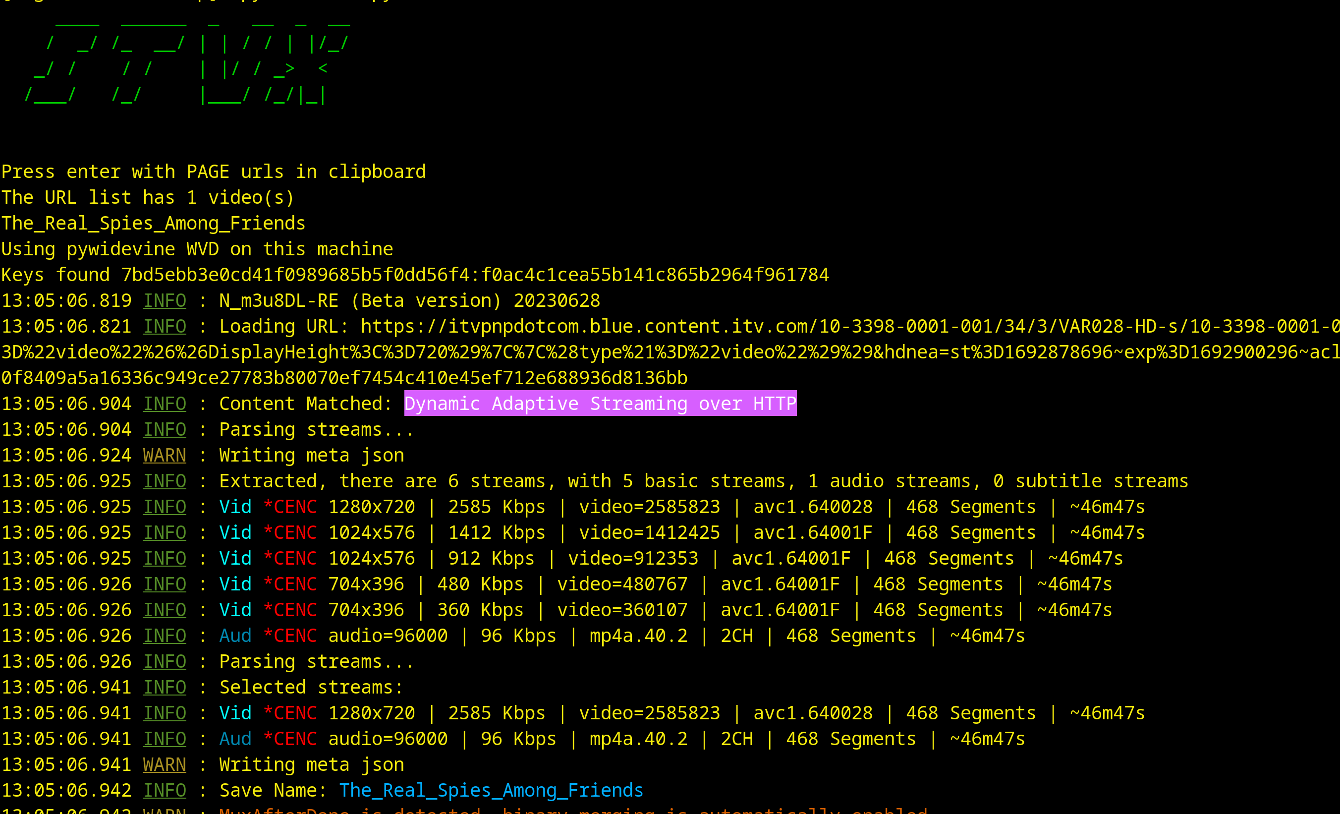

You appear to be feeding an mpd to the script? I should have connected the dots in your first post.
Use the page url - the script finds both mpd and license itself. And try using PowerShell - you'll get a better experience

Works for me. Error suggests you've got no response to a request. Are you needing to use a VPN or are you in the UK?
Ensure you have the latest script update at #1Last edited by A_n_g_e_l_a; 24th Aug 2023 at 08:25.
