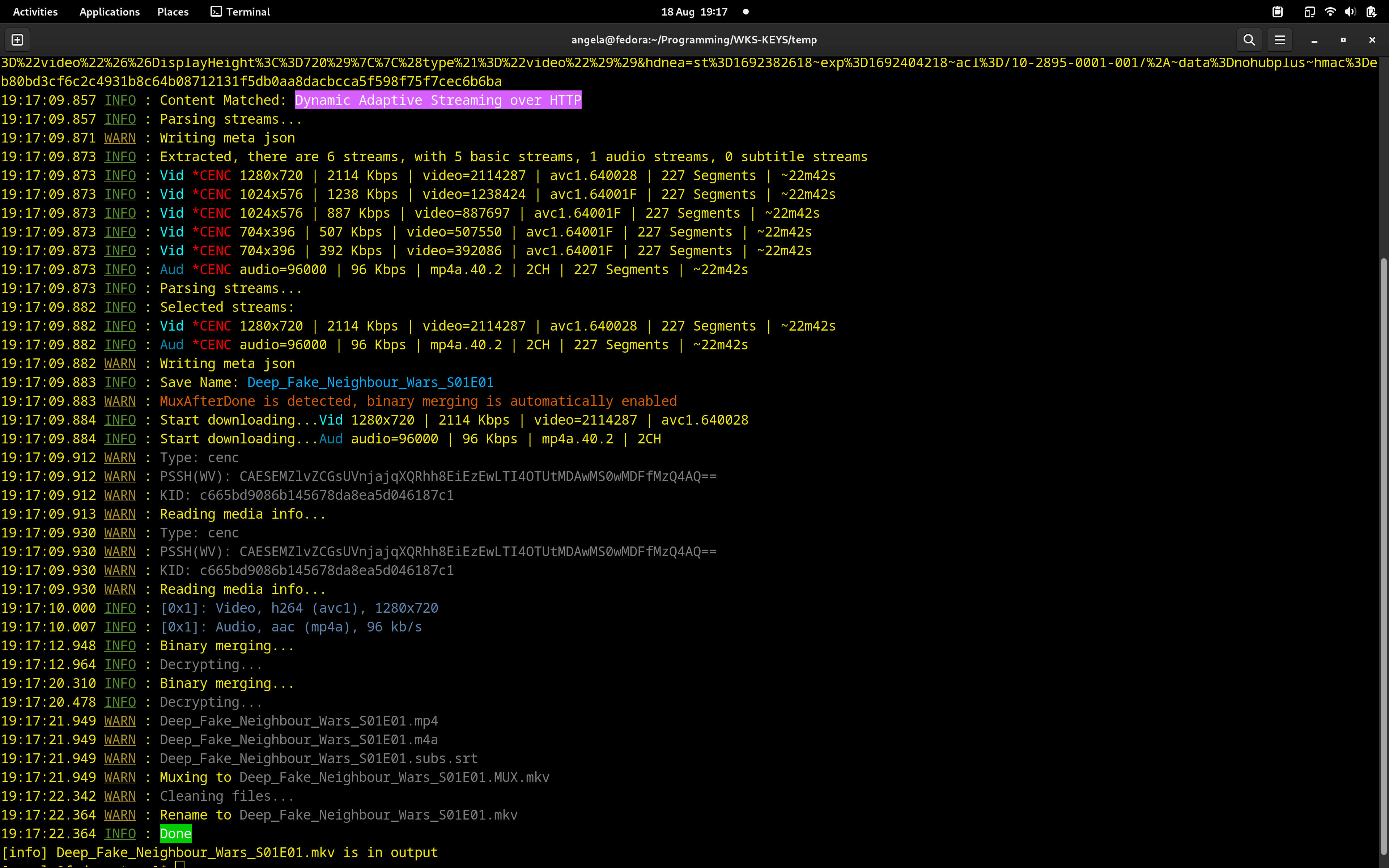

help... im getting this with this scrpt:
C:\Users\Dannyboi\Desktop\My WEB-DL Tools\ITVX (1080p)>python bestITVX.py
←[32m ____ ______ _ __ _ __
/ _/ /_ __/ | | / / | |/_/
_/ / / / | |/ / _> <
/___/ /_/ |___/ /_/|_|
←[0m
Press enter with PAGE urls in clipboard https://www.itv.com/watch/deep-fake-neighbour-wars/10a2895/10a2895a0001
The URL list has 1 video(s)
Deep_Fake_Neighbour_Wars_S01E01
File "C:\Users\Dannyboi\AppData\Local\Programs\Python\P ython39\lib\sre_parse.py", line 1051, in parse_template
this = chr(ESCAPES[this][1])
KeyError: '\\i'
During handling of the above exception, another exception occurred:
File "C:\Users\Dannyboi\AppData\Local\Programs\Python\P ython39\lib\runpy.py", line 197, in _run_module_as_main
return _run_code(code, main_globals, None,
File "C:\Users\Dannyboi\AppData\Local\Programs\Python\P ython39\lib\runpy.py", line 87, in _run_code
exec(code, run_globals)
File "C:\Users\Dannyboi\AppData\Roaming\Python\Python39 \site-packages\pysubs2\__main__.py", line 6, in <module>
rv = cli(sys.argv[1:])
File "C:\Users\Dannyboi\AppData\Roaming\Python\Python39 \site-packages\pysubs2\cli.py", line 100, in __call__
self.main(argv)
File "C:\Users\Dannyboi\AppData\Roaming\Python\Python39 \site-packages\pysubs2\cli.py", line 124, in main
subs = SSAFile.from_file(infile, args.input_format, args.fps)
File "C:\Users\Dannyboi\AppData\Roaming\Python\Python39 \site-packages\pysubs2\ssafile.py", line 152, in from_file
impl.from_file(subs, fp, format_, fps=fps, **kwargs)
File "C:\Users\Dannyboi\AppData\Roaming\Python\Python39 \site-packages\pysubs2\subrip.py", line 61, in from_file
subs.events = [SSAEvent(start=start, end=end, text=prepare_text(lines))
File "C:\Users\Dannyboi\AppData\Roaming\Python\Python39 \site-packages\pysubs2\subrip.py", line 61, in <listcomp>
File "C:\Users\Dannyboi\AppData\Roaming\Python\Python39 \site-packages\pysubs2\subrip.py", line 51, in prepare_text
s = re.sub(r"< *i *>", r"{\i1}", s)
File "C:\Users\Dannyboi\AppData\Local\Programs\Python\P ython39\lib\re.py", line 210, in sub
return _compile(pattern, flags).sub(repl, string, count)
File "C:\Users\Dannyboi\AppData\Local\Programs\Python\P ython39\lib\re.py", line 327, in _subx
template = _compile_repl(template, pattern)
File "C:\Users\Dannyboi\AppData\Local\Programs\Python\P ython39\lib\re.py", line 318, in _compile_repl
return sre_parse.parse_template(repl, pattern)
File "C:\Users\Dannyboi\AppData\Local\Programs\Python\P ython39\lib\sre_parse.py", line 1054, in parse_template
raise s.error('bad escape %s' % this, len(this))
re.error: bad escape \i at position 1
Using a remote CDM
Keys found c665bd9086b145678da8ea5d046187c1:24377799b9f60b9b3 575f6cb8a5b397d
path empty or file not exists!
Description:

[info] Deep_Fake_Neighbour_Wars_S01E01.mkv is in output
C:\Users\Dannyboi\Desktop\My WEB-DL Tools\ITVX (1080p)>pause
Press any key to continue . . . -
[Attachment 73267 - Click to enlarge]
Works fine. Still posting acres of rubbish Danny? -
