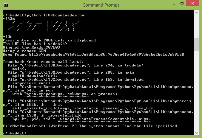

    I am trying to download this using the script in the first post but I had to comment out the following lines as i was getting the error "ModuleNotFoundError: No module named 'pywidevine.L3"
    #from pywidevine.L3.cdm import deviceconfig
    #from pywidevine.L3.decrypt.wvdecryptcustom import WvDecrypt
    When I use the url as captured by the Streamdetector
    https://www.itv.com/watch/king-of-the-roads/2a5089/2a5089a0062
    I get the following shown in the CMD window
    [Attachment 72810 - Click to enlarge]
    Can anyone help me out as I have no clue.

    Originally Posted by PhilipG View Post
    The solutions posted by others have not worked for me (or, more likely, I haven't properly understood the instructions). But the above is simple enough for me to do every time it's needed.
    Thank you but none of that is relevant to the this issue if you read the error message.
    The issue is that installing pywidevine (needed for the c4 script) somehow mucks up the WKS-KEYS install. That much is clear to me.
    It can't find pywidevine/L3? Well, installing pywidevine did not change the folder structure one jot. It's still there as a path relative to the script. __init__.py is still inside L3. I put a copy of __init__.py in the pywidevine folder and that made no difference. Does installing pywidevine stop it looking through relative paths for imports? No idea, my Python is extremely basic.
    The best solution would be for someone to update either the c4 script to make it use WKS_KEYS, or the other scripts to use the .wvd generated from the L3 keys. But that someone is not going to be me while the quick workaround is available!
    Philip, you misunderstand. Bernard's issue has nothing to do with WKS-KEYS vs pywidewine believe me.
    And for your information for the future Pythons's pywidevine plays very nicely with WKS-KEYS if you just recompile wv_proto2_pb2 to suit version 4 protobuf. There are instructions elsewhere in the forum. I understand you have currently chosen not to follow them.

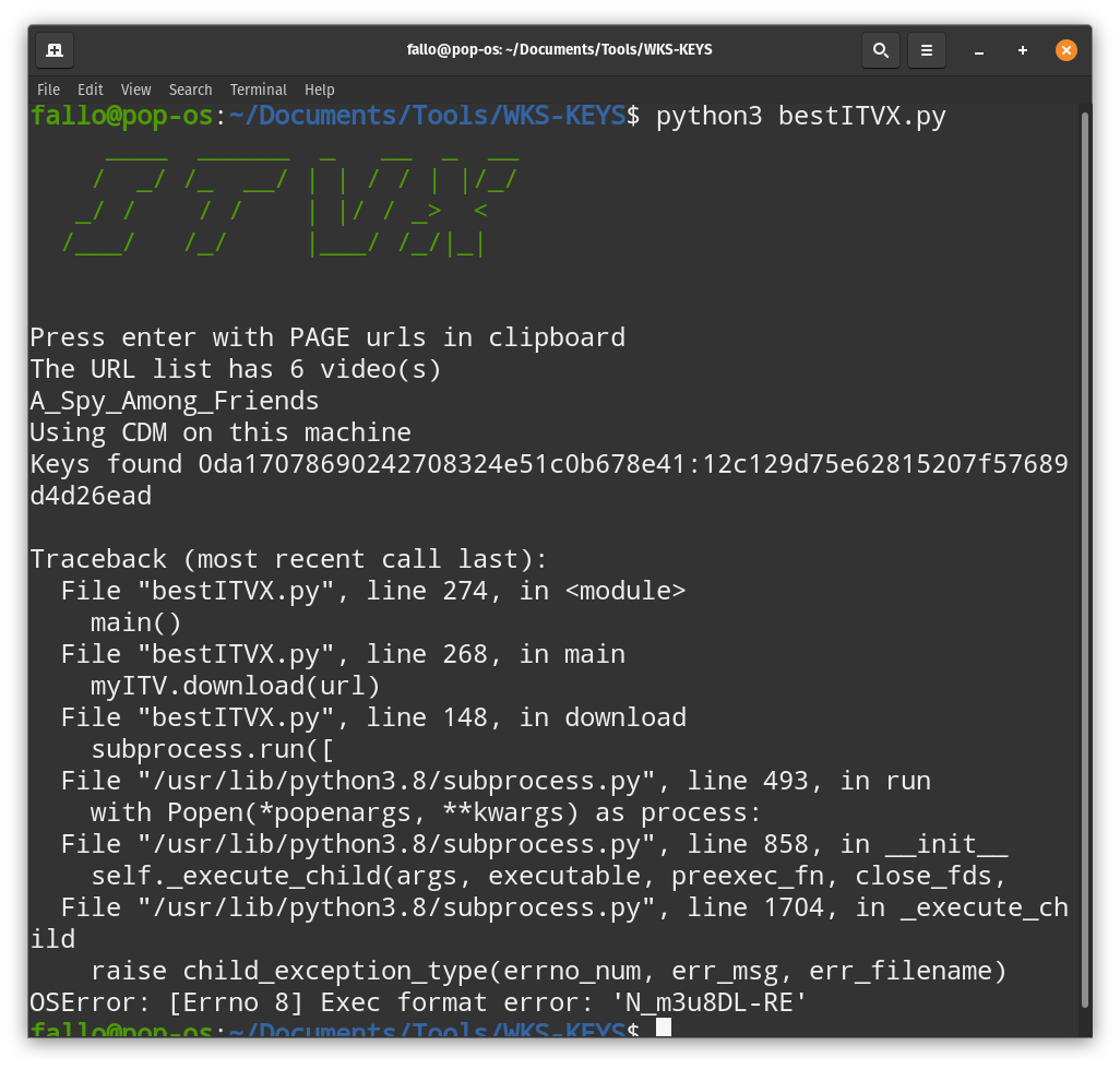

  7. I am having this error. Any ideas/help will be welcome. Thanks. It gives me the same error with both my cdm or the remote one.

    Feb 2022
    Search the forum first!
    Are you using the address bar URLs?

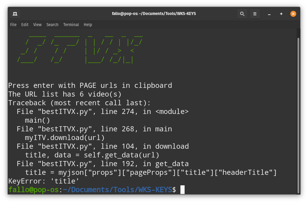

  9. ITV have changed their JSON structure, so you get KeyError: "title" because it doesn't exist. The script needs to be edited to match the new structure.

    Agree ITVX have made a change to some json code format.
    [edit]
    Corrected code at post 1
    [/edit]
    Last edited by A_n_g_e_l_a; 3rd Aug 2023 at 03:45. Reason: point to post 1 correction not inline editing

  13. Originally Posted by A_n_g_e_l_a View Post
    Edit two lines
    line 193 to look like this
    title = myjson["props"]["pageProps"]["programme"]["title"]
    line 194 to look like this
    magni_url = myjson["props"]["pageProps"]["seriesList"][0]["titles"][0]["playlistUrl"]
    Take care to keep code indentatiion lined up.

    Originally Posted by Fallito View Post
    Now is resolving to this:
    [Attachment 72860 - Click to enlarge]
    Have you got N_m3u8DL-RE installed as a binary file? Is it in your PATH? Is it in the same folder as as the script?
    That's your problem - Windows user!!
    Have you got N_m3u8DL-RE installed as a binary file? Is it in your PATH? Is it in the same folder as as the script? if it is rename N_m3u8DL-RE in the script to have .exe at the end.
    pop-os is a linux distro
    Didn't see it.
    Can't have got N_m3u8DL-RE installed then? All the same I don't want to sort out problems with people's systems. that has nothing to do with me.

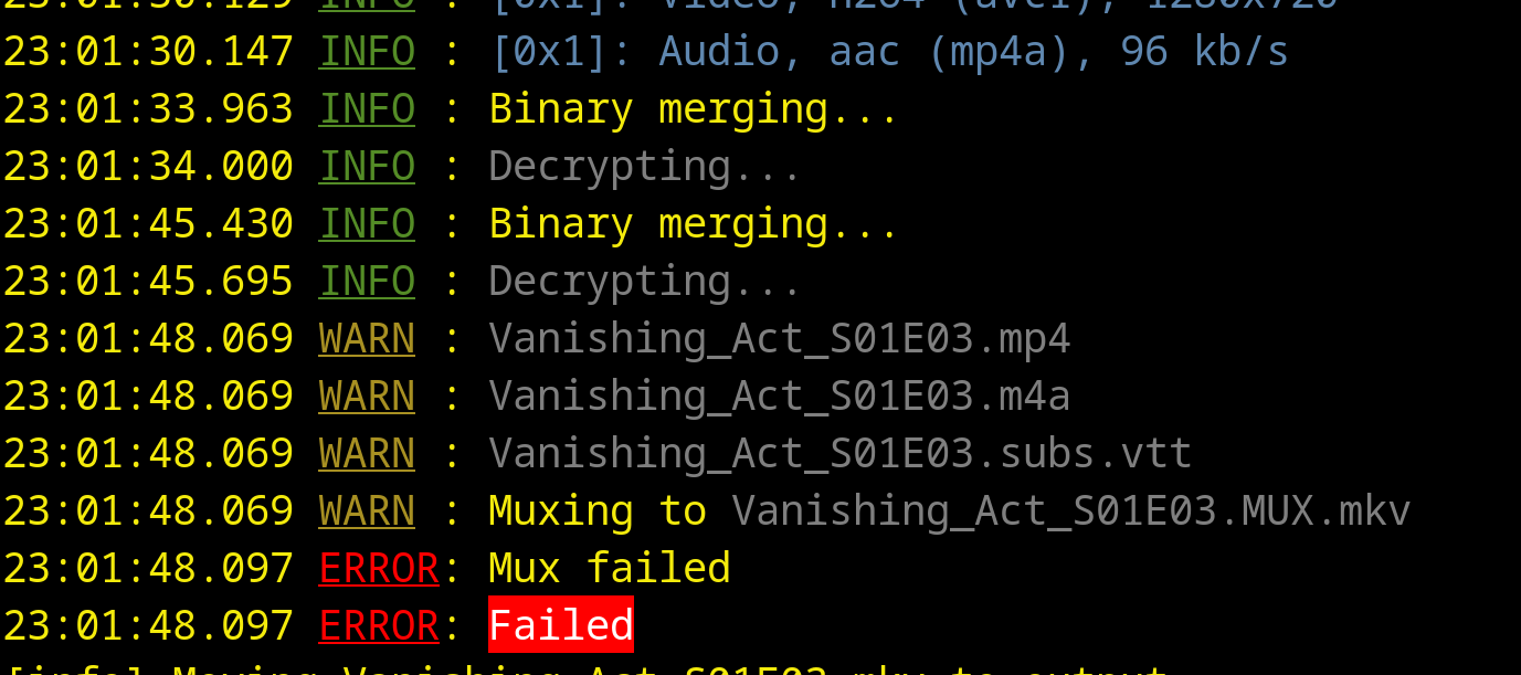

  24. A small piece of advice regarding subtitles is to write it to file and then use "--mux-import" in N_m3u8DL-RE to mux it with the video. No extra steps or libraries needed and works regardless of platform.
    This is what I've been doing in my own scripts and it works great.

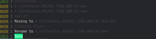

  27. I use it specifically with VTT files from ITV and it works great:
    [Attachment 72893 - Click to enlarge]
    Code snippet I use:
    if subtitle != "":
            r = requests.get(url=f"{subtitle}", headers=HEADERS)
            with open(f"sub.vtt", "wb") as f:
                f.write(r.content)
    And then
    "path=sub.vtt:lang=eng:name='English'"
