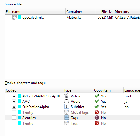

  12. I was able to input the original video and the upscaled video (the one with issues) into the program. I selected the video stream of the upscaled one, and everything else from the original, and the result is without issues i.e an upscaled video without the audio issues. Is this what you wanted me to try?
    I also noticed something that might be relevant.
    [Attachment 71981 - Click to enlarge]
    The upscaled video (produced by merging frames with ffmpeg) has more files than the original.

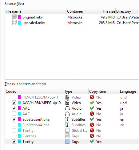

  13. Update: I tried using mkvmerge to remove the extra files I mentioned earlier from the upscaled video. And it worked wonderfully without audio issues.
    [Attachment 72052 - Click to enlarge]
    So if I can get ffmpeg to not generate those "tags" thing, my problem should be solved.
