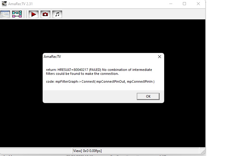

    I'm just getting this now:
    [Attachment 71933 - Click to enlarge]

    For VirtualDub the recommended version is 1.9.11, for AmarecTV is 3.1.0

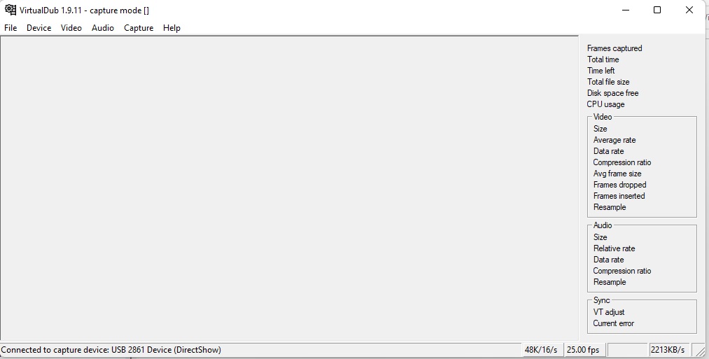

    Downloaded 1.9.11 but still doesn't work
    This is all I am getting. Why was it working yesterday but not now?.

    I downloaded a version of Debut Video thinking this would not work either and it detected my capture device. Why VDub isn't I don't know. On my Toshiba laptop Debut video wouldn't work, initially it did for a while (a long time ago) but suddenly it wouldn't detect the capture device. Gotta be an issue with my capture device or drivers.

    Well vdub2 is a little different to the original vdub - the menus etc., for example, are not the same so we, at the very least, need to know hat program you use else we are all 'barking up the wrong tree'.
    Whilst a 64 bit OS can run a 32 bit program I am not so sure with codecs. I have used Amarectv3.10 with my own 64 bit OS I would guess that the codec is also 64 bit. And the same goes with vdub/vdub2. The 64 bit version did not see the 32 bit codec originally installled whereas the 32 bit version did.
    But dare I say it. If you have been screwing around with versions/codecs and expect all still to work then they will not.
  12. Originally Posted by DB83 View Post

    But the codecs doesn't explain why I am not getting any a signal. It seems to detect the device but nothing else happens.
