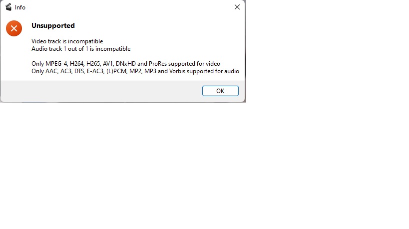

    It will import into Avidemux but won't remux the files. Remuxing as an avi it remuxes but there is an reverb/echo effect to the audio, no idea why as the original file's audio is ok. Remuxing as an mp4 it says:-
    "Unsupported: Video track is incompatible. Audio track 1 of 1 is incompatible.
    Only MPEG-1/2/3/4, h.264, h.265 and AVI supported for video
    Only AC3, AAC, DTS, E-AC3, MP3, MP2 and Vobis supported for audio

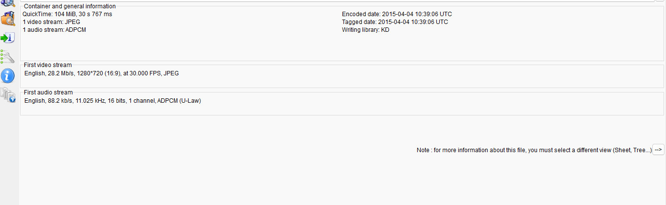

  7. Originally Posted by DB83 View Post
    Install mediainfo >> right-click on video in explorer and select mediainfo >> View Menu/Text and copy/paste to here.
    I won't remux in Avidemux.
    Mediainfo:
    [Attachment 71903 - Click to enlarge]
Name:	Mediainfo screenshot.jpg

  10. Member DB83's Avatar
    Jul 2007
    Well that info is minimal. Had you bothered to read the instructions you would select view (menu) >> text etc.
    But jpeg is not a valid video source. There is mjpeg but I for one need to see a more expanded report.
  11. Originally Posted by Alwyn View Post
    I think he's trying, as indicated in post #3 and #7.
    @Techmot, open it in Avidemux, leave video and audio on "Copy" and set the Output Format to MOV Muxer. Select a small portion of the video on the timeline with the A and B buttons, then Save As. Hopefully that will get a small non-recoded video portion for the others to play around with.
    Avidemux won't let me do that, won't save as MOV even when I have trimmed the clip on the timeline.
    Screenshot:
    [Attachment 71917 - Click to enlarge]
