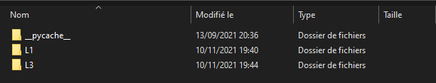

  3. It's same, and directory is correct
    Feb 2022
    Search the forum first!
    What? You have an L3 folder in the path from pywidewine? You are running the python code inside the WKS-KEYS folder? Idiot question, I know.

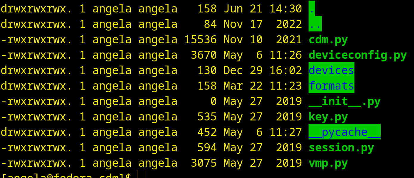

    What does compressed mean in this context? What comes after L3?
    My path is WKS-KEYS/pywidevine/L3/cdm
    inside which is:
    [Attachment 71886 - Click to enlarge]
    It is important you have __init__.py as an empty file. (Don't worry about not having __pycache__)
    Feb 2022
    Got it! Your are missing a double underscore init double underscore.py or __init__.py after pywideviine, i.e. inside the folder where L3 is.
    __init__.py tells python that there may be modules of code inside the folder or the next level folder down.
    So make sure that in each folder to the python module __init__.py exists.
