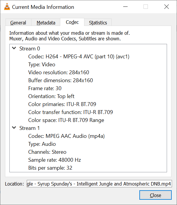

    On a VOD of a >*5 hrs stream there were some technical issues resulting in silences, which I estimate their average approaching 5 mins. I'd like for the audio to be extracted as well as significantly reducing the duration of silences. Silences don't need to be completely cropped out, reducing them > 3/4 is sufficient, I mention this as if there's a way to remove audio "blocks" while leaving the remaining original audio the same would be amazing, with no decompressing nor compressing ; it the silences beginnings & ends are detected and only the "blocks" completely fitting in the silences are removed. My system is Windows 10 but Cygwin is installed on it, thus has access to come *NIX features, although often lagging 1-2 versions (from the current one). See the attached screenshot as well as the quote below for information about the video.

    General
    Complete name : [PATH]\[4-23-23] Catch22 - Pretty Jungle - Syrup Spunday's - Intelligent Jungle and Atmospheric DNB.mp4
    Format : MPEG-4
    Format profile : Base Media
    Codec ID : isom (isom/iso2/avc1/mp41)
    File size : 713 MiB
    Duration : 5 h 24 min
    Overall bit rate : 307 kb/s
    Frame rate : 30.000 FPS
    Movie name : Pretty Jungle - Syrup Spunday's - Intelligent Jungle and Atmospheric DNB (1801534574)
    Performer : Catch22
    Recorded date : 2023
    Writing application : Lavf60.3.100
    Comment : Originally aired: 2023-04-23 14:58:57Z / Video id: 1801534574
    Video
    Format : AVC
    Format profile : Main@L1.2
    Format settings : CABAC / 2 Ref Frames
    Format settings, CABAC : Yes
    Format settings, Reference frames : 2 frames
    Format settings, GOP : M=1, N=60
    Codec ID : avc1
    Source duration : 5 h 24 min
    Bit rate mode : Constant
    Bit rate : 180 kb/s
    Width : 284 pixels
    Height : 160 pixels
    Display aspect ratio : 16:9
    Frame rate mode : Variable
    Minimum frame rate : 29.412 FPS
    Maximum frame rate : 31.250 FPS
    Color space : YUV
    Chroma subsampling : 4:2:0
    Bit depth : 8 bits
    Scan type : Progressive
    Bits/(Pixel*Frame) : 0.132
    Stream size : 419 MiB (59%)
    Source stream size : 419 MiB (59%)
    Color range : Limited
    Color primaries : BT.709
    Transfer characteristics : BT.709
    Matrix coefficients : BT.709
    Codec configuration box : avcC
    Audio
    Format : AAC LC
    Format/Info : Advanced Audio Codec Low Complexity
    Codec ID : mp4a-40-2
    Bit rate mode : Variable
    Bit rate : 119 kb/s
    Maximum bit rate : 128 kb/s
    Channel(s) : 2 channels
    Channel layout : L R
    Sampling rate : 48.0 kHz
    Frame rate : 46.875 FPS (1024 SPF)
    Compression mode : Lossy
    Stream size : 276 MiB (39%)
    Source stream size : 276 MiB (39%)
    Default : Yes
    Alternate group : 1
Name:	4-23-23_Catch22-Pretty_Jungle-Syrup_Spunday's-Intelligent_Jungle_and_Atmospheric_DNB.mp4-codec.png

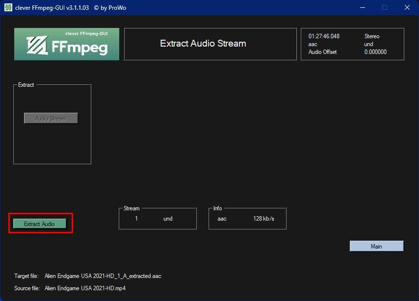

  5. Originally Posted by DynVec View Post
    After--extracting--I'll delete the original.
    You can use clever FFmpeg-GUI for extracting.
    [Attachment 71878 - Click to enlarge]
