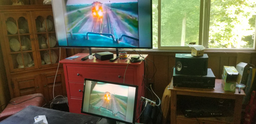

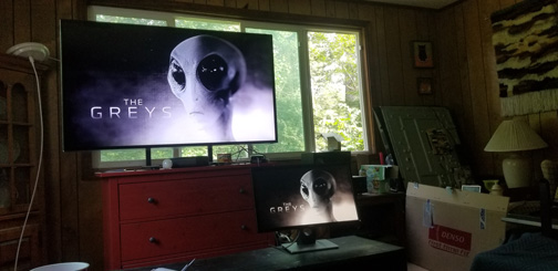

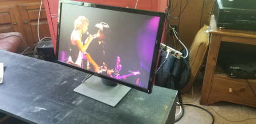

    IT WORKED!!!! I bought an HDMI splitter on Amazon said it worked with Roku, probably they all do. I have a 60in Samsung smart LED TV I picked up on Craigslist for free. The only issue with the TV is one of the LED diffusers fell off, which it's in a place if you notice this at first you soon forget when you are watching the TV. Also the speakers are blown makes a distortion / vibrating sound when low tones, so I got a SPDIF DAC and play the audio through my sound system, the fiber optic cable they sent with the device did not work bought another cable. So the HDMI spliter does have one issue it does not play HD videos from youtube that i have downloaded and put on a thumb drive plugged into the Roku though it will play on the monitor...strange? The same video will play on the TV if the Roku is connected direct to the TV. Could it be the cable I used to go from the splitter to the TV? maybe a cheapo HDMI cable? all in all I am pleased. The HDMI splitter says it's 4K, so shouldn't it be able to do HD? Next step getting the video into a desktop. any ideas? i know they have HDMI to usb, do they come with capture software, how does that work?
    shows only on the monitor, TV says can't display HD video from youtube copied to thumb drive inserted into the Roku
    [Attachment 72068 - Click to enlarge]
    regular video from Youtube
    [Attachment 72069 - Click to enlarge]
    all the TV shows are ok and that is why I want this
    [Attachment 72070 - Click to enlarge]

    Your test proves nothing with respect to recording the output from your Roku with a PC capture device. HDCP is a form of copy protection. Capture devices are not permitted to record HDMI signals that are HDCP-protected and HDMI capture devices from Hauppauge, Avermedia, Black Magic, Magewell, and other well-known brands obey that rule. Some (but not all) cheap Chinese capture devices are reported to record HDCP-protected HDMI signals but I can't give you a recommendation for one since I haven't tested any.
    Any HDMI splitter should work in your test if its outgoing HDMI ports are connected to two displays, as long as both displays support HDCP and the video source device (the Roku) as well as both destination displays (the TV and the monitor) all support a common resolution and refresh rate. If one of the displays doesn't support the resolution and frame refresh rate of the video being sent to it by the Roku, that display won't show a picture.
