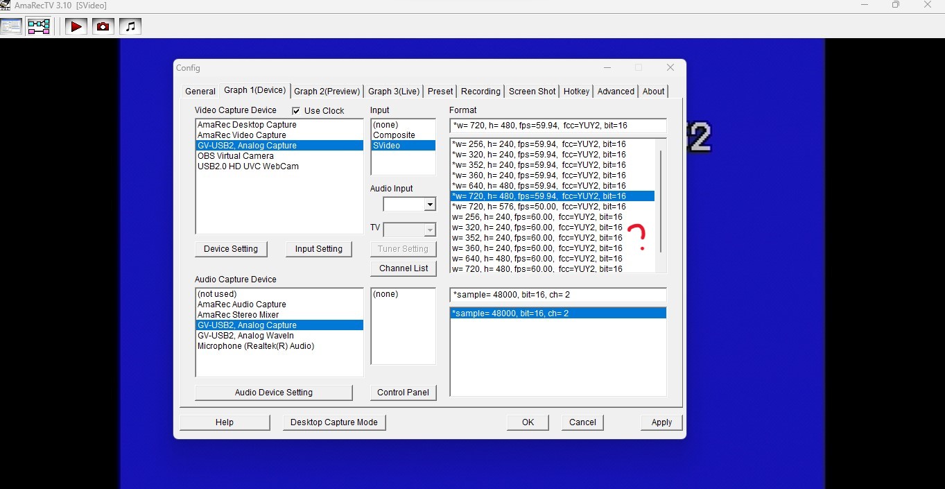

    Appreciate all of your responses. I captured using AmarecTV and this is the setting. I didn't see 29.97 fps listed so I chose 59.94 fps. Now I have two questions, why is 29.97 not listed in the settings and why the de-interlacing wouldn't work if I cap using 59.94?

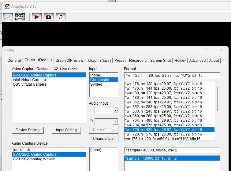

  14. Originally Posted by lovethisnation View Post

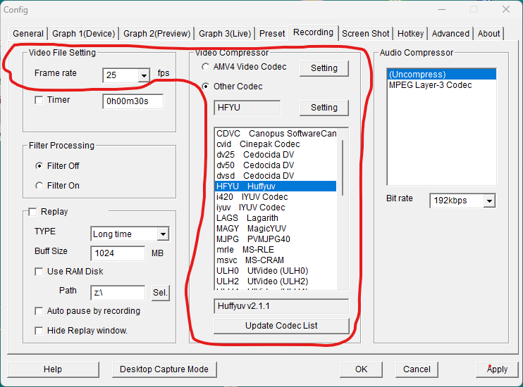

    Go to the 'Recording' tab and select the codec there. Also, set the Frame rate there. Configure the codec by pressing the Setting button. Don't capture to RGB, use a YUV 4:2:2 format instead. The settings details depend on the used codec.
    Just selecting 59.94 fps doesn't necessarily mean that a deinterlacer kicks in. It may simply repeat frames.
    Also, double-check the 'Device Setting' in the 'Graph 1(Device)' tab.

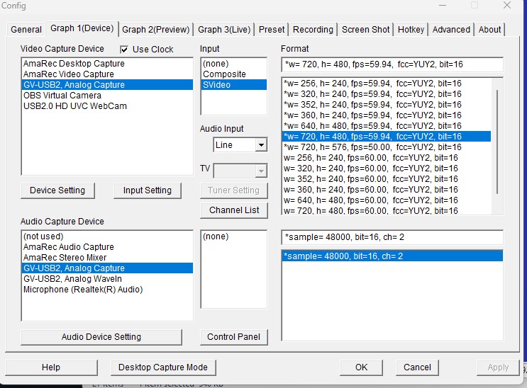

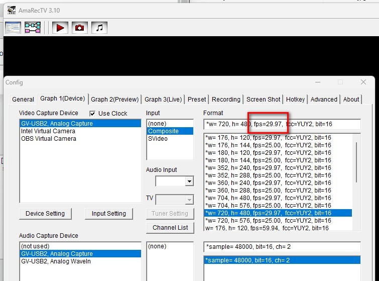

    The framerate setting is on the Graph1(Device) tab:
    [Attachment 71882 - Click to enlarge]
    The Recording tab framerate should be set to 999 so the frame rate set on the Device tab is the one used (so Lollo says! )

  16. I'm still scratching my head over my settings. I am not showing the same settings that you guys are telling me to select. Here are the settings it shows for my capture device GV-USB2. fps 29.97 does not show on the list (see screenshot). Perhaps I don't have the correct driver installed?
    Device Tab
    Input: S-Video
    Format: *w= 720, h= 480, fps=59.94, fcc=YUY2, bit=16 (because I don't have *w= 720, h= 480, fps=29.97, fcc=YUY2, bit=16 on the list)
    Device Setting:
    2.S-Video
    Deinterlace: Weave (Off)
    Video Decoder: Video standard: NTSC_M
    Recording Tab
    codec: LAGS, Mode YUY2
    Video File Setting: 999 FPS

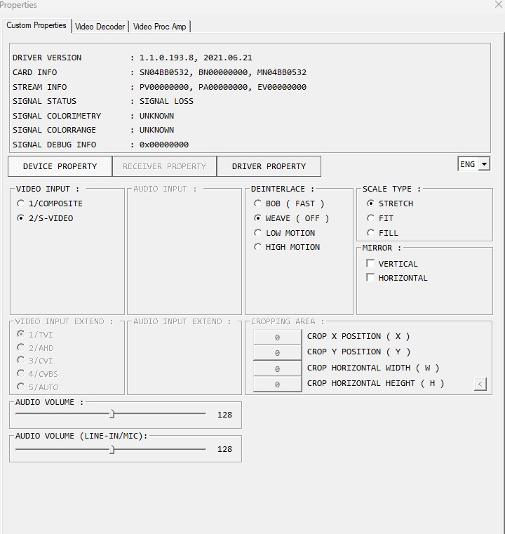

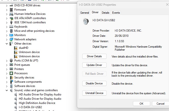

    That's weird! Here's my setup:
    AmarecTV:
    Graph1(device) tab> Device Settings button (note driver details at bottom):
    [Attachment 71891 - Click to enlarge]
    Graph2(Preview) tab:
    [Attachment 71892 - Click to enlarge]
    Windows Device Manager:
    [Attachment 71893 - Click to enlarge]
    My GV-USB2 driver came from here:
    https://iotku.pw/gvusb2-guide/
    Install the driver before before inserting the stick.
    I am now wondering... try typing 29.97 in the frame rate box on the Recording tab.

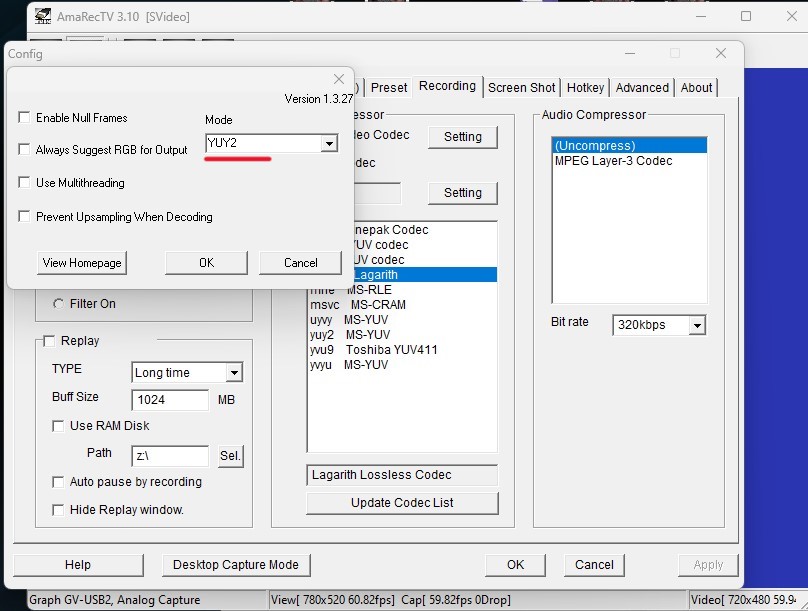

    I noticed you have an extra 2 entries "desktop capture" and "video capture" in the Video Capture device area. Not sure if they are causing the issue.
    I suggest you reset Amarec back to defaults: in it's folder, delete the AmaRecTV.ini file and have another go. My full setup guide for AmarecTV is on my website.

    You'll be getting sick of me posting. I'd never tried it before, but it appears you can manually set the framerate to 29.97 in the text field at the top of the Device tab. Change the framerate from 59.94 to 29.97 and see what capture you get.
    [Attachment 71894 - Click to enlarge]

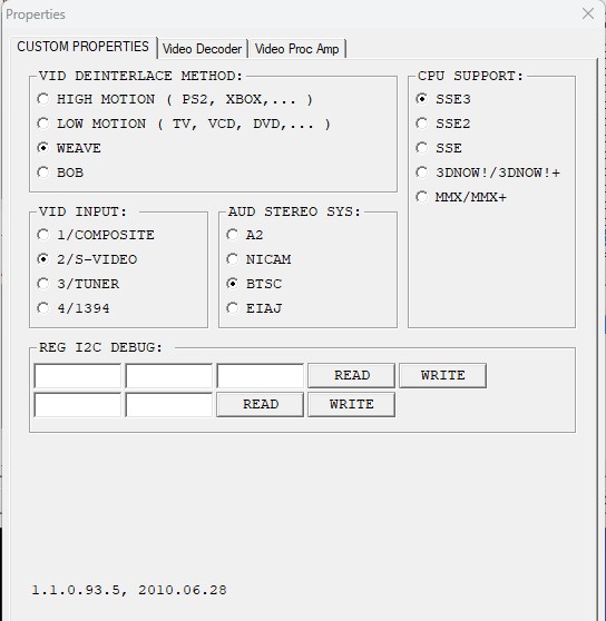

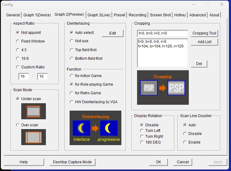

  20. Note Alwyn's first image in post 17, Device Settings dialog from the Graph 1(device) tab:
    It shows deinterlace method set to WEAVE. If you have it set to BOB try changing it to weave. That may enable all the 29.97 fps rates in the Graph 1(device) tab.

    I definitely have another version of the same software installed because mine doesn't look like that. See photo.
    . I did that but that didn't seem to fix the issue, it keeps capturing at 59.94
    That's where I grabbed mine. The driver I downloaded from the same page and it's the latest version. I have a Windows 10, 64 bit machine. I had to enter the SN on the website to download and it installed.
    I might want to just try to capture in VDub2 and ignore AmarecTV, but I'm perplexed.

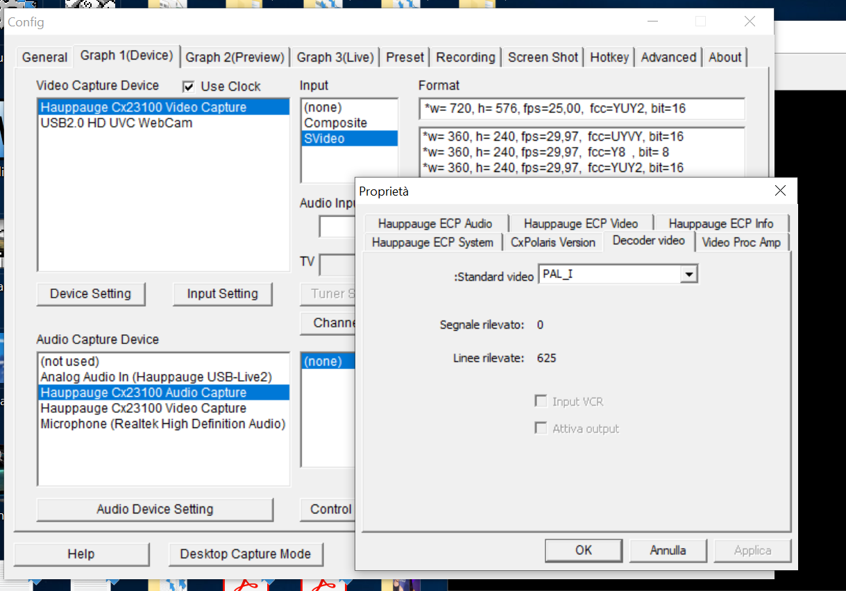

  23. Captures & Restoration lollo's Avatar
    Jul 2018
    Italy
    and does not pretend to know more about your footage than you are. What's up with "Low motion" and "High motion" BS? What is stretch/fill/fit? Does it always use deinterlacer? Eh.
    Neither does AmarecTV. That setting is intrisic to I/OData GV-USB2.
    This is the same device setting for another card, Hauppauge USB-Live 2.
    [Attachment 71896 - Click to enlarge]
    Do not comment on something you do not know.
