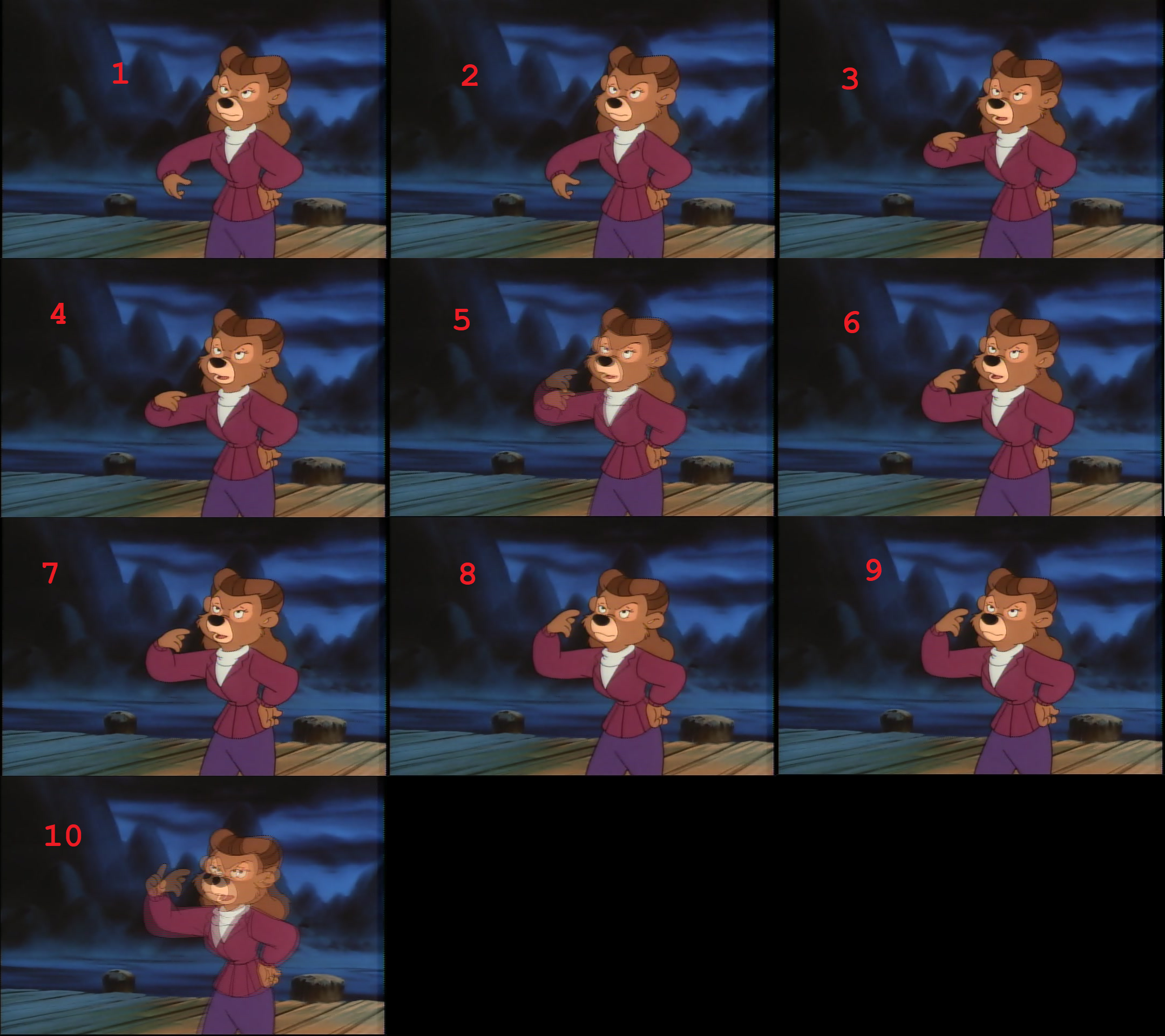

  1. So I'm new to this whole inverse telecine thing, but I read and got to the point where my output is 23.976024fps.
    This is from a DVD cartoon. The pattern is that every 5th frame had the distortion from the telecine conversion to TV:
    [Attachment 71840 - Click to enlarge]
    Here's the m2v:

  2. I suggest you upload a long medium speed panning shot. It's much easier to tell what the frame rate should be.

  5. Yes, that shot is fine. It's standard 3:2 pulldown so your
    tfm()
    TDecimate(Mode=0, Cycle=5, CycleR=1, Denoise=true)
    should work fine.
