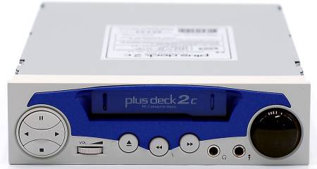

    Originally Posted by netmask56 View Post
    Thank you for the suggestion. It is a good solution.
    This product has been discontinued as far as I can see.
