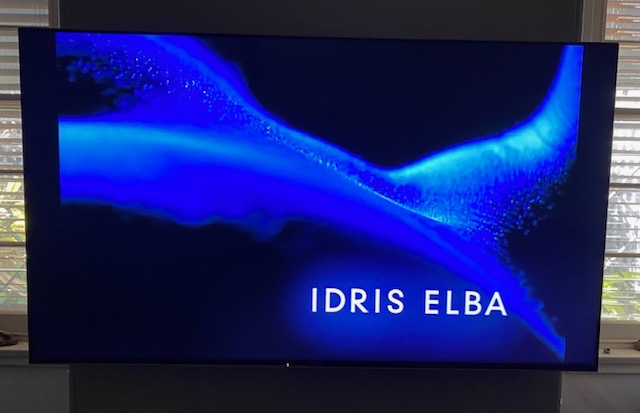

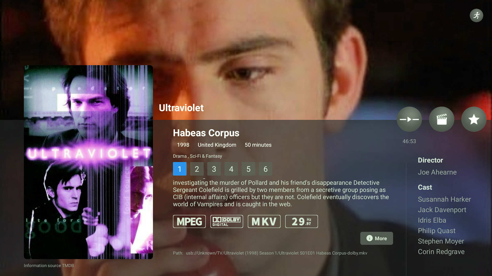

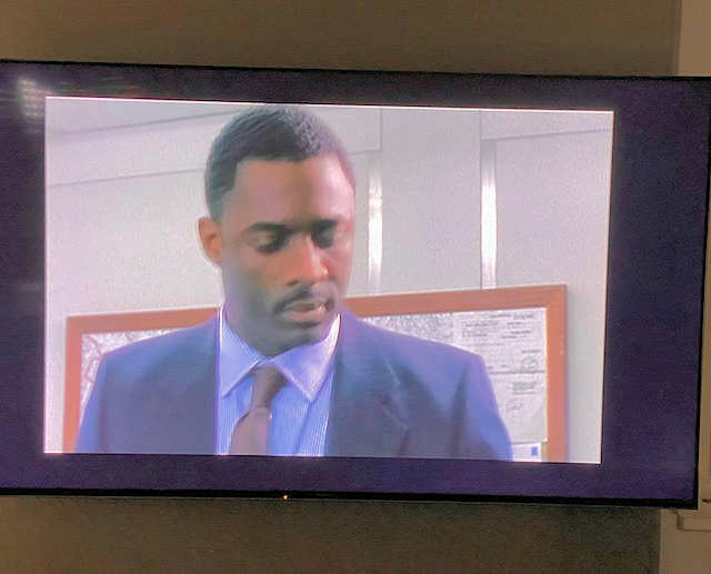

    I was given the 2 disc DVD boxed set of the British TV series from 1998 Ultraviolet, an interesting take on the vampire mythology. I used Makemkv to produce the 6 episodes as MKV files. Loaded them into my NAS and Zidoo Home Theatre duly found all the details. Well and good. When I played them they were all effectively letterboxed with a wide black bar either side and a narrow one top and bottom. I suspect the aspect ratio was 1.66:1 ?
    Anyway any suggestions as to how I can enlarge the image so that it fills the screen vertically but maintaining correct aspect ratio laterally. This will mean the left right black bars will almost go. So no clipping of any lateral image.
    This is the first time MakeMKV has done this in my experience - as the original discs hail from 1998 my guess is the authoring didn't take into account 16:9 flat screen TV's
    1.66:1 aspect ratio was widely used in Europe at one time as was 14:9
    Attached is a screen shot and note I've messed with the contrast as the TV is against a dark wall, so as to define where the TV ends and the wall takes over, so not my camera or TV settings!!!

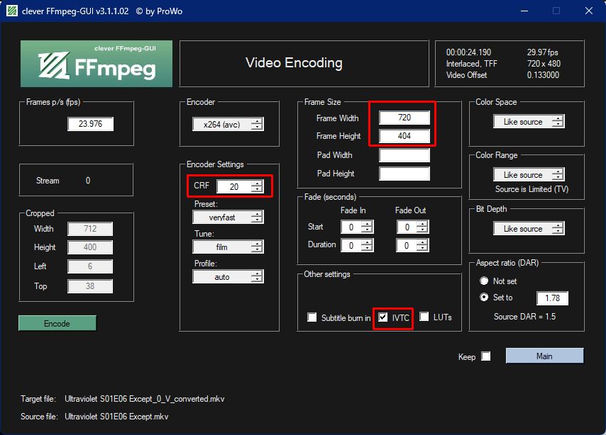

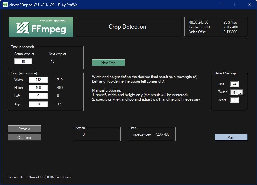

    I'll show you one way with clever FFMpeg-GUI.
    Load your mkv, click main, click encode video stream, click crop detect, check the result with preview and confirm it with OK, done.
    [Attachment 71825 - Click to enlarge]
    In the next window click on IVTC (inverse telecine). This brings the video back from 29.97 fps to 23.976 fps. The video will also be deinterlaced.
    Resize to 720x404 (which is 16:9), set CRF to 20 and click encode.
    [Attachment 71826 - Click to enlarge]
    When that is done, click multiplex, the selection should fit, click multiplex.
    [Attachment 71827 - Click to enlarge]
    You will find your new video in the output folder.

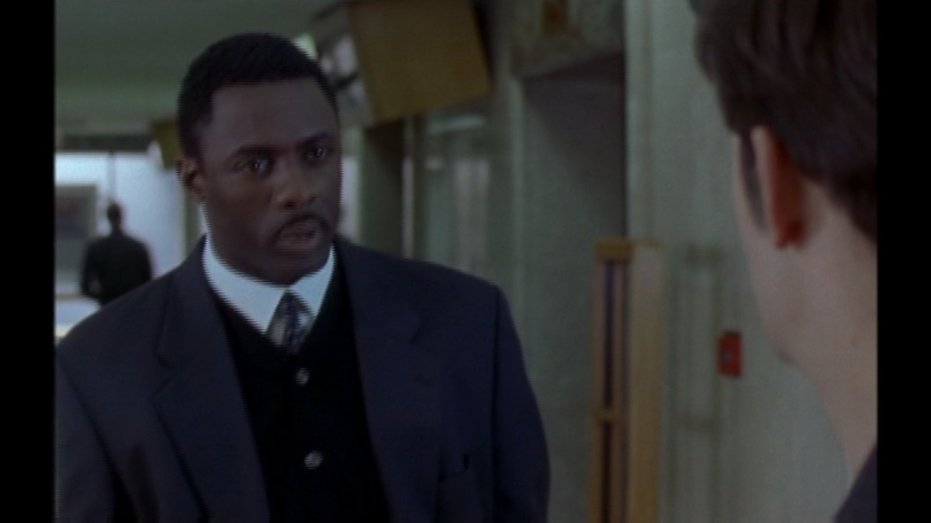

    Those heads are too wide, Prowo.
    The original 4:3 video looks right.

  12. Originally Posted by Alwyn View Post
    Nope, then the two are too thin.
    But from an original DVD source should come either 4:3 or 16:9, nothing else.
    Therefore, the source is not processed correctly.
    Attached a 1.5 DAR.

    Based on the snippet, it did come as 4:3 because of the hardcoded letterboxing (on the DVD or put on by MakeMKV?). That's why it doesn't look like it's displaying full screen, top-bottom, on the TV.
    With the hard-coded letterbox bars, it's 4:3 and with them cropped off, it's ~1.58:1. There will still be pillarbox bars on the TV:
